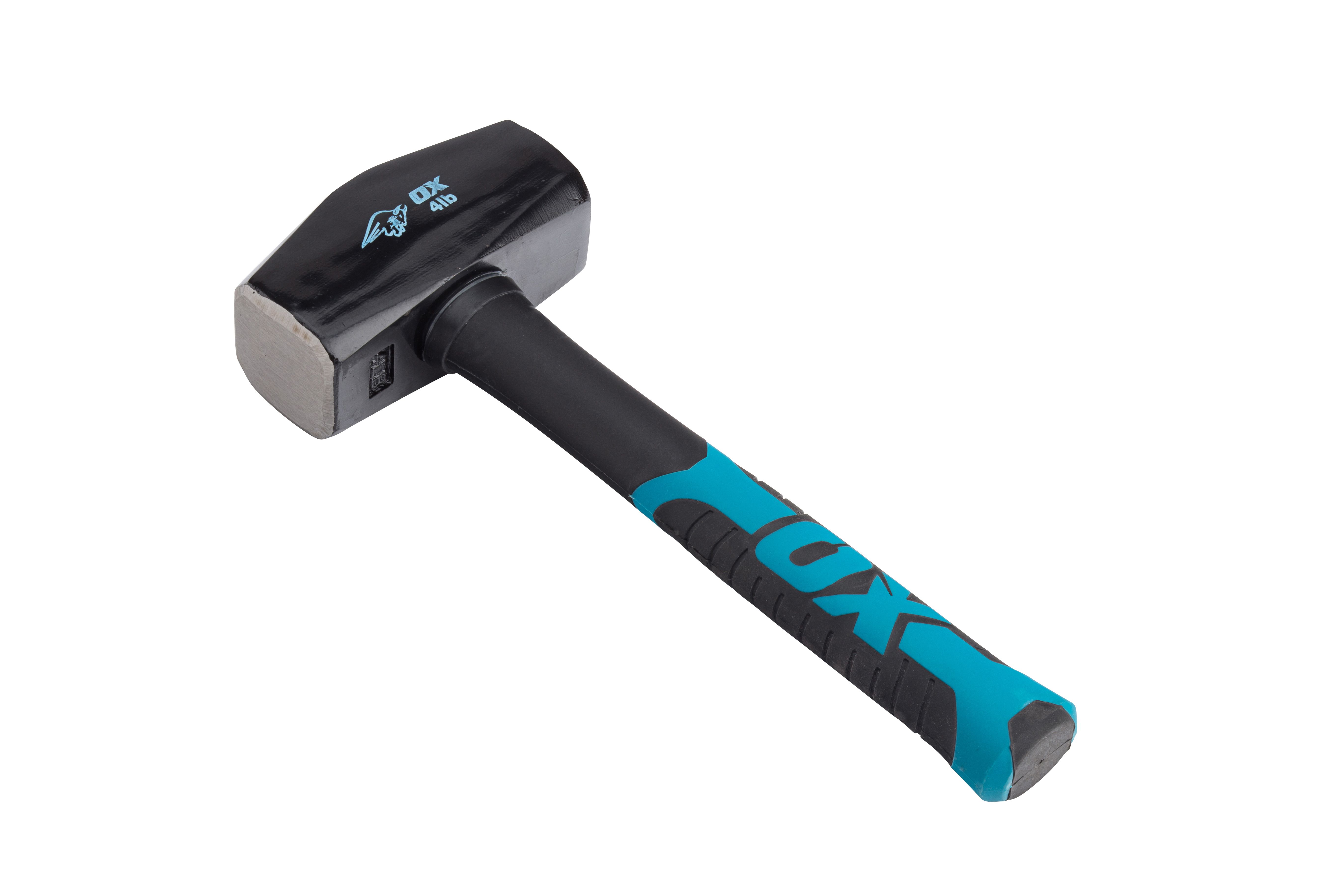

On the subject of hammers, I prefer to use a 4lb hammer with a short handle for this kind of work.
You let the weight of the hammer do the work, as such you can be accurate and precise with your hits, much better than taking wild, inaccurate swings with a bloody pissy little flower arranger’s hammer.
