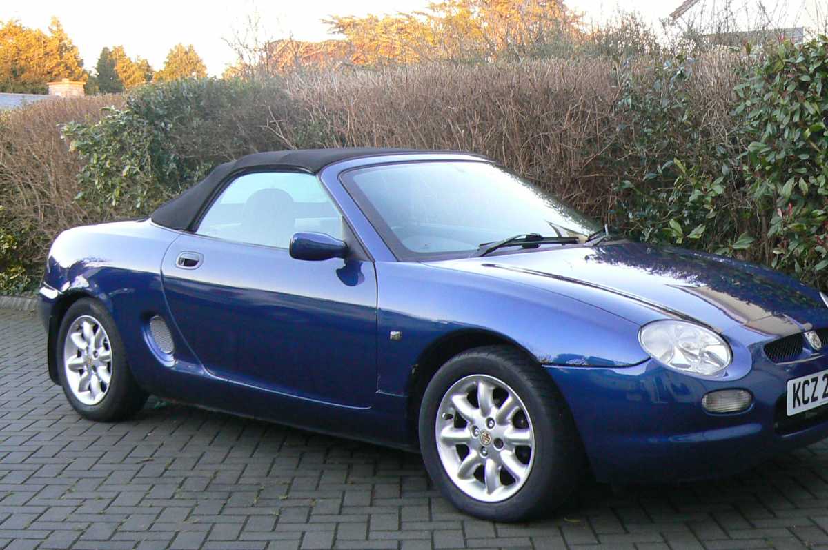

So this is it - the MG F spring project - code name Riveria - Why ? Well since the F is now sitting on the drive in sunny Devon on the English Riveria then it seemed a reasonable code word - Pretty sure that at some time most people's have taken a trip down to Torbay- see there has been an organsied run down here - see pic as a reminder

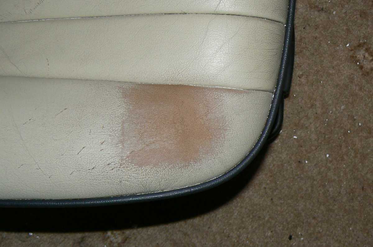

Thanks - Managed to start work, all be it mostly in doors - sun didnt last long down here ... cleaned the seats down in readiness for the dye but in doing so exposed a couple of areas which had obviously been touched up before as I now have two large patches of bear leather showing. :(

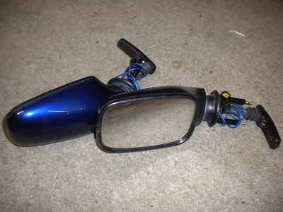

Fitted the mirrors and the intake vent grills, they look a lot better now especially the grills - nice and shinny bling !!.

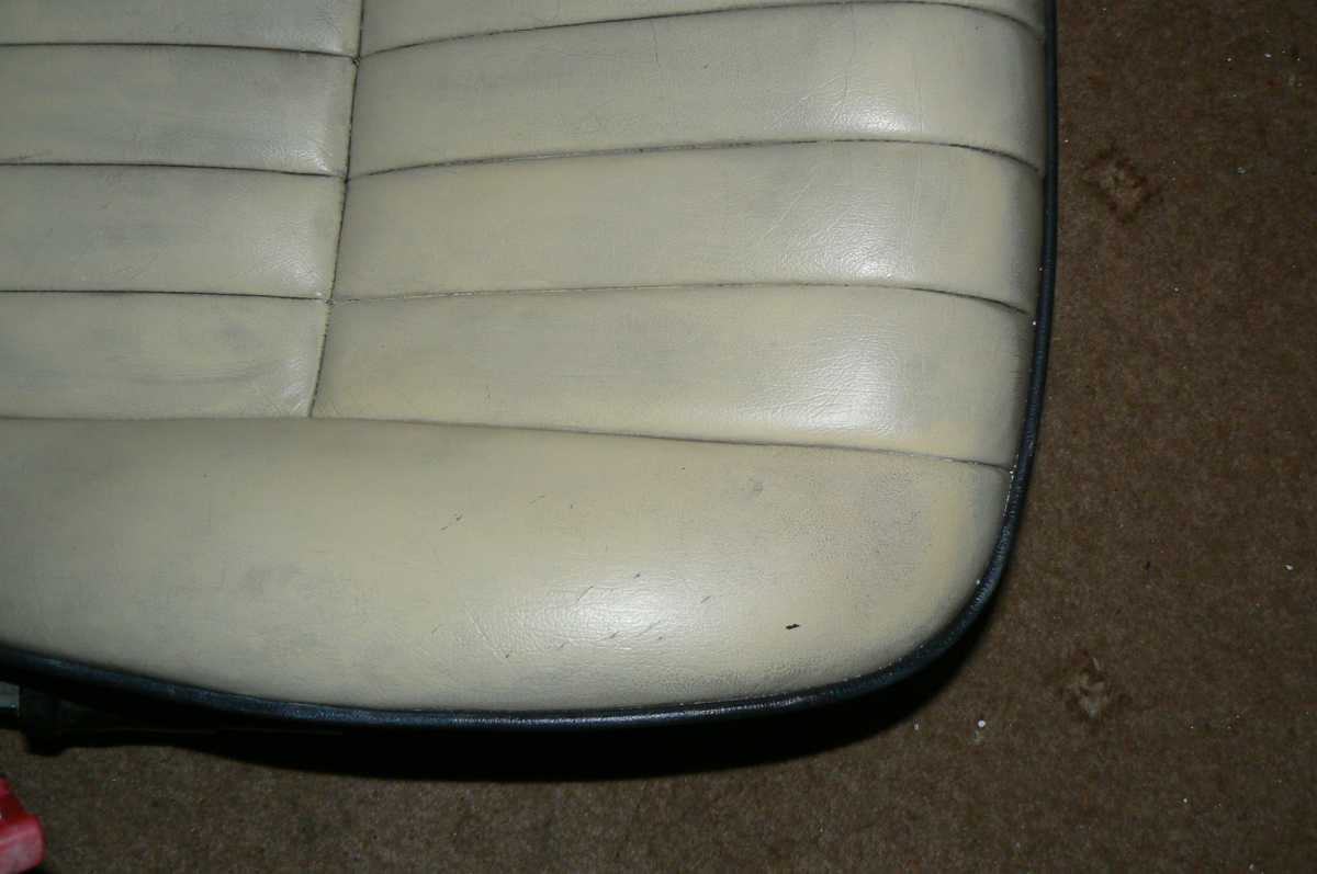

Also here is a before and after shot of the seats with the leather dye treatment, there is a colour difference so will now have to get cream colour balm to even it out - another £12 but will (hopefully) make it look an even finish and I can then fit them

Leather balm arrived and I have had a go at trying to blend in the colours, to be honest it has not made a great deal of difference so a bit disappointing, but it is better than the bear patches, so come a bit drier weather I will get the seats put in.

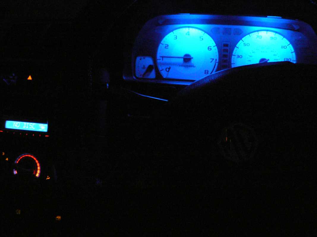

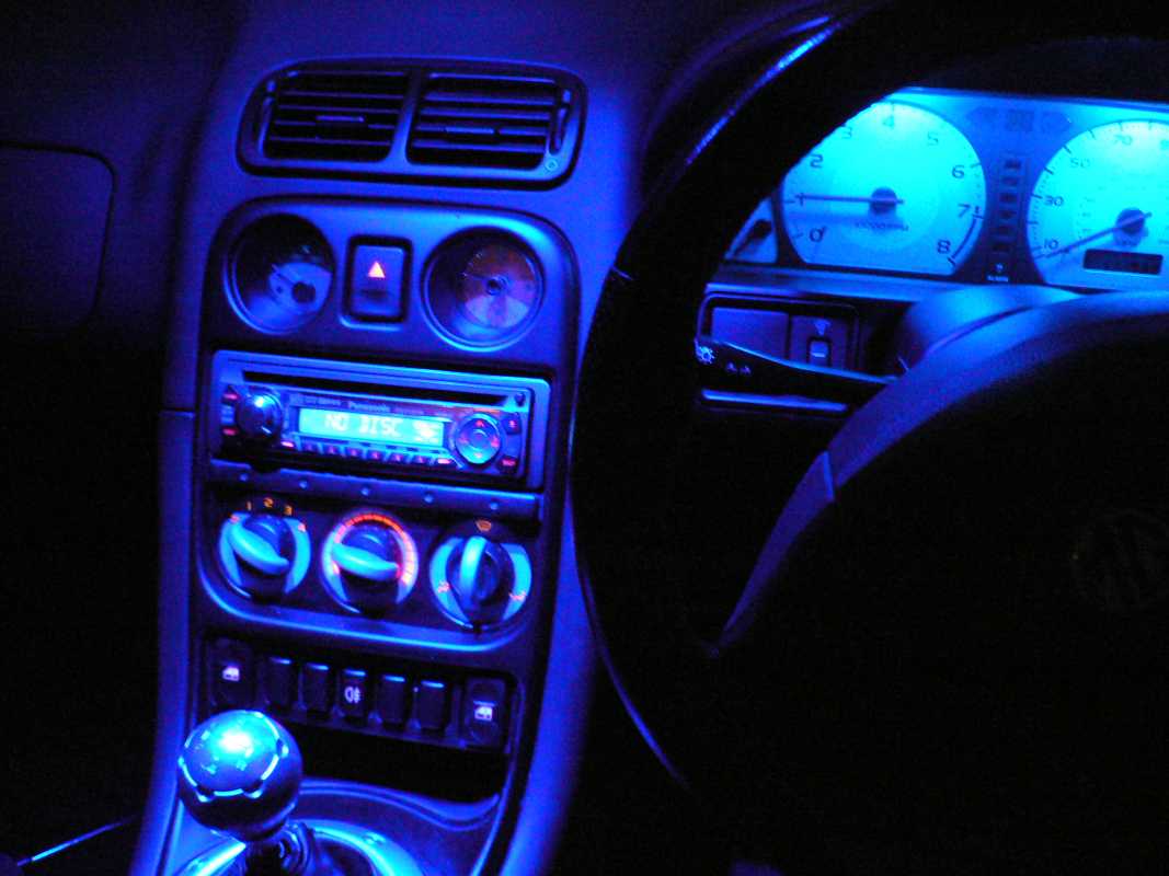

In the mean time have had a go at getting the instrument pack and the clock and oil gauges out to fit the blue leds - the how to (a car called bob) on tf central site was really useful, got it out without having to take the steering wheel off without too much fuss. Have also taken the yellow plastic defuser away which sits bellow the bulb housing, which does make a big diffenece in brightness :broon: - will take a pic when its darker and post .
With interior lights on -
And just dash lights
