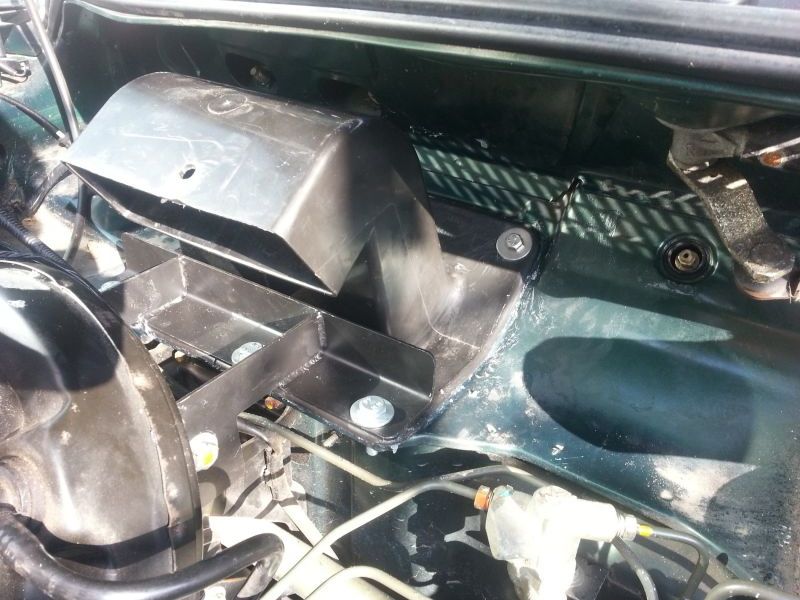

Replied by mgfmania on topic Brake Servo Flex Fix
Posted 10 years 3 months ago #166776
Alan Crossley (www.ac-me.co.uk) deleloped a bracket for me as most on the market were flexible 2mm steel. You can read how successfully it works at: http://mgfmania.com/the-history-of-mgf-mania/ - its Alan who's fitting the brakes to my MGF http://i591.photobucket.com/albums/ss357/MGFMania/Servobracketfitted_zpscc4d488d.jpg

Replied by The driving dutchman on topic Brake Servo Flex Fix
Posted 10 years 3 months ago #166782
Typical that you have a one legged version. I bought mine from a guy on another mg forum who made a bunch of em and it's a two legged version so it symmetrical in it's resistent force.
I think it was on MGFregister but i'm not sure.
Note it's a LHD

Replied by cjj on topic Brake Servo Flex Fix
Posted 10 years 3 months ago #166902
The driving dutchman wrote: Typical that you have a one legged version. I bought mine from a guy on another mg forum who made a bunch of em and it's a two legged version so it symmetrical in it's resistent force.
Note it's a LHD
I made mine to rectify my specific flexing which just needed the one arm. I think Jaylad added the other arm to be more universal.
Not sure if all flexing was the same as mine.
