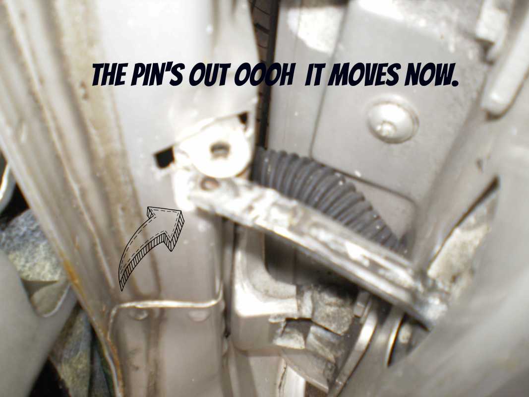

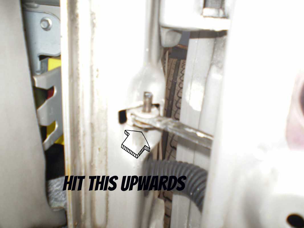

Then take the internal hinge off by hitting it with a punch or waggling some pliers on it. You're aiming to pull it up and out.

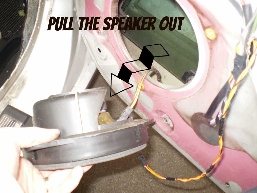

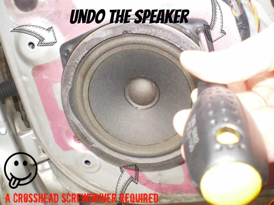

Next time to take the speaker out. There's three cross head screws.

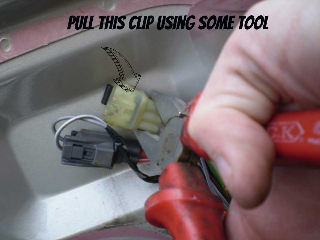

Then unclip the wire holder from its holder with a screw driver or pliers.. WARNING don't get giddy or you could break something.

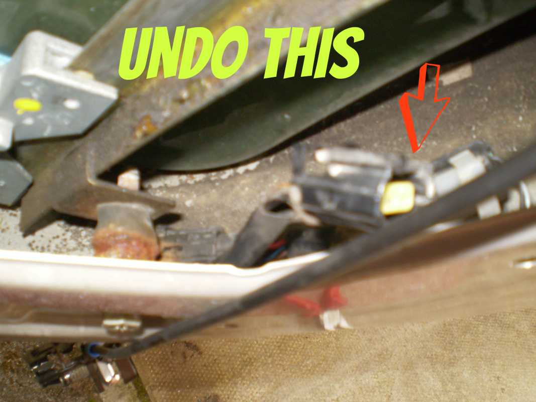

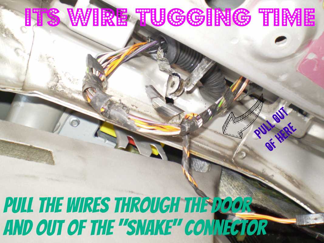

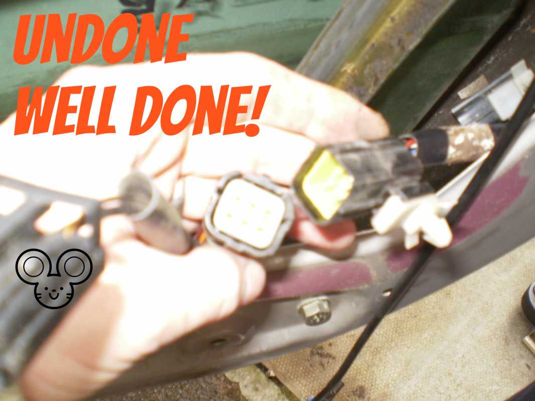

Next theres a lot of wires in the bottom of the doors for the window mech. Be careful and unclip them.

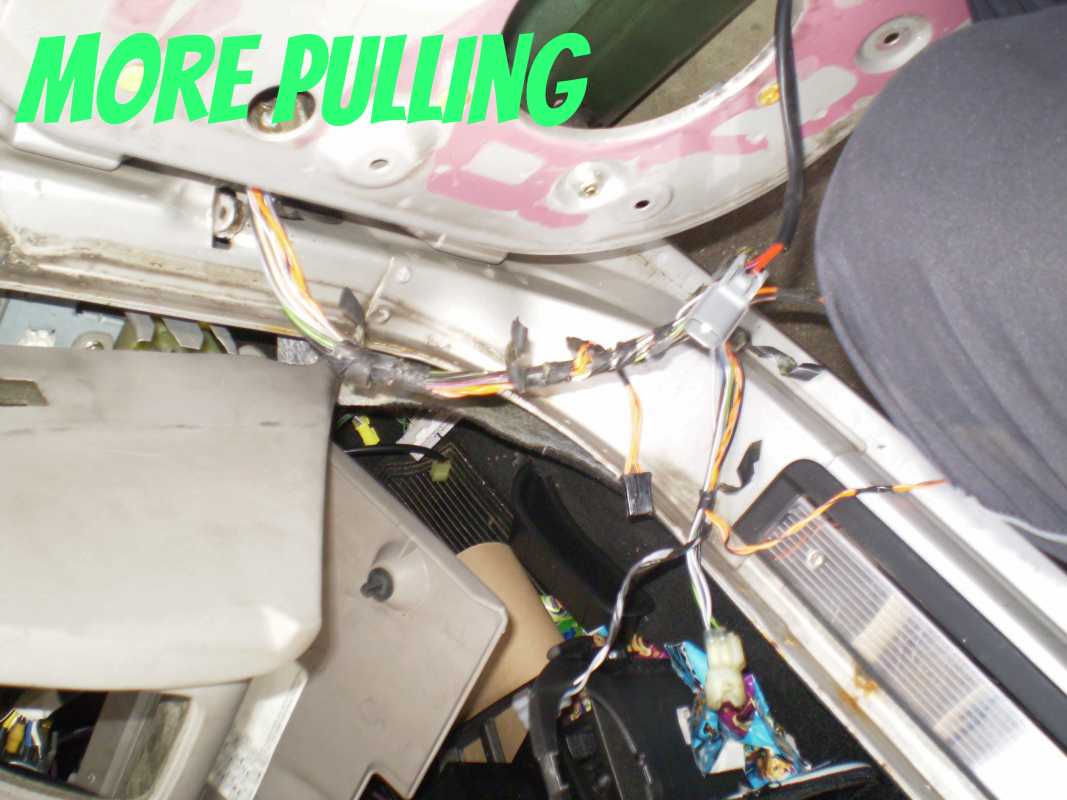

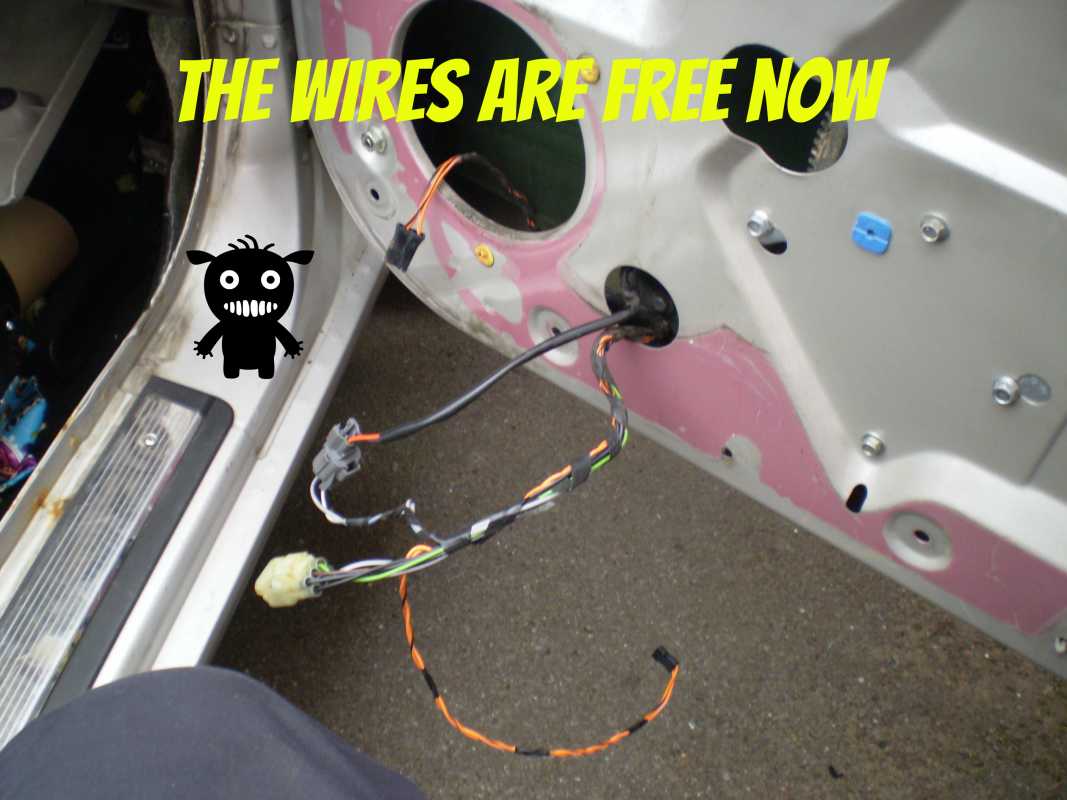

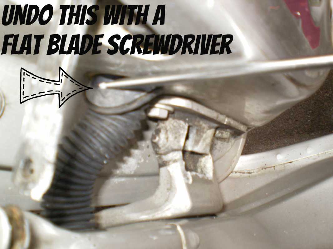

Next unclip the "Door Snake" that holds your wires in with a screwdriver.
And pull the wires from your door card up and out of the hole where the door snake lives.

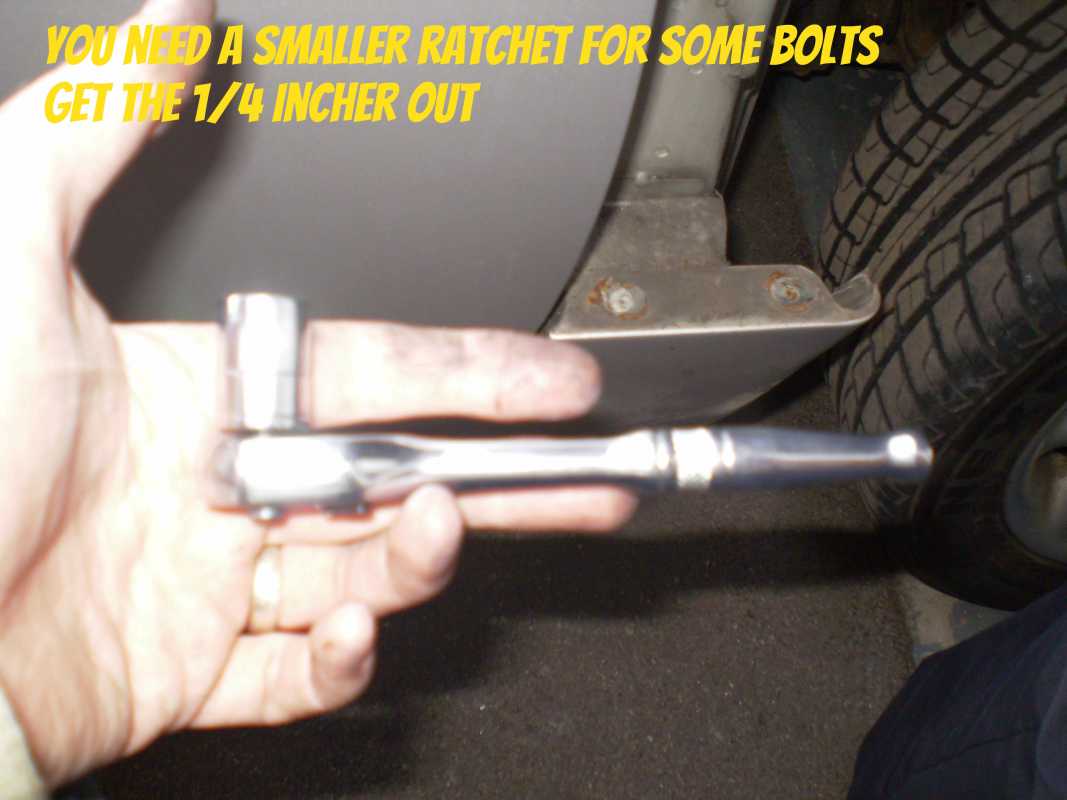

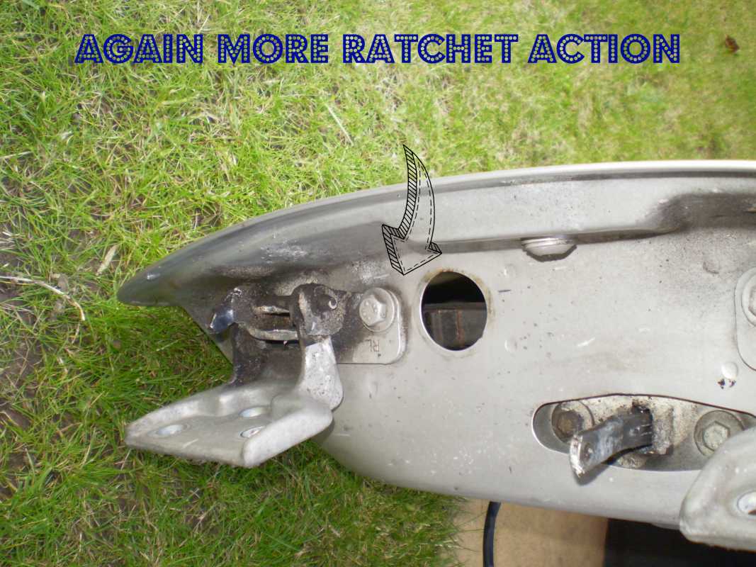

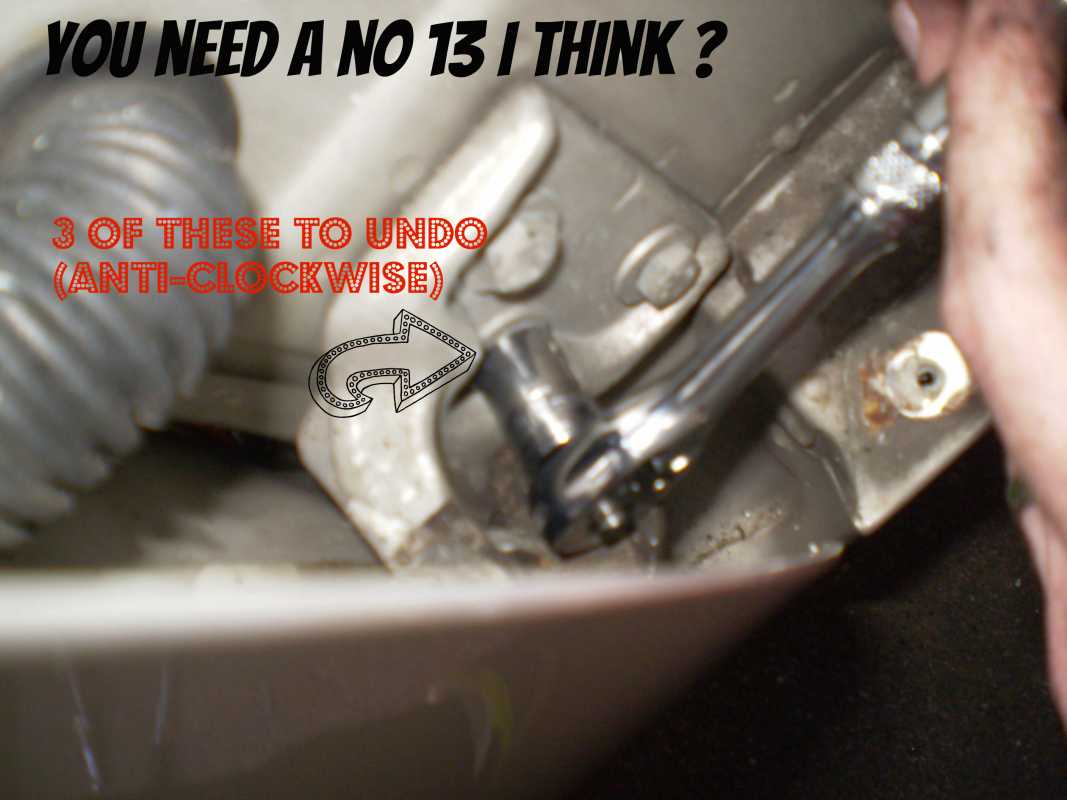

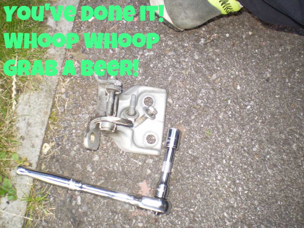

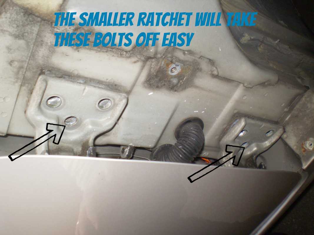

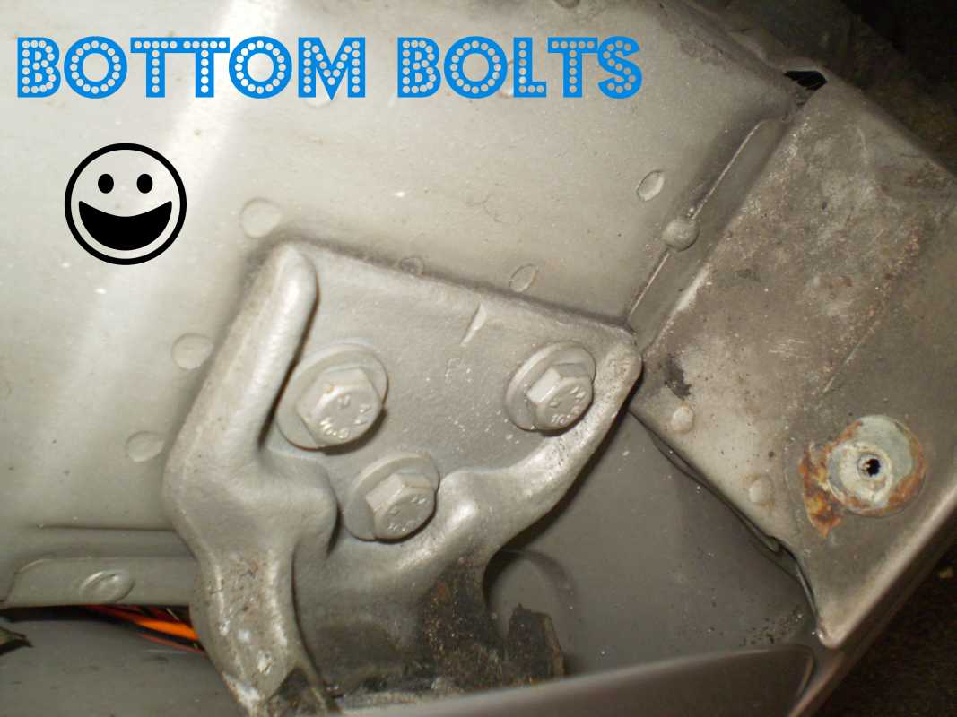

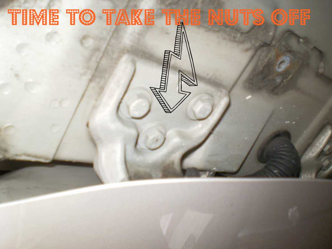

So now the wires are out shut the door slightly and start taking the nuts off. You'll need a ratchet spanner or ratchet handle and socket like what I used.
But some of the bolts / nuts whatever you want to call em are a bit tight for the standard ratchet so I had to get the "mini me" 1/4" ratchet out to take the ones you can't reach.
Here he is bless him :broon:

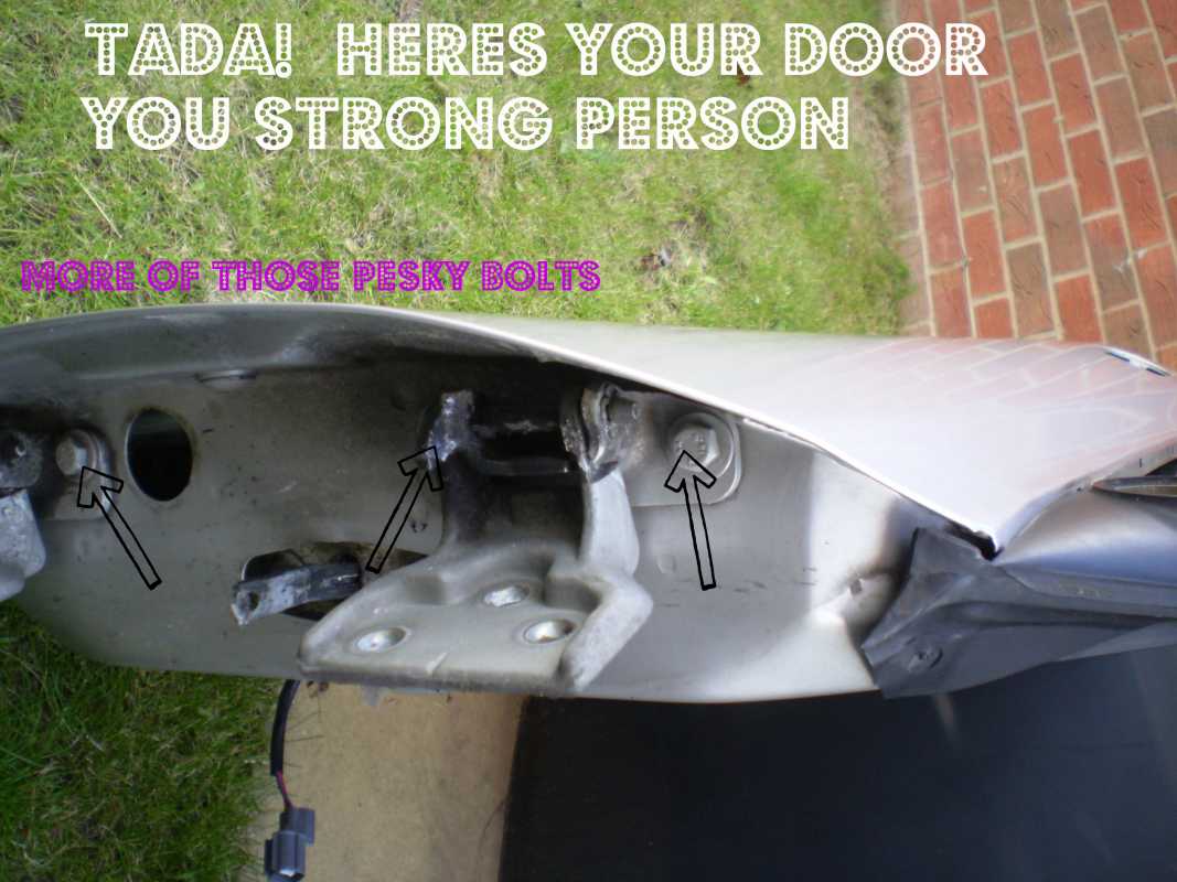

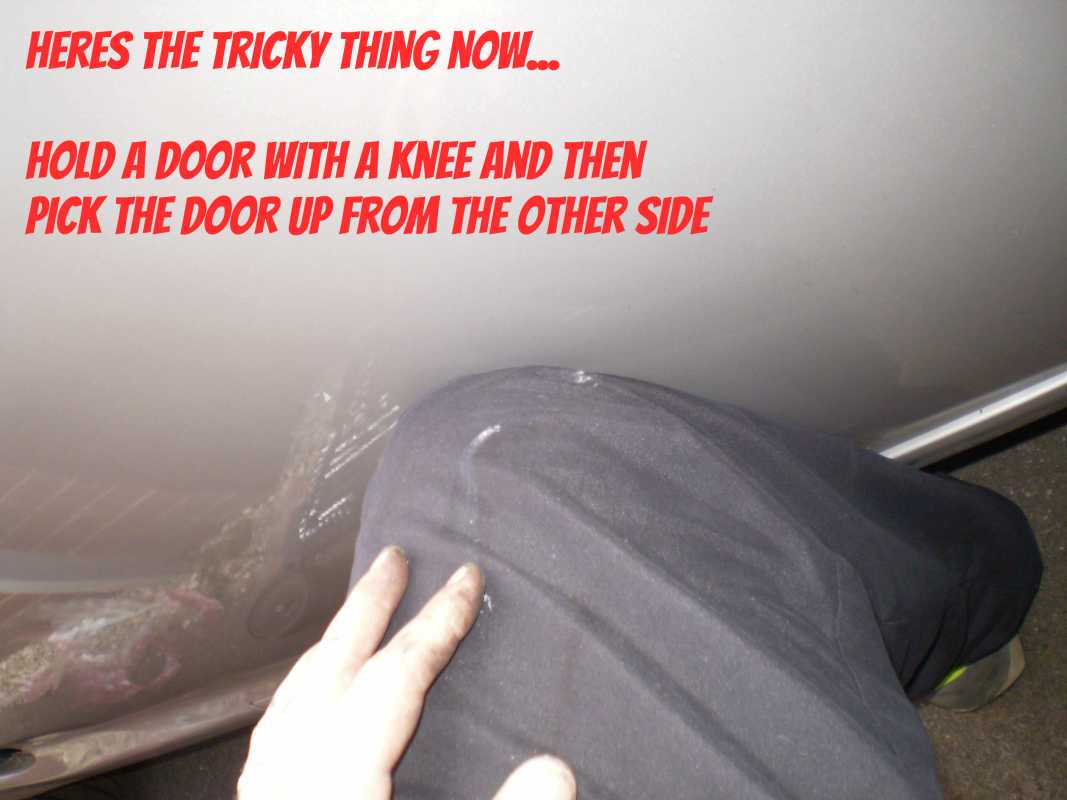

Now its magic time. You need to hold the door with your leg as the hinges are off or it will fall off and hurt you and your pride.
So press on the door with your knee then pick the door up from the other side. Theres loads of gaps in the metal to choose from.
So its off but it somewhere safe and scratchfree.
