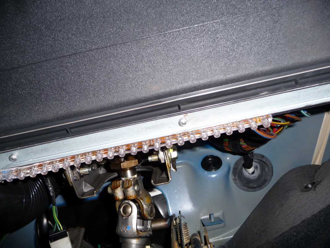

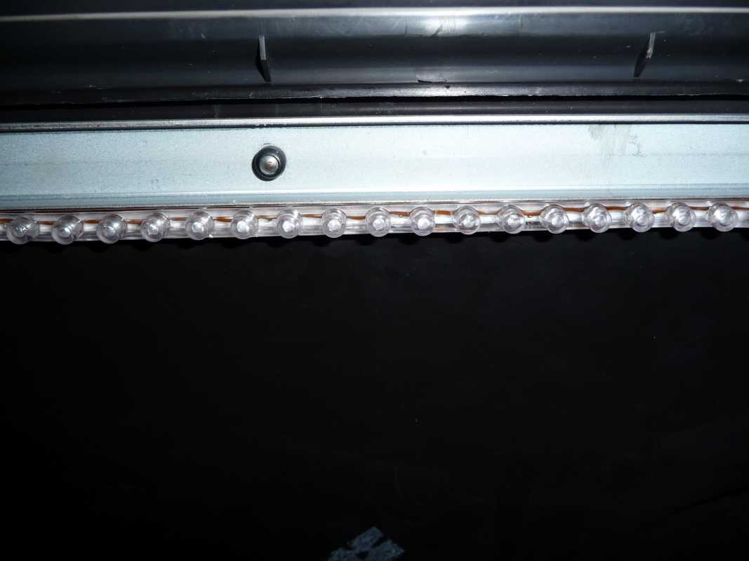

as well as change the mirror lights to blue leds,i got some blue led strip lights took out the footwell lights and blanked them off,wired the strips to footwell wires,and fitted the strips further under the footwells,i think its far brighter and better than the originals.

yes its easy,ebay brightlights4all[19753] the lights are self adheshive,unscrew the two scews holding the footwell lights,disconnect the two wires,you can remove light units if you wish,fill in the two holes[im using rubber]see photos for postion of new lights,comes with plenty of wire ,i cut off connectors and used terminal blocks,with door open connect new wires to terminal block if light does not come on switch wires over,plenty of room to hide excess wire re fit footwell coves and you re done.
