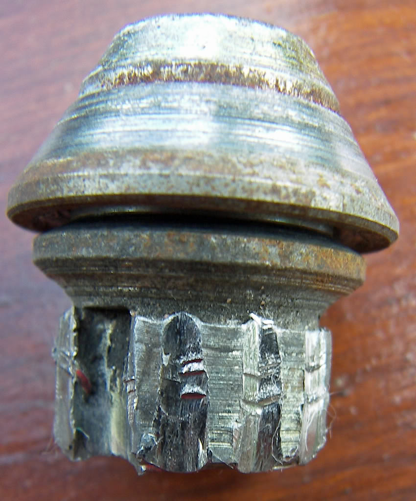

The new locking nuts arrived and I went to swap them today. Took the first one off and replaced it with the new shiny one, no problem. However, on the second wheel, the key suddenly slipped round! I took it off and found this- Spot what's wrong here!
Mmm, not too impressed with the quality of OE.
Using a socket hammered onto the locking nut, I managed to get it off, but it now looked like this.Pretty soft metal!
*A quick tip to remove the now mangled nut from your socket.*
Once the nut is loosened, re-tighten it finger-tight on the bolt and using a long bar in the socket, a bit of leverage back and forth will soon loosen the nut in the socket. (I also found a 12mm spark plug socket ideal, as the longer socket made it easier to hammer on straight.)
