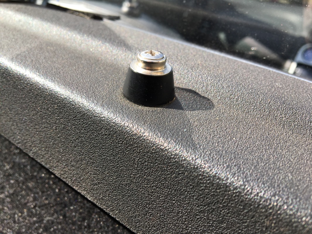

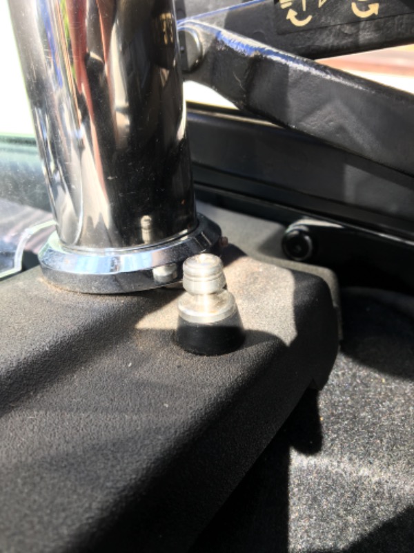

An addendum.
Having talked about the tonneau & your other projects one of my pictures came to mind & it fits right between the eyes of these topics.
I turned up three turrets to go under the press stud & peg, these lift the poppers up by about half an inch. This allows easier popping on & unpopping & as it is around these that the material starts to split, these help. With this uplift you can get your fingers between the fabric & t-bar to lift the popper off, rather than pull it off.
It would take next to no time to print & In next to no time you have a lucrative side project.
