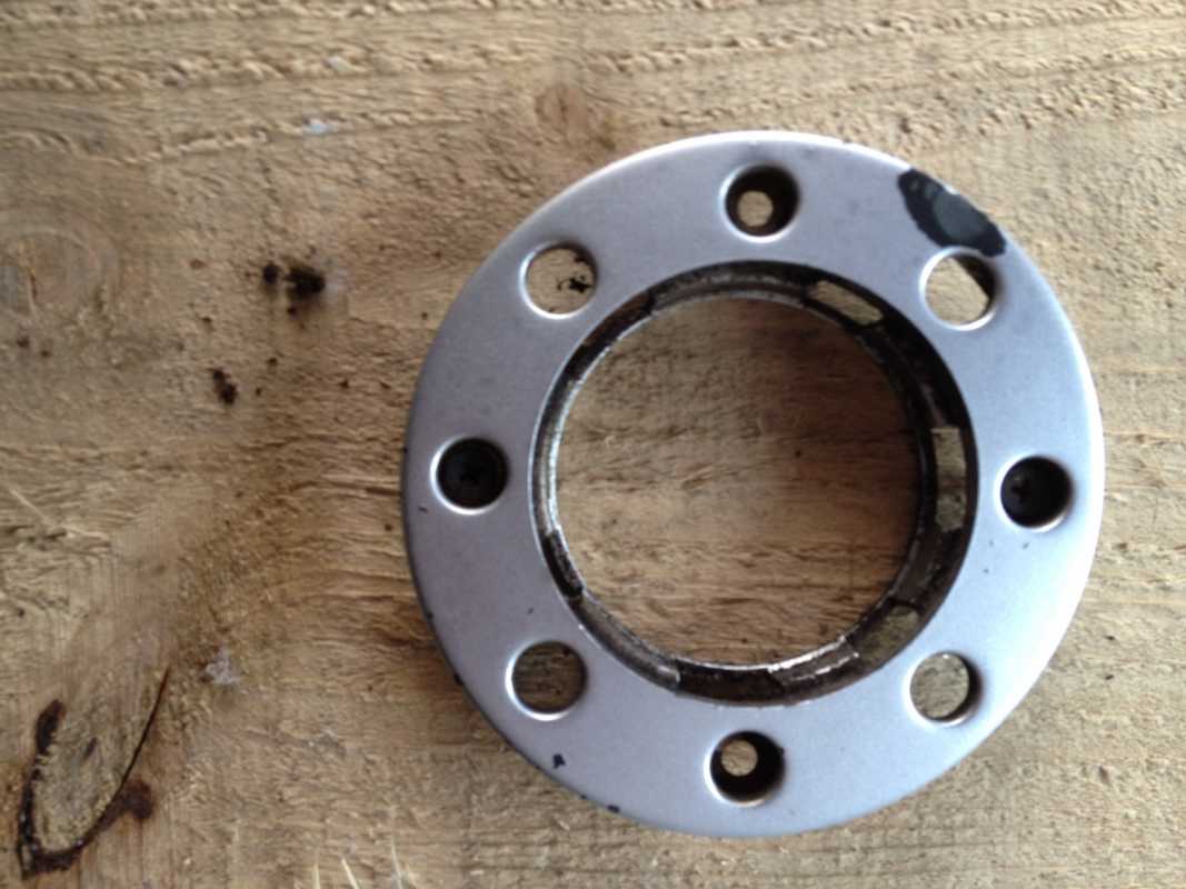

Firstly with steel wool start to rub away a small area of the top coat of lacquer and paint...you will find that it is ...1.lacquer...2.silver coloured paint...3.black base coat...4.base metal....as below...

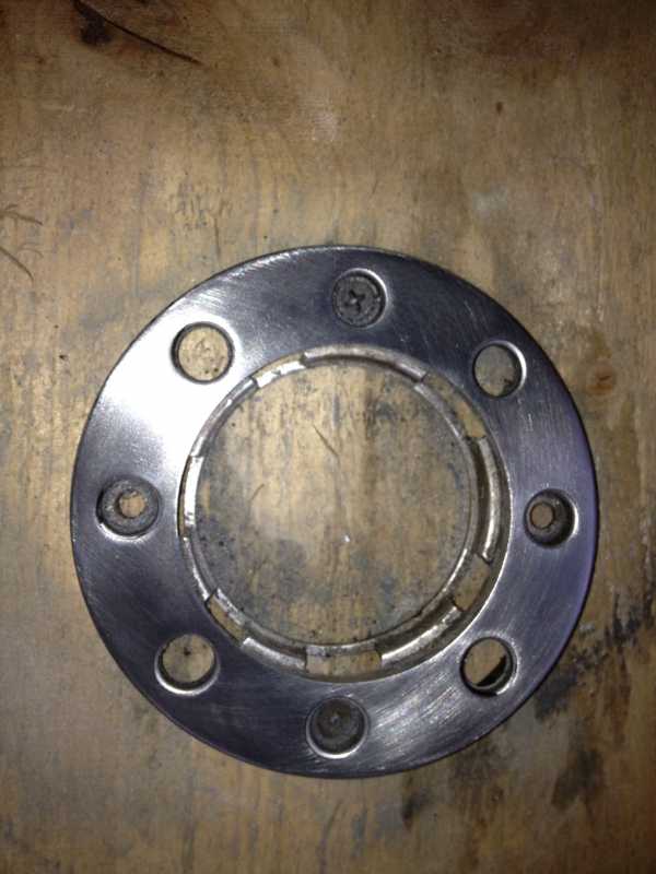

Then you need to remove the allen screws....these are purely for aesthetic purposes...i just put the right sized allen key in and with a little twisting action they pop out...not screw out...you'll be there all day!

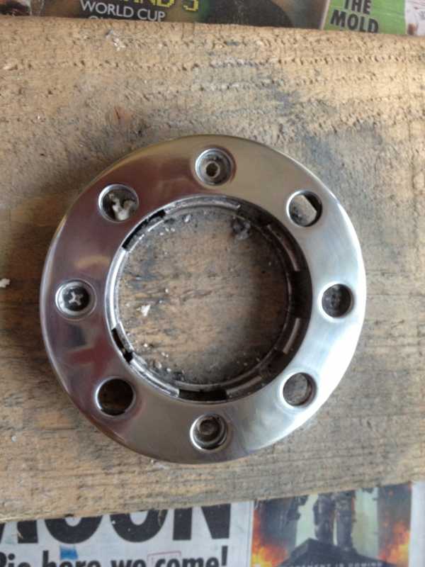

After a good couple of hours of rubbing down with steel wool you will be left with a metal ring...of course this time will be shortened if you have a dremel or similar
From this point its where you start using the differnet courses of wet and dry papers....i started with 400,then 800 then finishing with 1200...the results are great and will be getting some finer grade this week to really finish it off to the best possible shine...
Once done with the finest wet and dry,very important to use this fine grade wet,time for the autosol....lots more rubbing and buffing down will give you the desired finish
finally finish off with a couple of coats of lacquer and your done.....lovely
