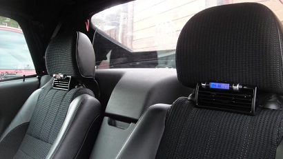

If you want to do the mod for yourself and your passenger here is 'how to' do it. The video and pics below show what it does and how it can look when finished - The 'final look' is ultimately your own individual choice.

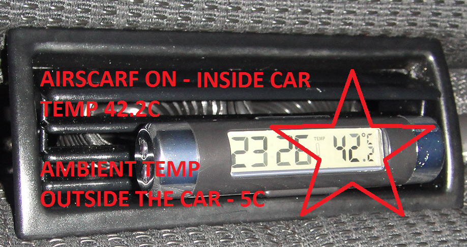

I fitted thermometers to gauge temperature improvements using the airscarf.

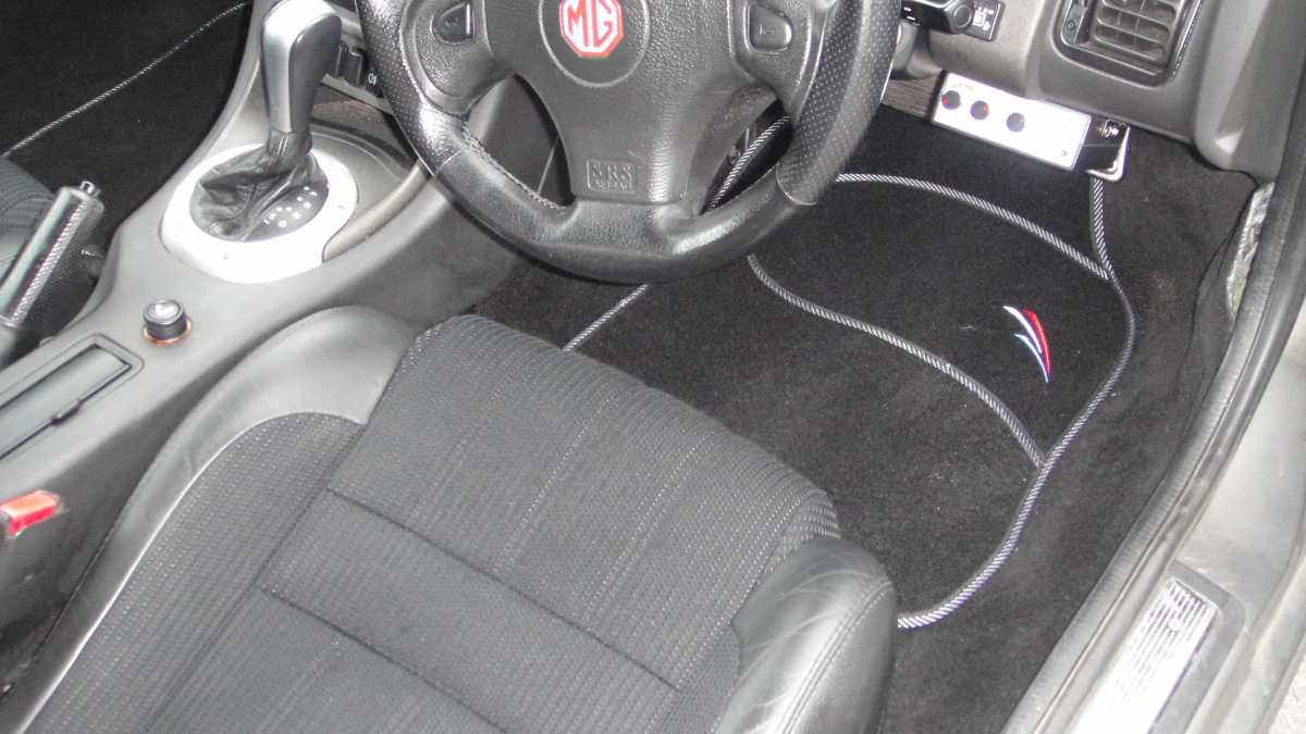

Remove the footwell light panel and insert the pipe.
Resecure the footlight panel.

Showing what's visible once it's done.

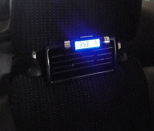

Further mod adjustments - 06/11/11 - Taped around the vents to maximise airflow to the headrest pipes.
View from behind the taped vents.
View from above when closed. Nothing shows.
Driving around on a night that was minus -3C below freezing point. The airscarf provided 31.9C heat to the drivers neck and back area. You can't beat hot air on your back and neck when it's that cold.

I tried the mod with 2 airflow pipes (one in each of the footwell heater vent apertures, shown in the pic below). They both fitted well enough and were not too inconspicuous. It allowed me to turn the heater down to level 2, a slight noise decrease from level 3, but no real difference in the job it was doing in keeping me warm. So, one pipe is plenty. Around town I use setting one. Two or three when driving up to 80 mph on the motorway. :)
Update January 2012 - On my drive home from work at night I check the thermometer attached to the top of the airscarf vent when I have to stops at lights etc. The thermometer usually shows between 25c and 35c. Considering the ambient temp outside has been as low as minus -9c, the airscarf is perfect for nullifying the windchilled draft I used to suffer across my shoulders. A perfect little mod at a perfect little price. Should you ever decide to make your own, then feel free to ask any questions that arise as you do so.
