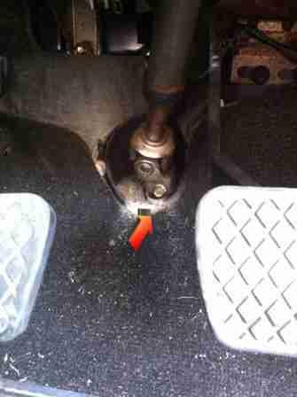

Now loosen & remove the pinch bolt holding the steering column to the steering rack.

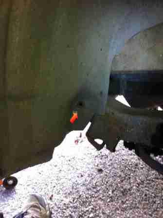

There is a Scrivet in the wheel arch that needs to be removed prior to the subframe being lowered or it will get ripped out!!! Been there, done that.

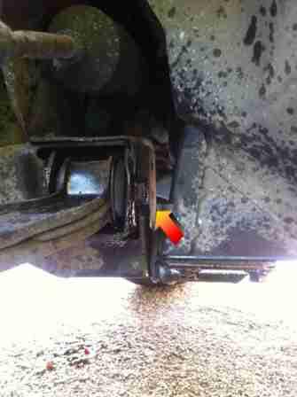

The bolt holding the front of the wishbone can be removed. You will either need to remove a grommet at the front of the sub or peel away the tape. This will then reveal access to the bolt (19mm)

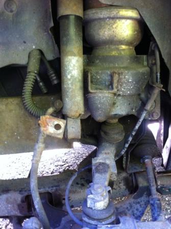

I thought that at this point, if I lowered the jack then the sub would lower. No. I undid the bolt at the bottom of the front suspension dampner. Making note of the order of spacer, washers etc.

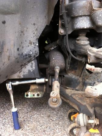

The more astute will notice from the above picture that I have also unbolted the track-rod end / steering rack from the hub.
You now need to remove the pinch bolt holding the lower ball joint to the hub.

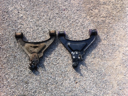

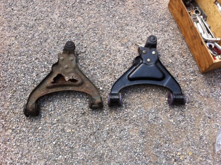

Finally a picture or two to show why I went through it all. The front right was an advisory at last years MoT. Found replacements in good order fitted with Polyflex bushes. Glad I did it, absolutely horrified by what I found.
