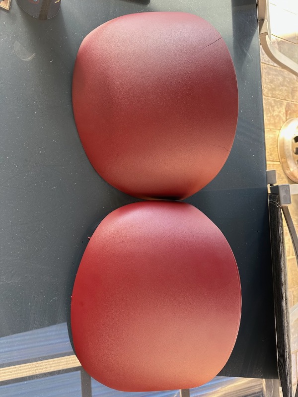

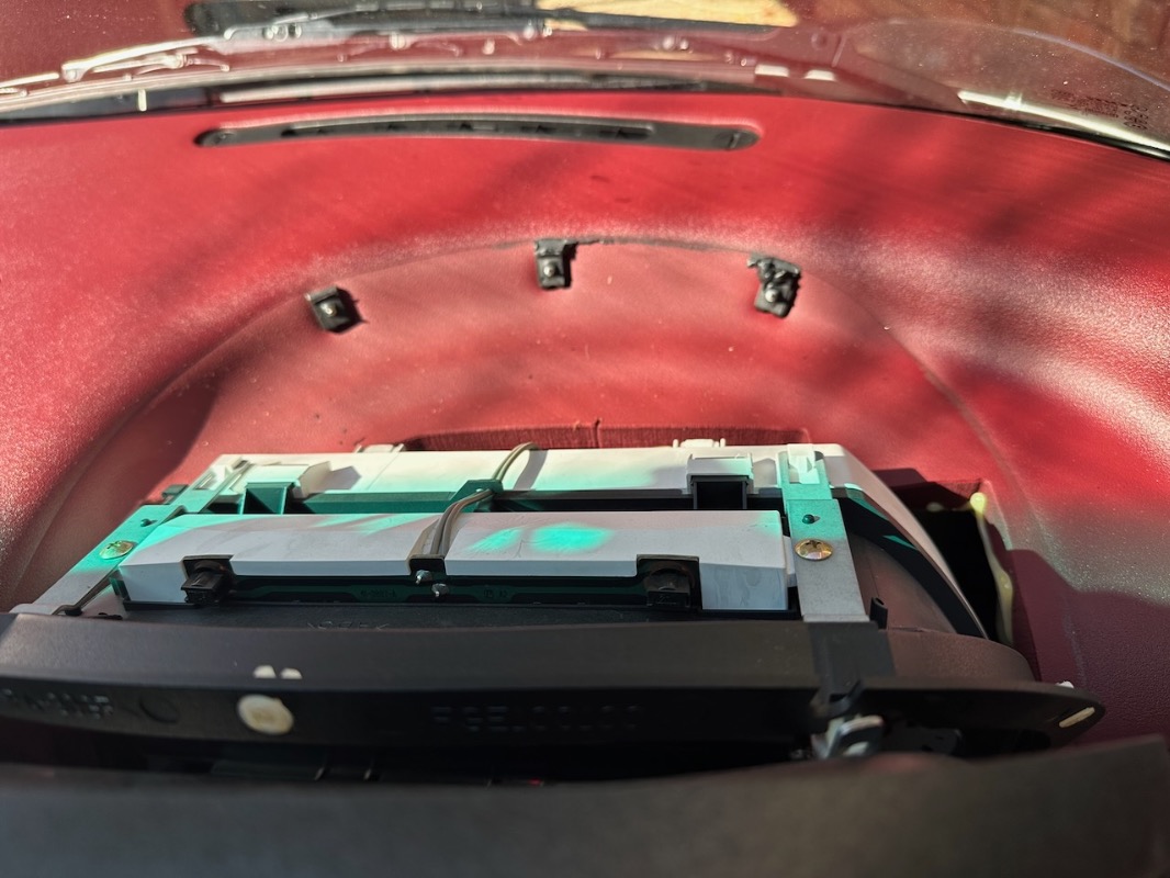

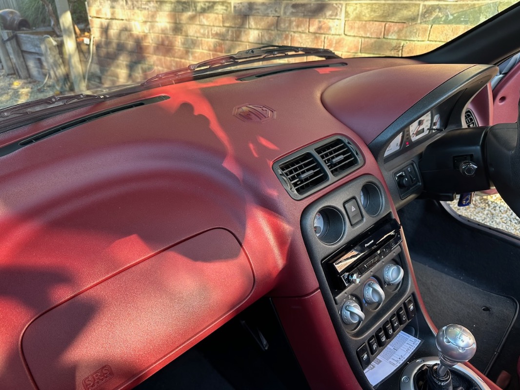

Sorted out my paint issue. Took the glove box along to local paint shop, Complete Auto Paints ,and they mixed up a couple of spray cans of arcylic paint with a special additive for trim paint. $80 for two cans (two can minimum - I have spare can for anyone local). It worked a treat, cleaned the Jacobi binnacle with isopropyl alcohol then scuffed with a Scotch Brite pad soaked in isopropyl. See photo of the old and new binnacle. Interestingly I found the original binnacle was painted also (I had magined it was Grenadine ABS until I removed).
New Jacobi binnacle fitted easily. The biggest job was cleaning up the silastic used previously to secure the front clips.
Pozi Drive screw drivers are your friends for this job.
