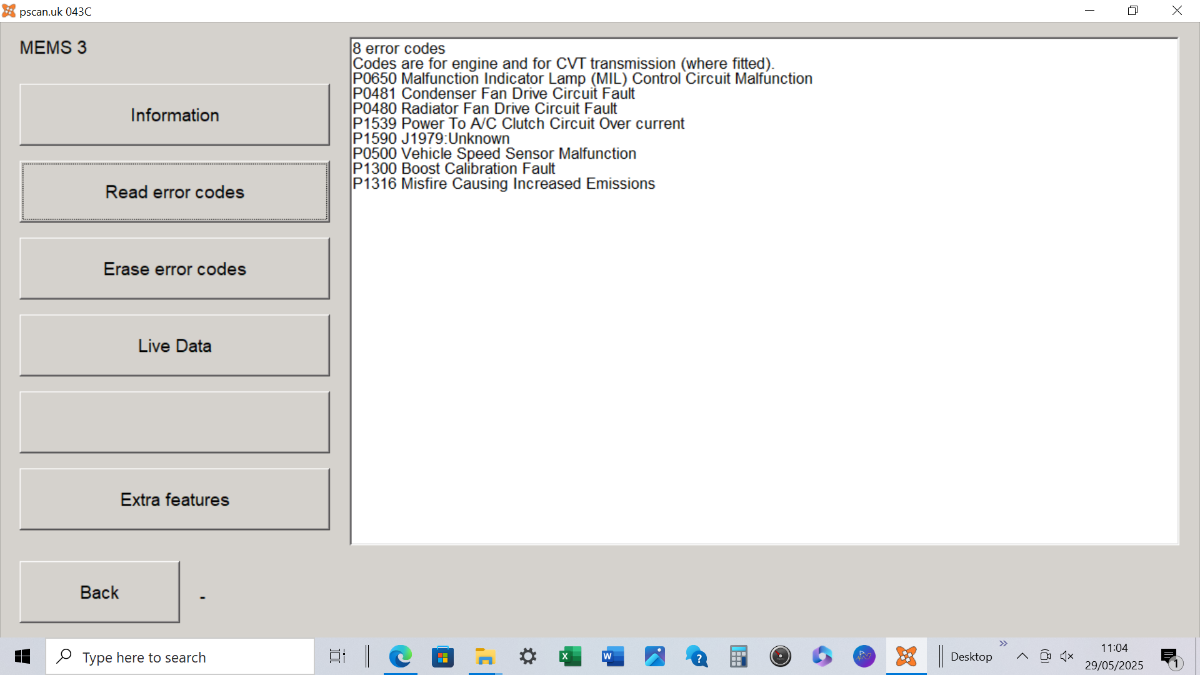

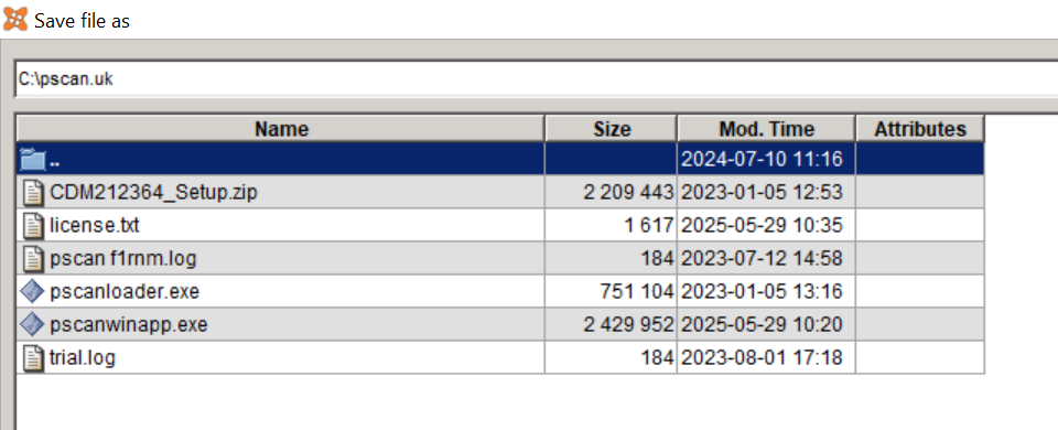

For many this technology will be simple stuff. Unfortunately for me it is testing my limits. Hopefully you will see two images attached, one showing ref to the pscan exe. and the other to the fault codes.
First can someone please confirm that I have the latest update (I think I have based on a ref to version C showing). Whether it was Rev B or C before I attempted an update i can't say. Is there a simple way of establishing which version I have in my second machine without going through downloading an exe file to that second machine?
Now the second question. Please see the attached image showing error codes. Does that display mean that those aspects or features have errors, did have errors, or that it checks for those errors, or something entirely different?
Anything you can add will help me to better understand what i can or should be able to do.

Replied by Roverlike on topic Software version 043B
Posted 1 year 1 month ago #215523
Your current version is 043C as shown in the upper left corner of second picture. That is latest version.
List on second picture is presenting error codes stored within your engine ECU. You can try to erase them and see which ones will come back when you start the engine after erasing the codes. The ones which come back are present errors stored in your engine ECU and needs investigating.
Last Edit:1 year 1 month ago by Roverlike
