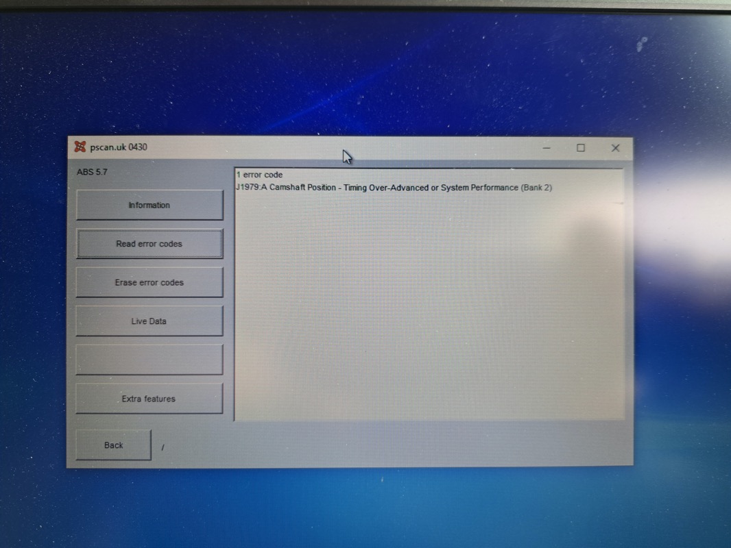

My Pscan is exactly as I bought it some years ago, no software updates etc. I've used it to clear engine codes on ZR's and petrol ZT's, however on my diesel ZTT i've replaced all the brakes, discs, pads,flexis and some of the hardline. I now have an ABS fault showing on the dash. I've used Pscan to access the ABS but the fault it reads doesn't seem to relate to the ABS unit it seems to be an engine fault code.
Does anyone have any suggestions The code is in the pic attached.

There was a bug fix for ABS error codes.
Read about it here
https://www.the-t-bar.com/forum/pscan-uk-diagnostic-tool-forum/97949-software-version-0434
Please can you update to the current version and retest.
Read about it here
