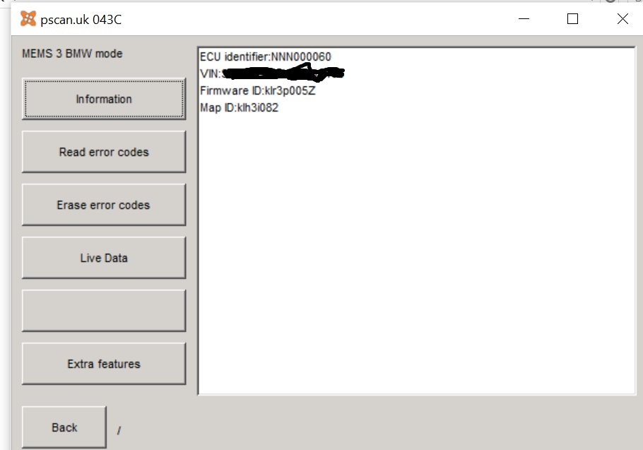

Well, here is the screen dump from my car via Pscan. Anyone know what this might indicate if anything?

I believe that tuning them doesn't change the map or firmware IDs
Also, I thought that the LE500 ECUs are NNN000830

Posted 1 year 1 month ago #216180Delbourt does not have LE500. He hijacked existing thread, so thread title does not have anything to do with his questions.I believe that tuning them doesn't change the map or firmware IDs
