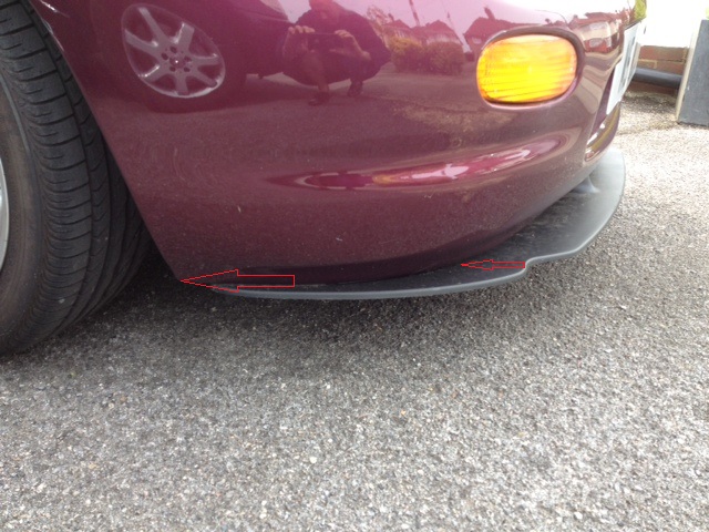

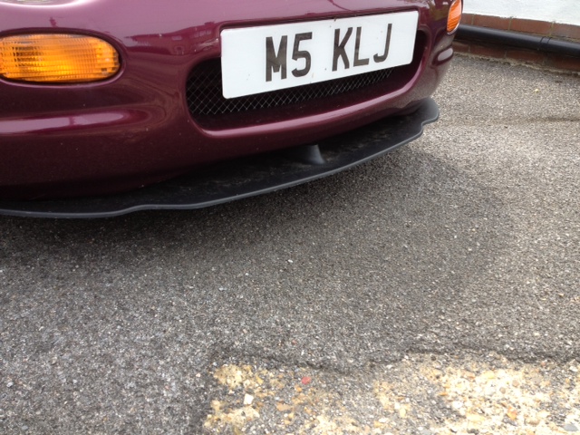

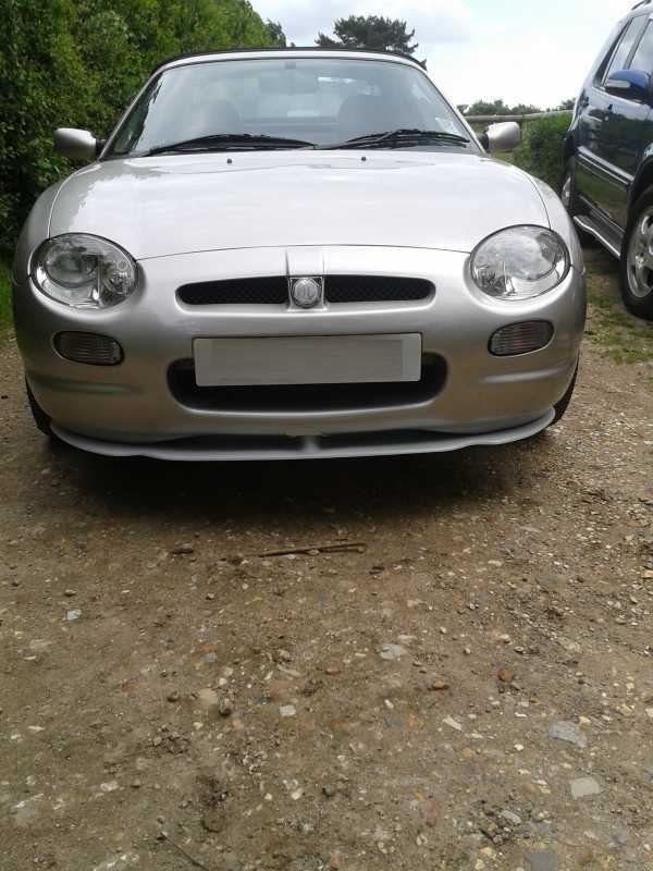

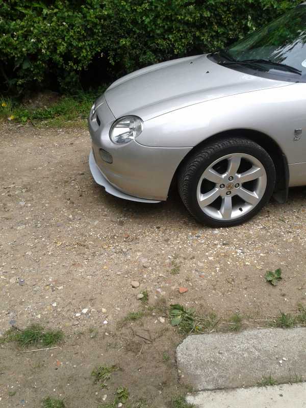

Evening all,
I had a little play with the splitter today and clamped it into position. Its now i realise im not really sure how these should be positioned. The ridge on the underside of the front bumper is pretty much as far "back" as you can push the spoiler but then the holes that are pre-drilled at the back of the spoiler are very close to not being in a position to attach to the bumper.
Push the spoiler forward as far as you can so the holes line up with the bumper before the curve of the bumper means it looks weird and it tilts upwards at the front at a jaunty angle (about 3/4" between the furthest back / furthest forward position).
Anyone else found the best position to fit this/ got any pictures :-)
Attached some photos to show how it looked... it might not be 100% straight as i was just trying it up for size/ locating the fixing holes. ;-)
Martin
Last Edit:13 years 4 weeks ago by martin_bmth
Last edit: 13 years 4 weeks ago by David Aiketgate.

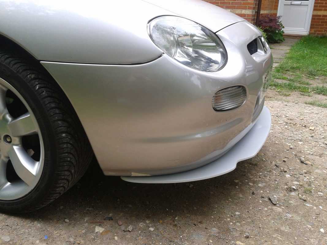

Replied by Dave Baird on topic Re:Spoiler group buy M99
Posted 13 years 4 weeks ago #121137
I would try moving the splitter back until the ends line up with the wheel arch. That position looks pretty good on David Aiketgate's MGF.
Replied by Paulontour on topic Re:Spoiler group buy M99
Posted 13 years 4 weeks ago #121140
Dave Baird wrote: I would try moving the splitter back until the ends line up with the wheel arch. That position looks pretty good on David Aiketgate's MGF.
Yes I agree. If the holes with the captive nut won't line up on the bumper I would pop some new holes and fix with new nut,bolt washers. I think you will always find slight differences with aftermarket parts that might need tweaking.

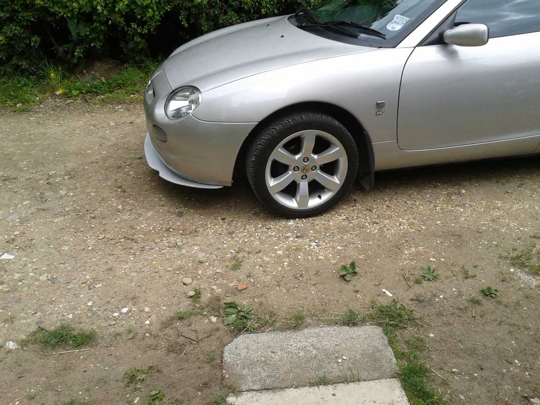

Replied by Tourbillon on topic Re:Spoiler group buy M99
Posted 13 years 4 weeks ago #121151
With my splitter I couldn't get it as far back as I liked so mounted it slightly in front of the wheel arches. I had the upturn issue as well, so cut away some of the central mounting post, this wasn't enough so I put a spacer in on the front post mounting hole to push the splitter down and make it parallel to the ground. This is not ideal but I didn't want to cut into the bumper and eventually will make a moulding to cover the spacer when I decide to spray it a different colour from Rubberised matt black( you cannot see the spacer unless you lie on the ground).
Regarding fixings I thought what was packed was pathetic considering the loadings, so used 6 SS bolts with 1" washers and Nyloc nuts on the inside. They are a pain to remove quickly but will not rattle loose and there is no danger of the splitter ripping free or vibrating itself loose.

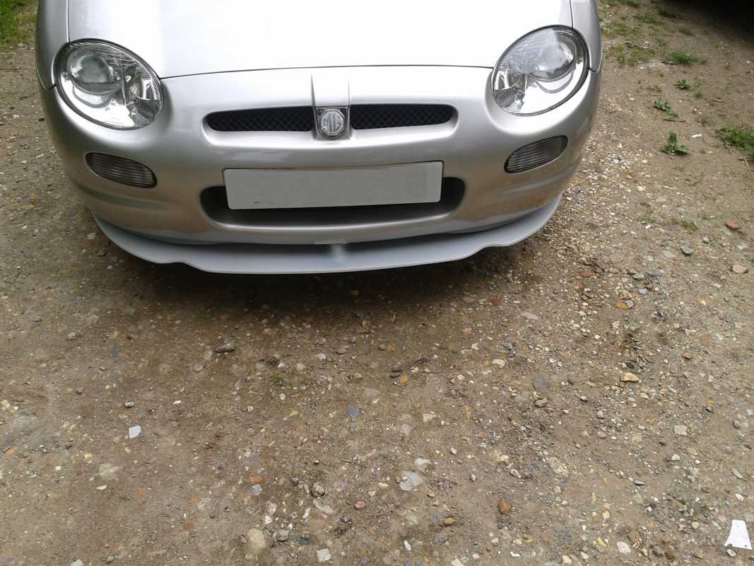

Replied by David Aiketgate on topic Re:Spoiler group buy M99
Posted 13 years 4 weeks ago #121165
As Dave says I fitted the splitter as far back as I could to reduce the chance of ripping it off on a kerb. So back to here.
If I recall correctly it needed a bit removed from the rear trailing edge of the bumper where the cenre column of the splitter is.
Last Edit:13 years 4 weeks ago by David Aiketgate
