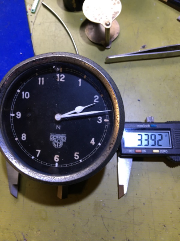

I have a Smiths click that came out of a 1934 Riley, it keeps perfect time & runs for several days on one rewind.
I’ll get around to making a mahogany case one day.
