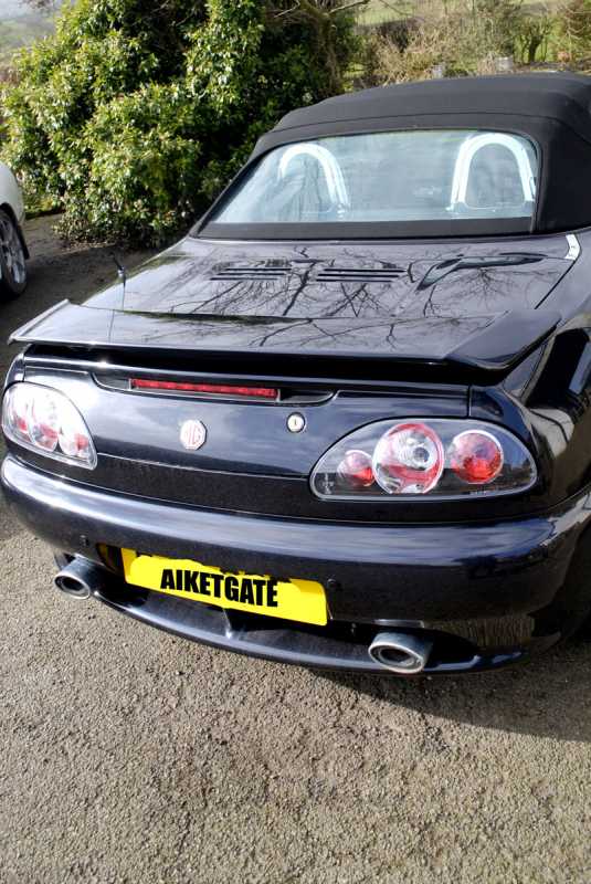

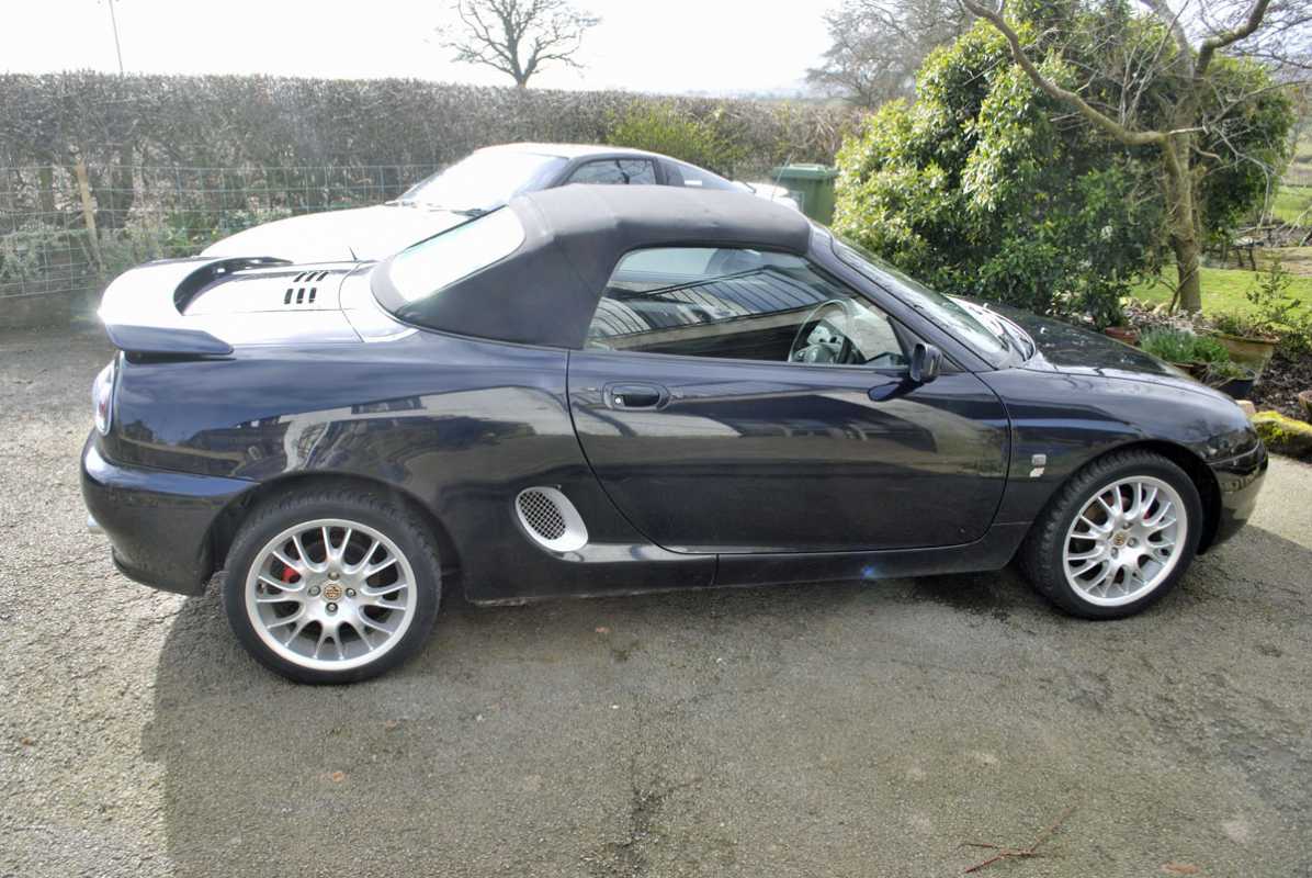

As above really. I know ours that was factory fitted, the rear edge of the spolier is in a vertical plane with the rear part of the boot.
Obviously side to side position is central.
I've just reread that and I'm not certain it makes sense, totally but.....:shrug:
Because Sheils is out in the car I can't measure but here's a photo from the side, so I think my first statement may be wrong, :lol:
and from the back
