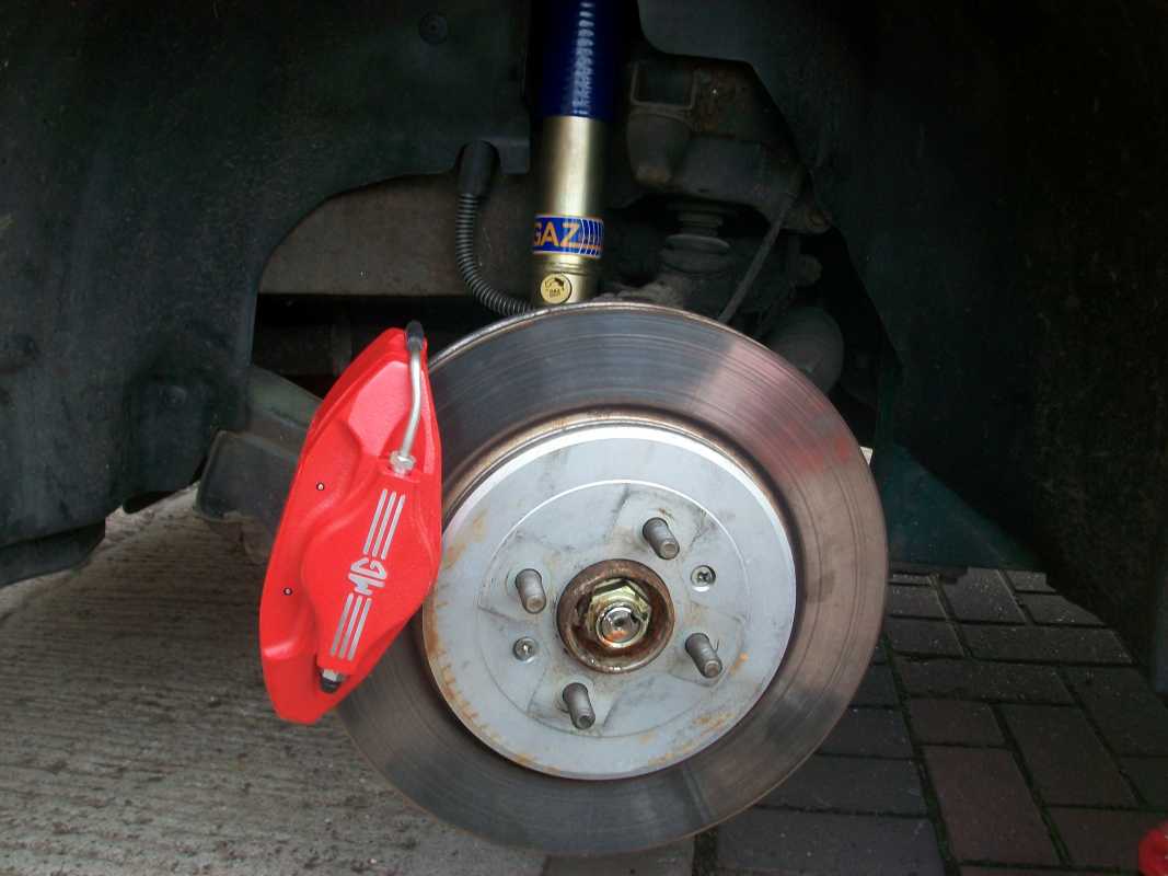

Replied by GT MG SPARES LTD on topic Quick Question about the brakes.....
Posted 11 years 3 months ago #126346
The smaller two pot AP calipers i wrote about earlier in this topic.I done 80 miles on a south staffs mg in the trees run at moderate driving,They was brand new and i only fitted them as at the time a few people on forums who hadnt got there hands on a pair claimed they didnt work with 304mm discs,i asked how they come to this conclusion,i got no valid reply.The picture of them fitted on one of my cars says otherwise. Not impressed with the two pots removed them soon after.
Last Edit:11 years 3 months ago by GT MG SPARES LTD
Last edit: 11 years 3 months ago by GT MG SPARES LTD.

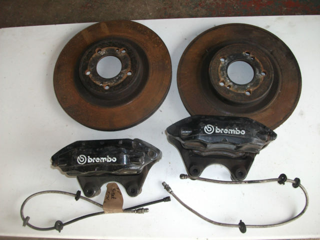

Posted 11 years 3 months ago #126353
Couldnt,be nothing to serious,else will have been picked up on rollers at mot.
I find using a pump as apposed to manually bleeding aps have better results.There are two nipples on each caliper.
Brake bias can be a sensitive thing i recently fitted range rover sport brembos on my nissan the lock up was terrible,i couldnt revert back to R33 gtr as i had drilled the hubs out for bolts.I settled on 34 gtt which are only 4 pot and got much better manners.Watch any formula 1 driver doing a lap on the onboard camera constantly adjusting bias depending on speed of corner.
