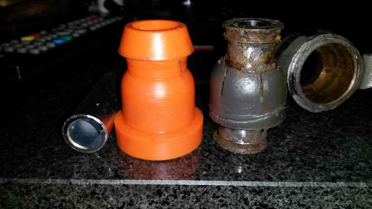

Here are some pictures about bushing the rear trailing arm of a MG TF: http://www.rimmerbros.co.uk/Item--i-RGD000570
The bushes i used were these
http://www.rimmerbros.co.uk/Item--i-RGD000570POLYOUTER
http://www.rimmerbros.co.uk/Item--i-RGD000570POLYINNER

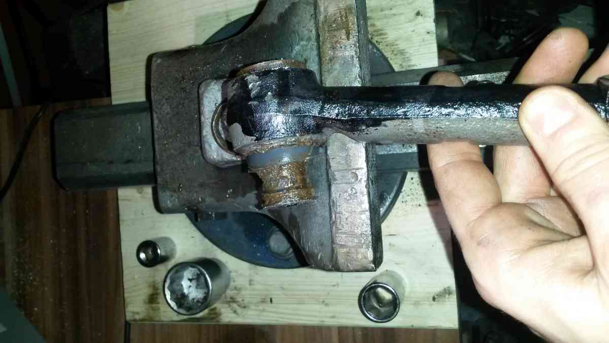

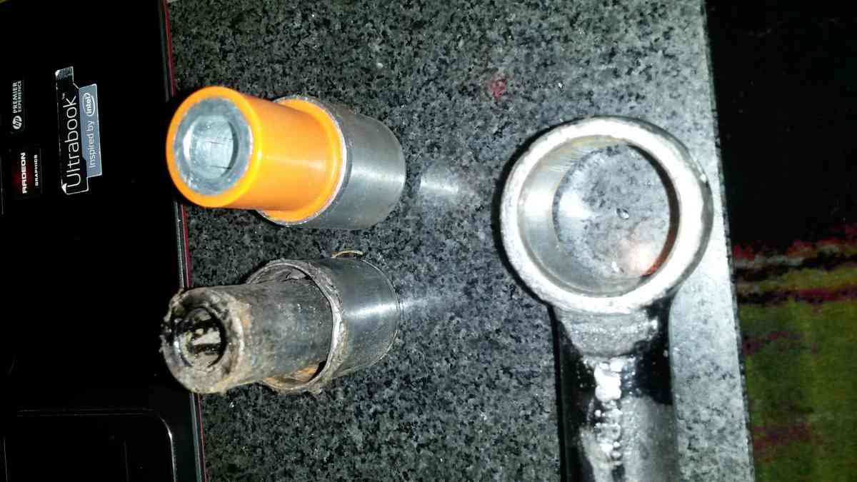

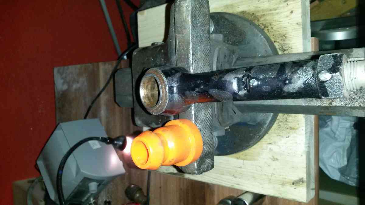

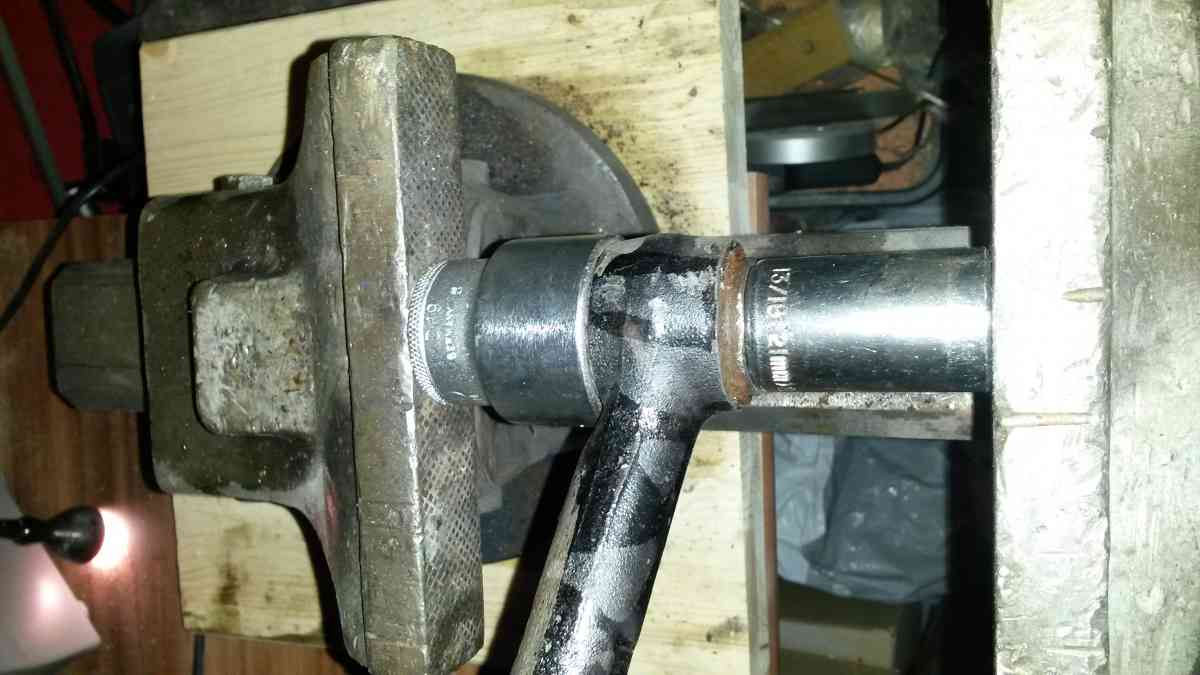

Tools needed:
A vise
Some nuts like 32mm 28mm 17mm
a heavy hammer
hammer time

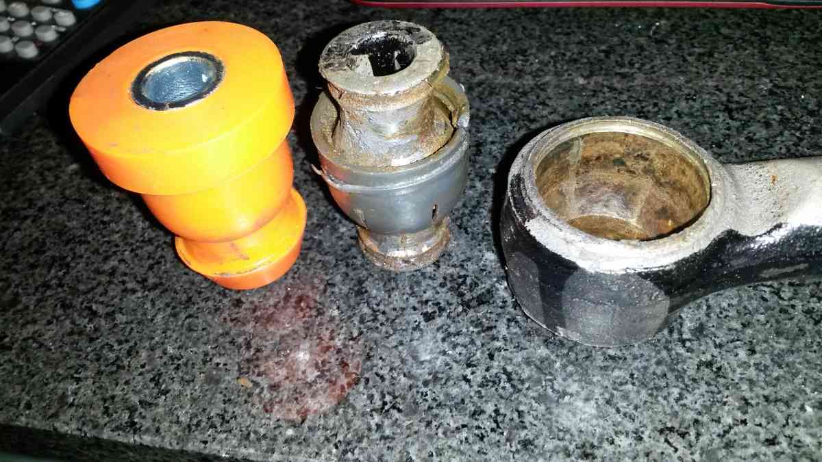

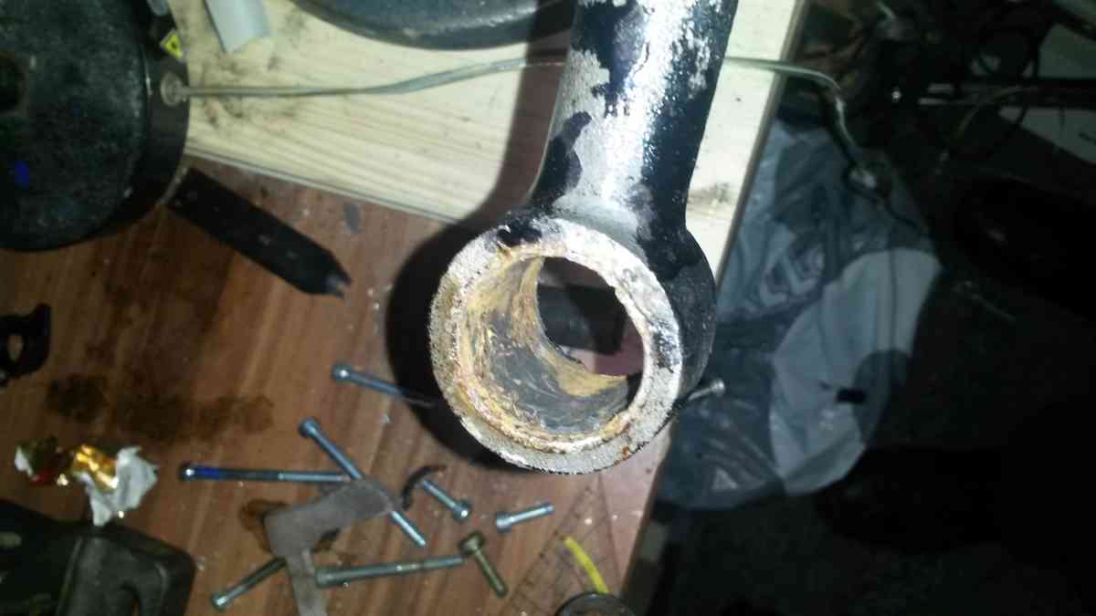

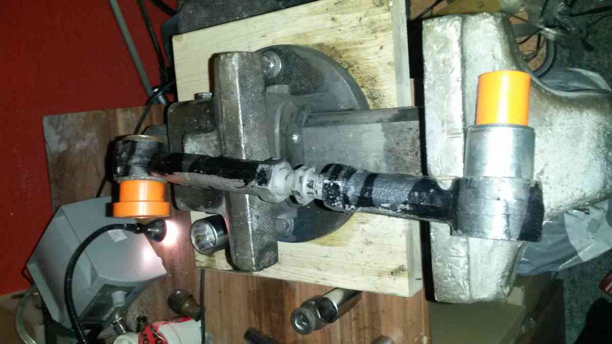

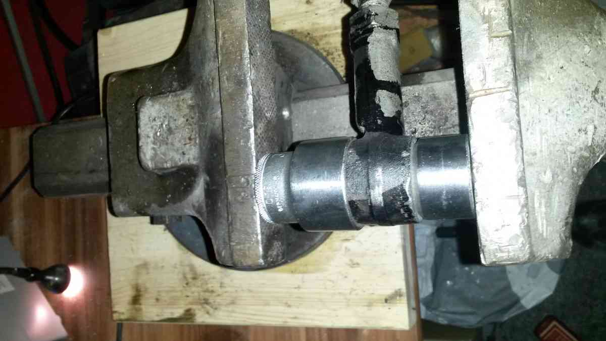

the inner bush at first looked easy to get out. put the bush with the nut in the vise and began to press it out.
Nuts 32mm and 17mm.

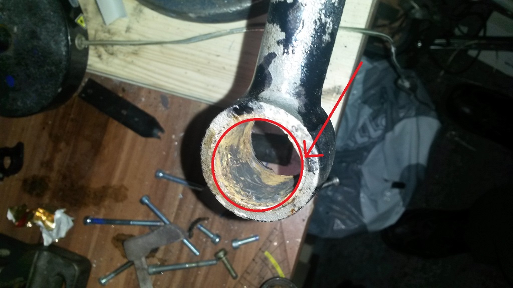

then i realised there is an outer ?bush? on the inner end need to press out to get the poly fitted.
so i needed to press it out. used a 28mm nut fitted perfect to this bush. and again the 32mm nut.
some heavy hammering and it came out.

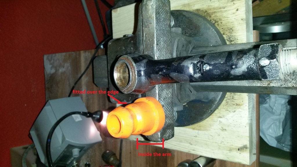

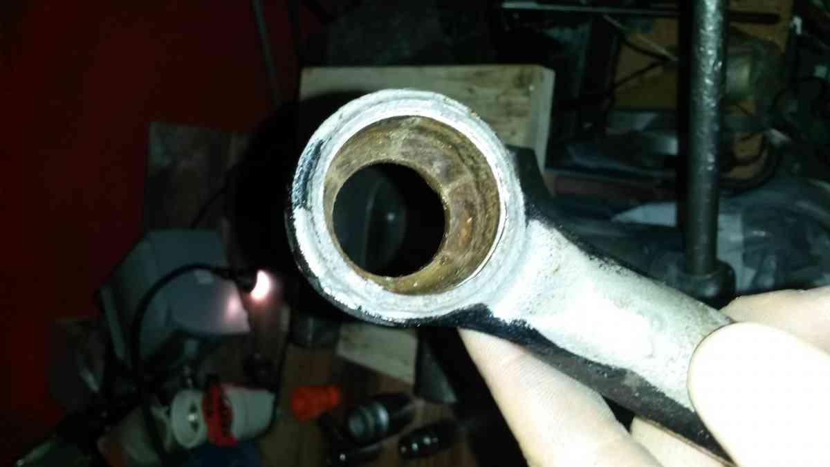

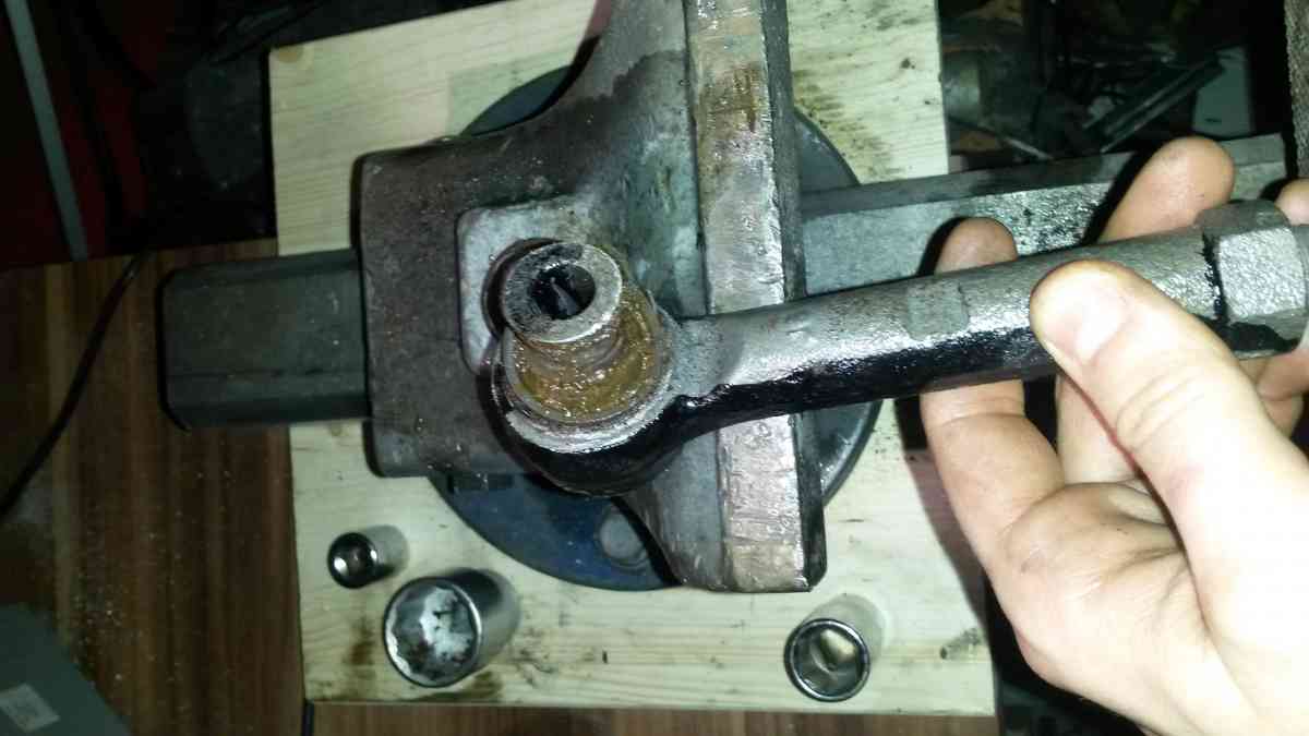

the outer end was a bit harder to get out. until i realised that there is only one direction you can get it out.
first remove the rubber seals by removing the wire clamp.
to find out in which direction you can press this bush out look at my pictures.

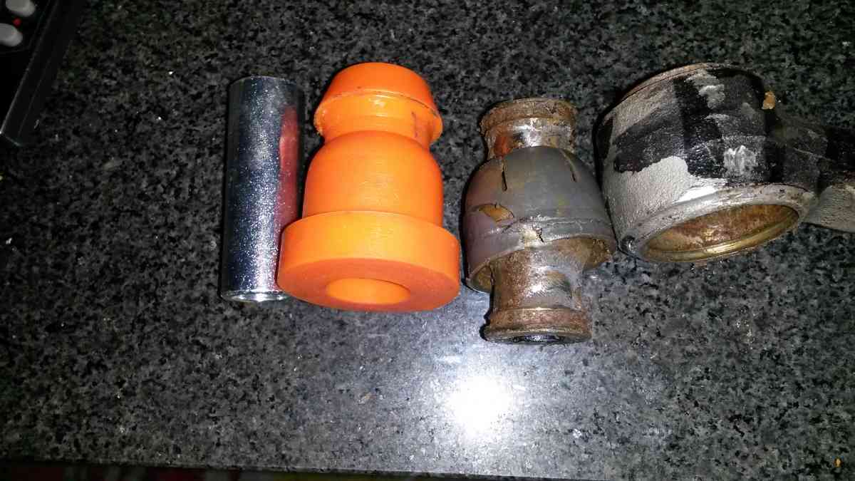

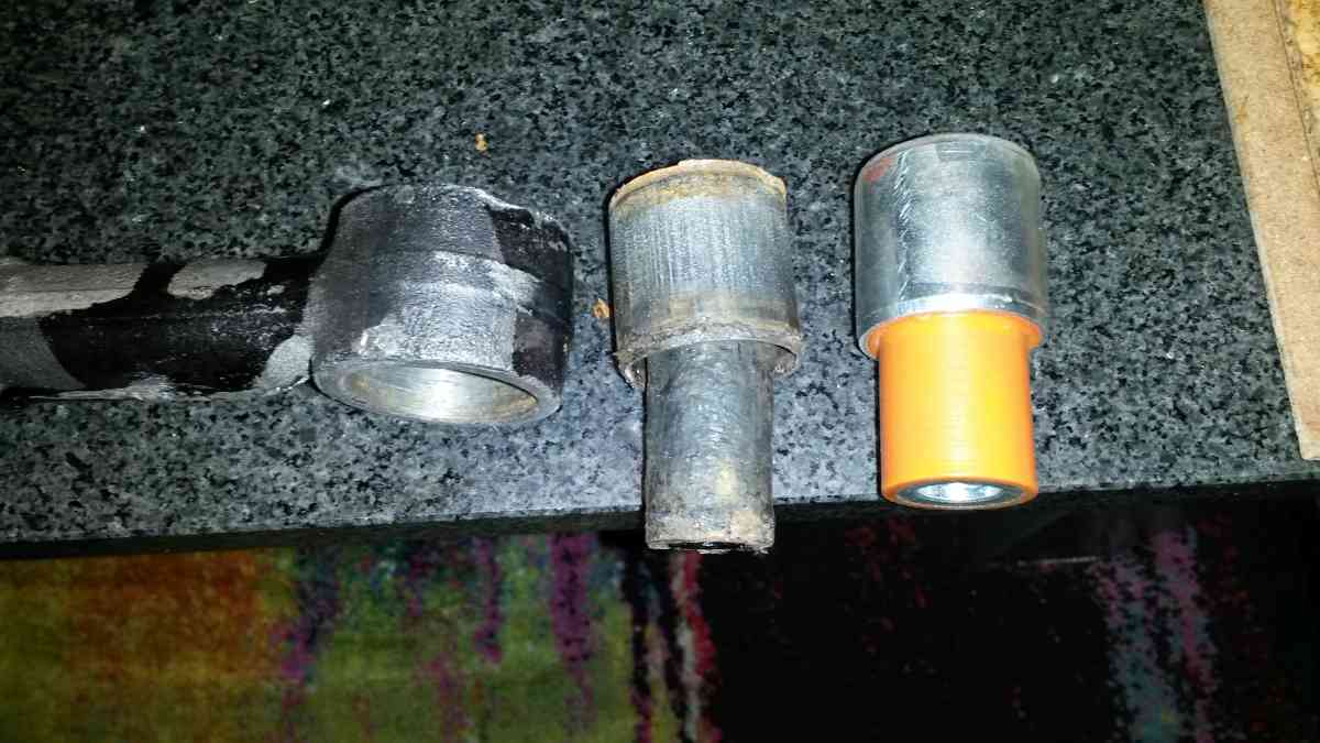

Replied by David Aiketgate on topic Service RDG000570 - Bushing
Posted 11 years 7 months ago #153935
To clarify, the odd bottle shaped bush is a replacement for the rose-joint inner. Yes?
That is a great find, because as you say, the common wisdom is that it can't be replaced.
Which way round does it fit?
Last Edit:11 years 7 months ago
by David Aiketgate
Last edit: 11 years 7 months ago by David Aiketgate.
- verplant23
- Apprentice MGer
- Posts: 24
- Thanks: 11

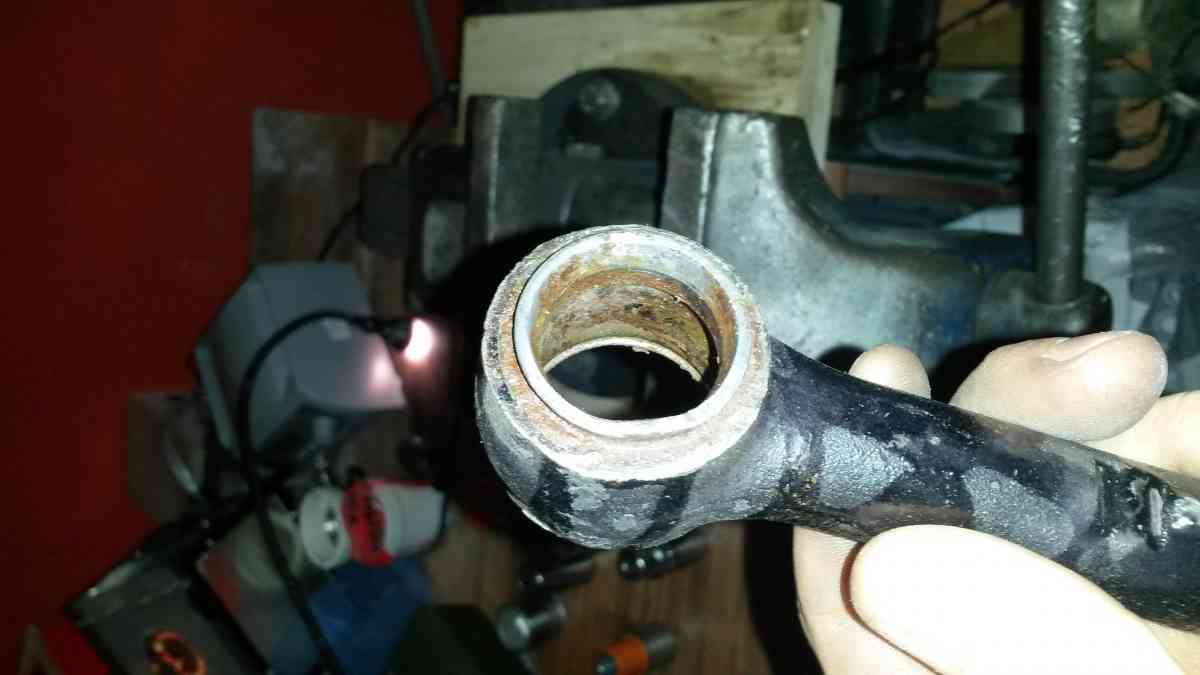

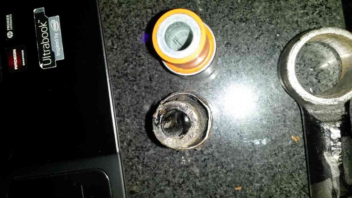

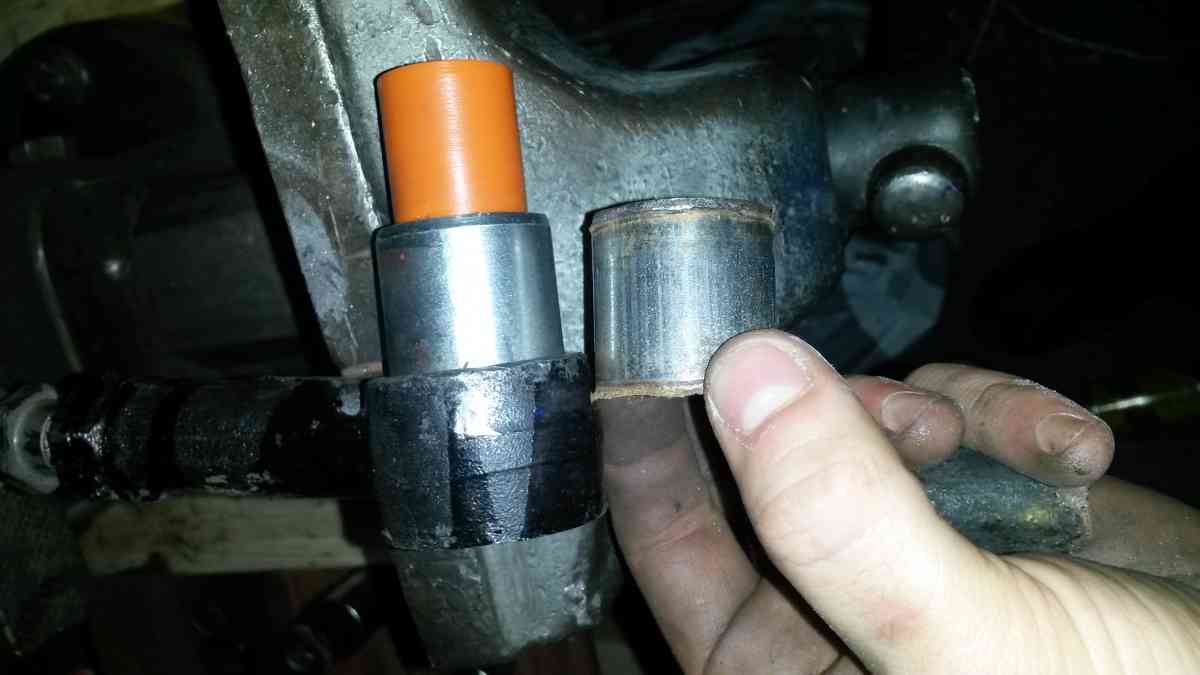

picture 9 you see the bush as you said formed like a bottle? this is the bush for the outer end of the arm(fitted to the hub). this is what is called a rose joint?
the original bush can only be removed in one direction. there is an edge on the other side you can see it on picture 7 and picture 6.
the way you have to put in the polybush is shown in picture9 and 10

And the other side more in detail. now you can take a look on the "outer metal bush" on this side. the poly one has a equal outer metal bush
