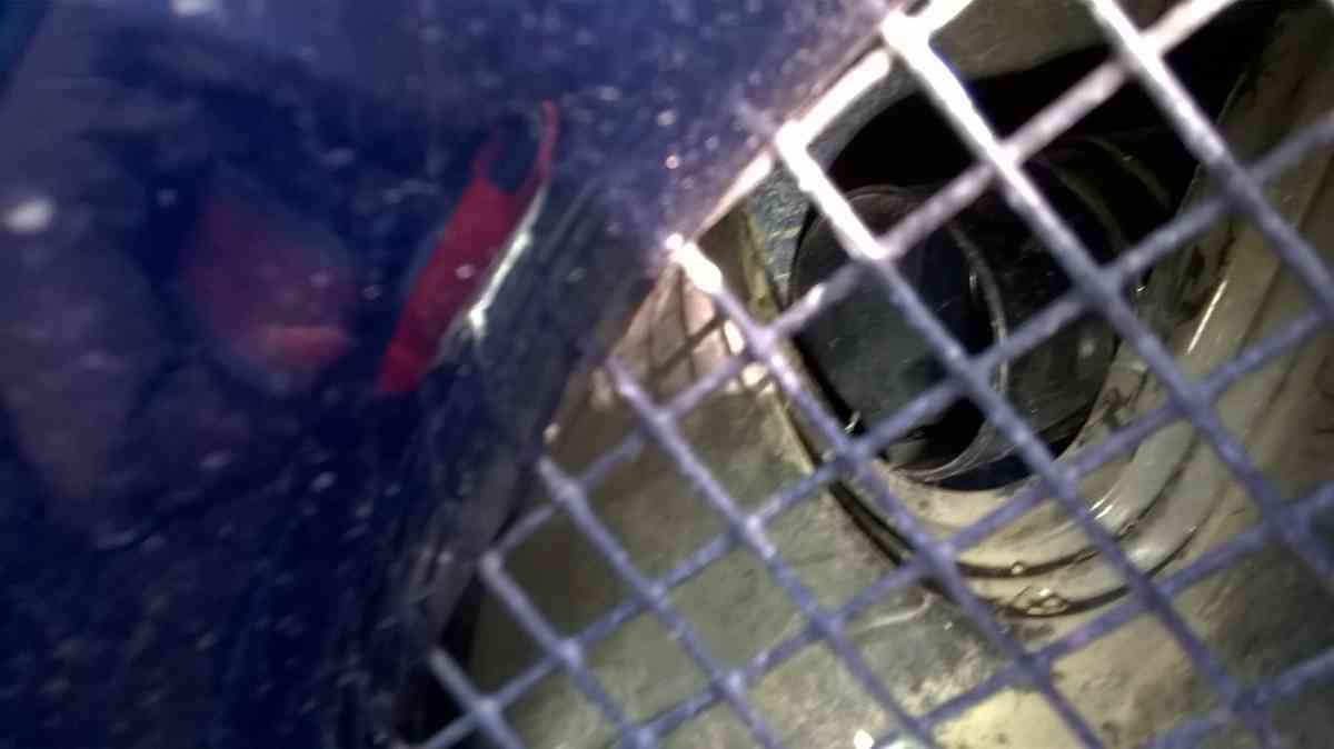

7.The crafty bit, that hose you just removed, is just long enough to reach into the nearside air vent. Reach in with one hand as you pass it down & until it is just visible in the vent.

I`ve just done the mod to a second MGF (VVC), found the pipe was just a little shorter.
There`s an easy fix, cost an additional £1.49 though.
Turns out that a household drainpipe straight coupler (male to female) is a perfect finisher for the end of the pipe.
Wriggle it in large end first & onto the pipe.
Ensures no spray from the wheel arch will enter the pipe & gives a better air flow.
Missus just returned from her test drive "car is snappy, feels more aggressive & smoked an Audi".
Happy Bunny.
I`ve now added the coupler to mine too.
Thanks for the welcome.
Happy Bunny.
