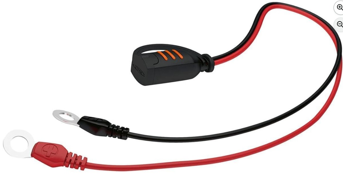

I have a CTEK, and being a motorcyclist, and having a penchant for Ducati's, keeping the battery topped up is a must.
I started out with an 'Optimate' charger, which lasted a good 10 years and now have a CTEK charger. They come with hard-wiring cables, so you can put the connector in an easily accessible place. On the bike, it is easy as it is kept in the garage; my MGF is kept outside, but facing the garage, so it is easy to connect the charger.
It would be great to have an easily accessible location on the outside to connect the charger to.

I would advise against using the crocodile clips and use the flying lead with the ring terminals, especially if the car is outside when it is charging. The last thing you want is a cat or similar brushing past and pulling one of the crocodile clips off the battery. The connector is waterproof so it is well protected.
