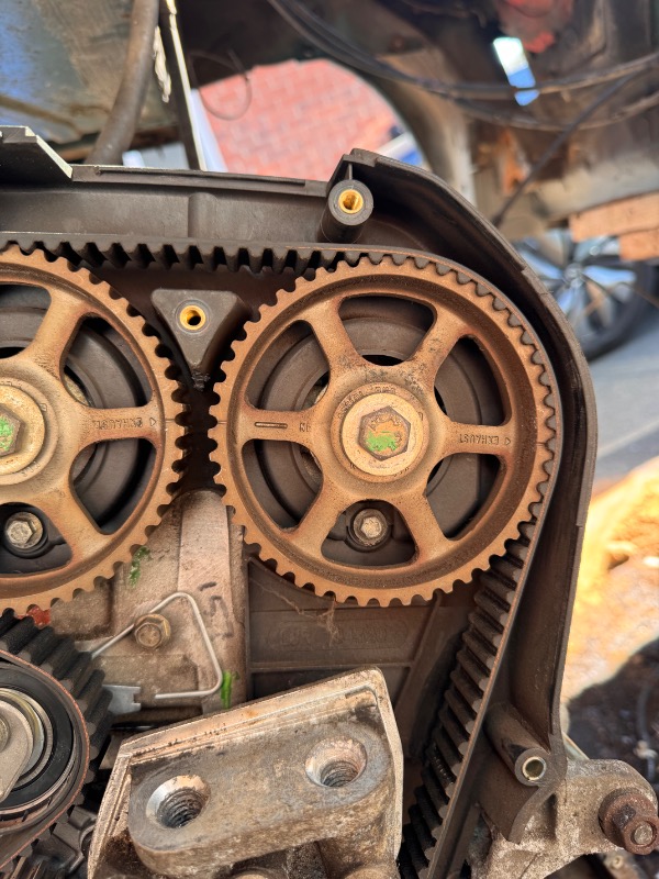

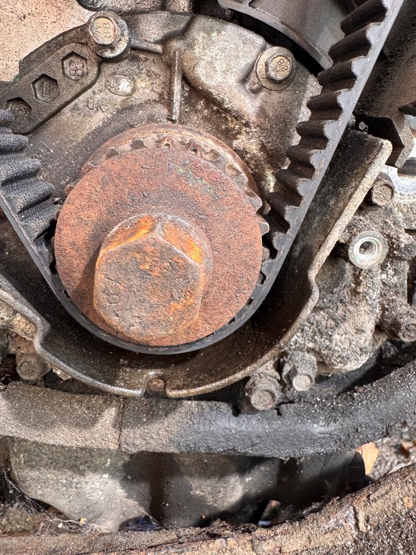

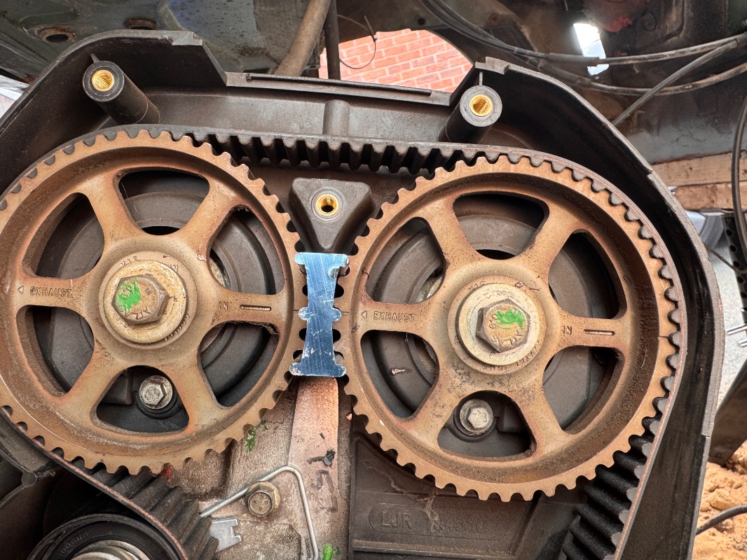

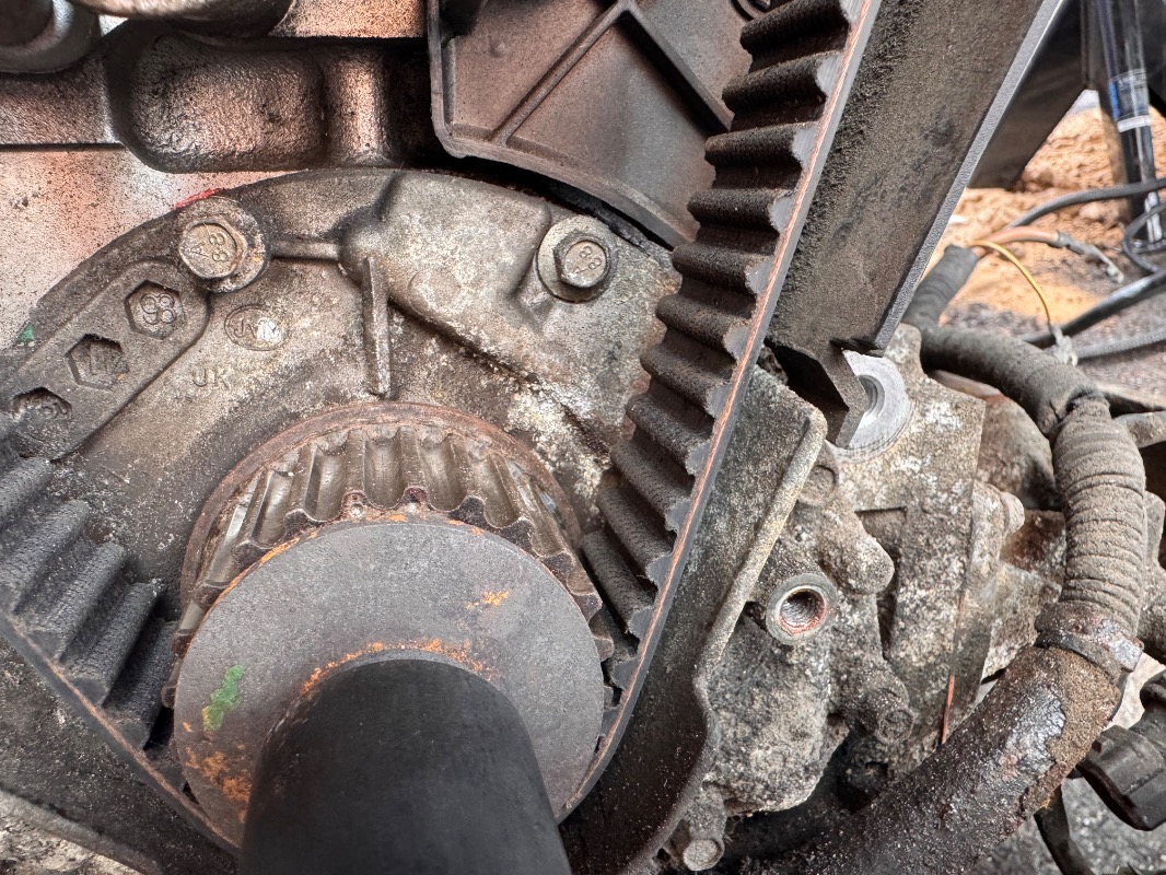

Changed the cambelt today while the engine is out.
the top pulleys line up perfect but the bottom pulley looks half a tooth out.
I used the correct locking tool and the cambelt pitch in the same as the one I took off.
any suggestions?

I went and had another go today and I found a really useful tip.
Roger suggests moving the crank back (anticlockwise as you look at the crank) half a tooth. As the belt is fitted between the crank and exhaust camwheel, the belt easily slots into engagement. When the slack is taken out the correct timing is achieved.
This worked a treat.

+1 for Daedalus suggestion. I took the belt off and refitted it twice trying to get that alignment. Turning the crank back a bit can make all the difference in gettinbg a perfect alignment.
