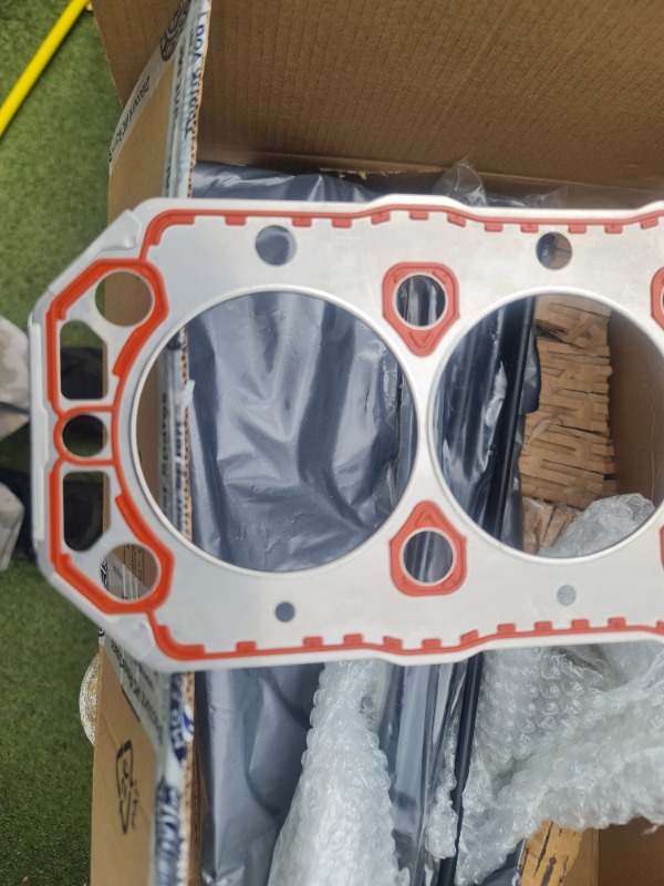

Replied by R40MGF on topic Weird coolant problem
Posted 3 weeks 4 days ago #223967
I strayed from my usual supplier because they didn't have a elastomer gasket listed.
This just looks so wrong to me.
I'm going to give them a call on Monday and see what they say.
Really fed up with the whole thing now 😒
Replied by D4KGP on topic Weird coolant problem
Posted 3 weeks 4 days ago #223972
I see what you mean, yes it doesn't like right to me either. But don't get despondent it'll be ok eventually.

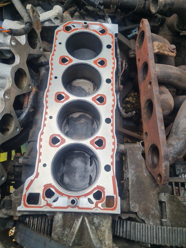

Replied by Cobber on topic Weird coolant problem
Posted 3 weeks 4 days ago #223975
Can you show a pic of the gasket placed against the head?
Posted 3 weeks 1 day ago #224016
I spoke to the supplier and was assured that this was the correct gasket for a TF 135.
I ordered another one from a different supplier and it's exactly the same.
The head is now back on and all of the hoses have been cleaned along with changing the thermostat.
I will probably put a new water pump on due to the amount of crud in system.
