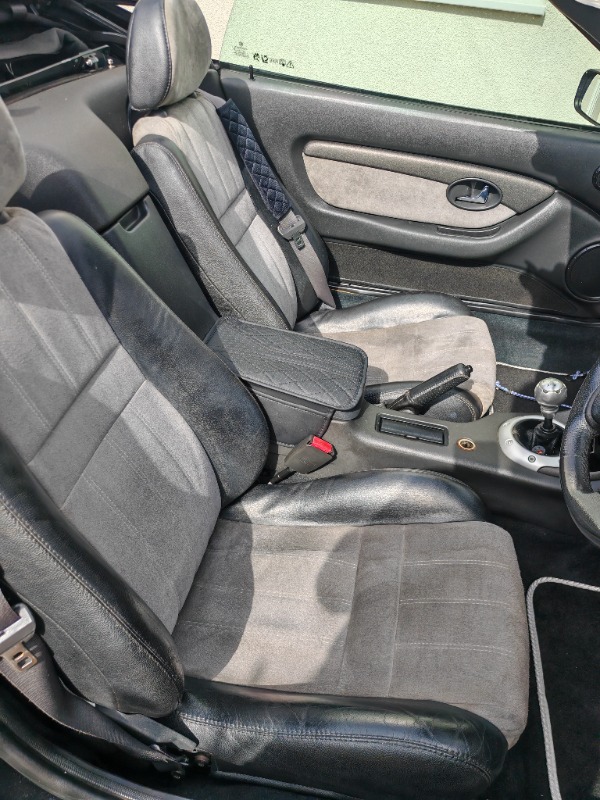

Pektron SCU went off the Technoscan. Paul has sorted the sync issue and changed the SCU relays gratis whilst he was on. New fob and code on its way!! Top class service, just a pig I missed the great weather. I did get my seats and door cards changed and did a brake service so not all lost.
