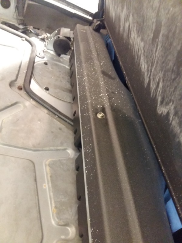

You will need to free the (6 IIRC) clips which hold the trim to the panel behind.  Some will probably break!
You should seem them in the p  icture below:

Replied by D4KGP on topic HOOD REMOVAL
Posted 1 year 6 months ago #210697
They are behind the top facia of the Tbar, they can be a bit of a swine to unclip as quite a lot of force is needed to get them to move, a lot of them will break! Just keep levering it and it will free up. Good luck.
Replied by Notanumber on topic HOOD REMOVAL
Posted 1 year 6 months ago #210703
The clips holding the Tbar on are similar to the things that hold door cards in place. Inevitably one or more will break. I bought a couple from 'Bitz the first time I removed mine - and ended up breaking one of them again the next time I removed it. It will still fit back perfectly ok though with one or two of those plastic clips missing, doesnt seem to need the full set

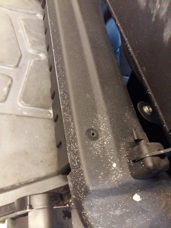

Posted 1 year 6 months ago #210704
    Digcot65
The clips, or where 4 should be, are now circled in red.
