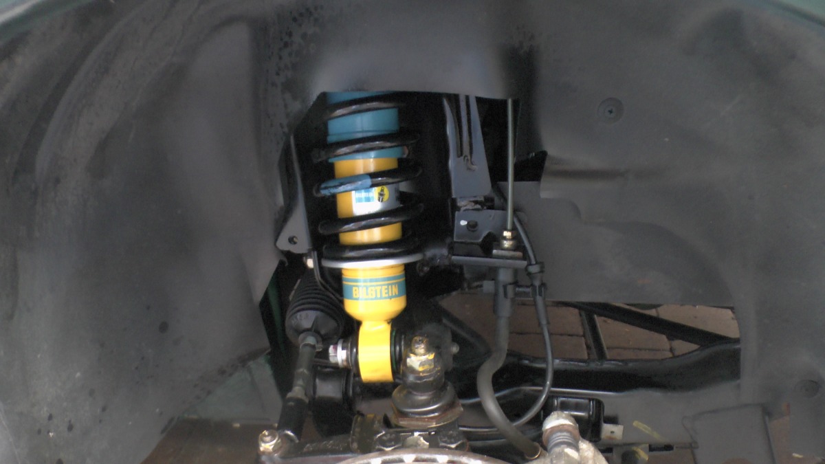

I took a front wheel off to see how things were and -
Any idea what its worth S/H?

Your pic of the Bilsteins saying what are they worth s/h..well changing your suspension will not cure the tin can feel.
If you do sell them I will buy them. They are my next mod.
Do the "deadening" first then you won't want to sell.

TA22GT - I bookmarked your thread in a sticky. Re the Bilsteins - I really prefer adjustable dampers with adjustable seats. I.E. GAZ.
So I very well may sell the Bilsteins but it wont be for a while! What would be useful would be data concerning the wire diameter and number of effective coils for the different springs.
Work out the spring rate from them.

Those Bilsteins look to be from VHS and have grooves in which you can relocate the spring seats from std. by lowering the circlip that supports the seat.
Yours looks to be in the one down from std which is a10mm drop...the same as a Trophy.
