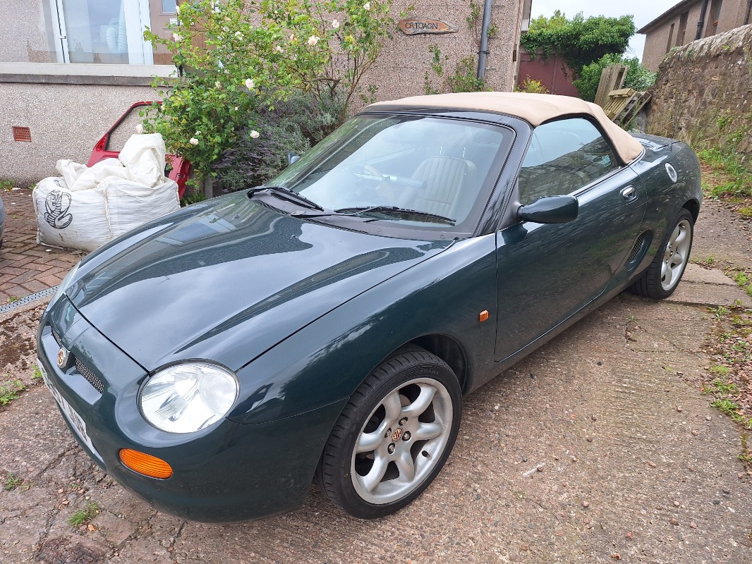

Hi,
Just joined as recently purchased a 98 MGF Abingdon vvc at just over 61000 miles
Great resources here!
Picked the car up from Yorkshire and after a few checks, drove back to Fife without missing a beat.  Been in storage more or less since 2016 (less than 1000 miles since Aug 2016) and has had some recommission work done.  I've got a pile of MOTs and service history with it and the car is pretty much original Abingdon from what I can tell.  We've added around 400 miles (including the 250 mile trip home) in the last 3 weeks and have been really enjoying it, but of course expecting something to go wrong....
All has been fine until yesterday when we lost pulling power above 3000 revs.
Car easily will get up to 5000rpm and sounds absolutely fine out of gear, but in any gear I can't get above 3000 and above 2500 it is a bit lumpy.
As part of the recommission I can see receipts for oil and filter, plugs, but no filter changes!
We've also noticed a metallic rattle on uphill right handers for a couple of days (collapsing Cat?).
Thought we'd start with fuel and air and also look at exhaust - Cat and silencer were apparently done fairly recently although there are no receipts for it in the file, but they look almost brand new.
I have a new fuel and air filter on the way to start with, but if anyone has any thoughts, I'd appreciate an idea of where to start looking.
Head gasket (and cambelt) was done only 3500 miles ago although that was in 2015 - it was caught on a compression test.  I intend to do the cambelt as a matter of course shortly.
Cheers for now
Chris

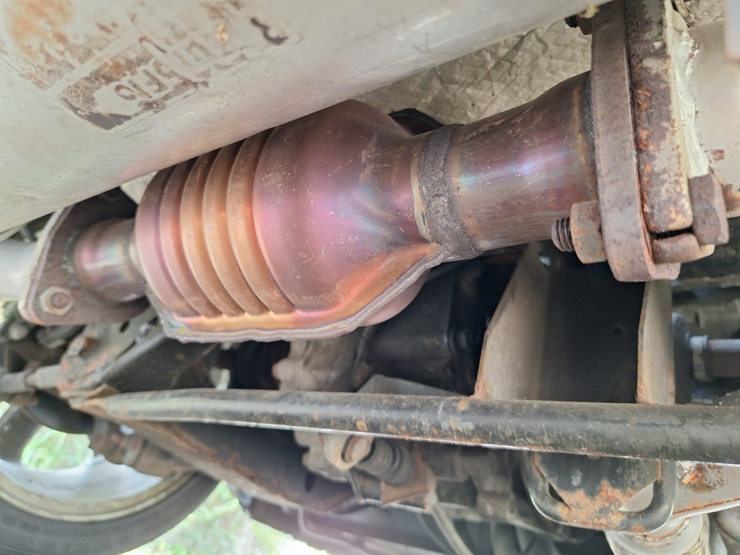

Posted 11 months 2 weeks ago #217686
Sorry to throw a question in but my cat doesnt look like that, there is one on Rimmers like that but it says aftermarket. Mine doesnt have the ribs.
