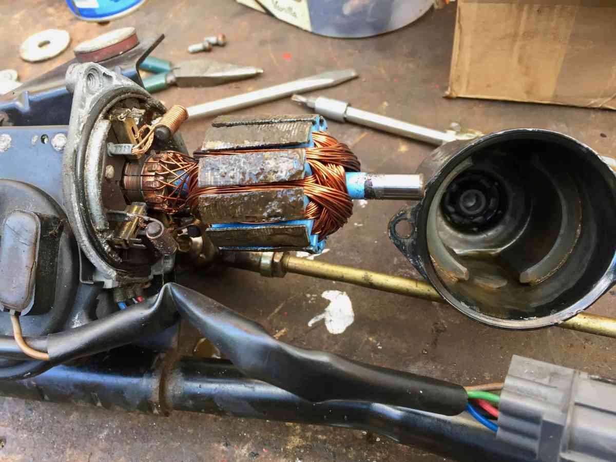

Removed the motor cover and out fell about a tablespoon of water. Cleaned it all up and sprayed it with SGB and got some waterproof white grease into the gearbox.
It's now much faster and quieter.
The cover is retained by two Torx screws, take those out and pull the cover off. There is quite a strong magnetic field that will try and pull the cover back but don't worry just pull it off. Clean everything but do not mess with the 3 little brushes at the bottom, they are delicate. Give the commutator, that's the segmented part the brushes touch, a good squirt with SGB (WD40 will do at a pinch) and put some waterproof grease into the bearing at the bottom of the cover and reassemble.

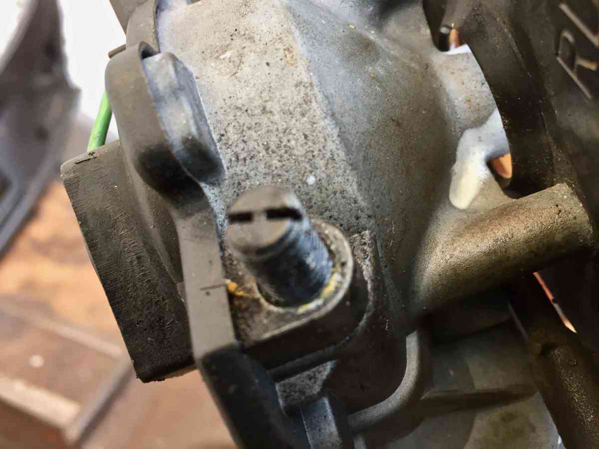

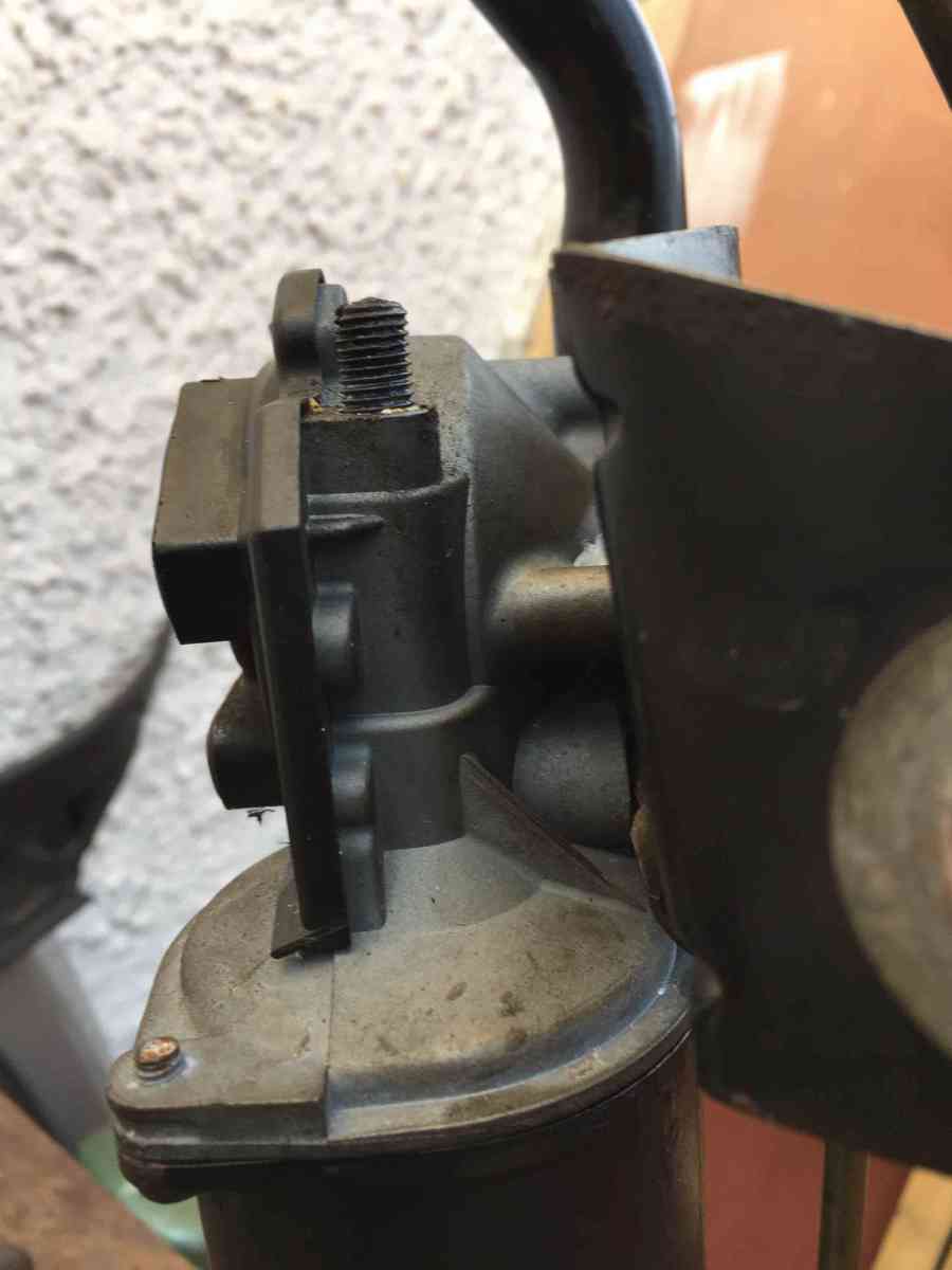

At the other end of the motor is a small plastic end-float screw, take this out and squirt some waterproof grease down the hole, re fit screw and nip it up very lightly then back it off by about 1/4 turn.
The screw has a 'split slot' head but a very small screw driver will fit one of the two slots or better still is a pair of small circlip pliers.

Mine was filled with rusty water......scraped that motor.

My original was actually full of rusty brown water and the commutator had disintegrated!
