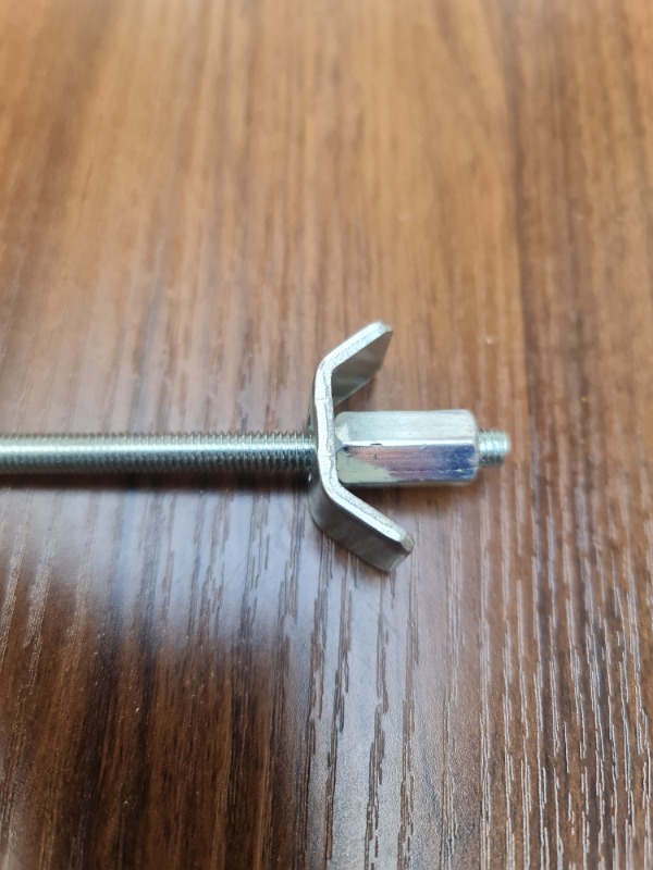

When I was doing the cambelt on the TF I found that the alternator adjuster was snapped so I as I didn't have a replacement I drilled the original out, re tapped it, and fitted this from a kitchen worktop joint.
Seems to work fine 🙂
