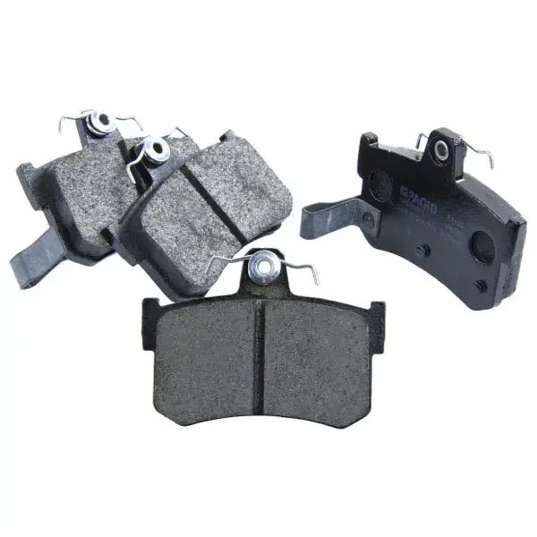

Here is an official photo from the Pagid website showing the rear pads with the tabs i refer to. As you see they are handed and so it is perfectly possible to assemble the pair of calipers with the tabs either at the bottom or the top of each assembly depending on which one was selected for the first caliper chosen for service (left or right).
So I believe my question still stands. Which is correct and why? Tab at the bottom or the top.

They can be fitted either way. I believe mine are at the bottom. They will do the job either way.

They should not be placed either way. Only one eay is correct.
Wear sensor is placed on inner side due to fact that piston is on that side and that side wears slightly more and faster.
Further wear sensor must be put on leading edge. This means wear sensor is placed at bottom. Why - because due to way of rotation of the disc when disc first contact breaking pad you want for the indicator to be there in order to push indicator against the rotor rather then getting it snagged or bent backwards. That way loud, consistent screech is guaranteed.
