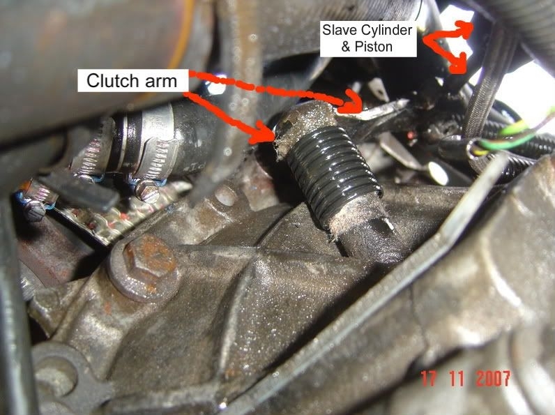

Replied by David Aiketgate on topic lubricating clutch release arm
Posted 1 year 6 months ago #210598
Long long ago in a galaxy far far away, a clever chap devised a clutch arm lubrication system.
Basically some oil soaked fabric in convoluted plastic trunking.
Replied by Airportable on topic lubricating clutch release arm
Posted 1 year 6 months ago #210603
Clever & easily instituted, I’ll think about that, that is until I forget.
