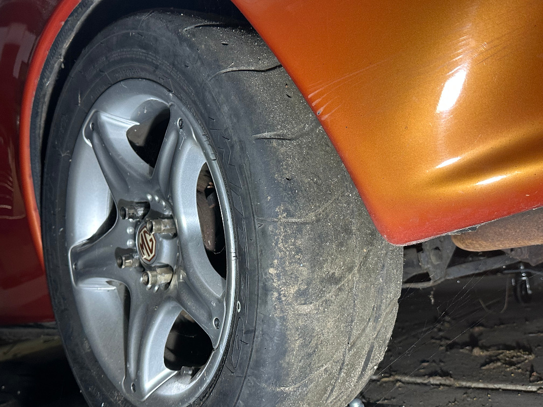

Good afternoon all, I've just gone outside to jet wash the new wheels (managed to get some Ultralights) which came with tyres (great considering my fronts are stamped 2010!!) I believe all 4 are non directional as I can't see a roll direction arrow and they're not an arrowhead design (Falken Ziex ZE310) which means I can put them on either side of the car right? Even though though there does seem to be some angling to the tread design...
HOWEVER on closer inspection of the tyres already on the car I noticed the fronts are directional (Toyo Proxes T1R) while the rears are not (Toyo Proxes TR1)... Surely they should either all be directional or all be nondirectional right?
Anyone able to shed any light here?
Basically two questions
1) do my falkens need to go on specific sides based on the tread angle?
2) is the Strange Toyo TR1/T1R setup it already has a mistake or is that normal? (In which case do in need directional fronts)

As far as I have been able to google the Falken Ziex ZE310 tyres are non directional so can go on either side.

I’m sure that Roger Parker (MGOC tech guru - now retired) wrote an article on the right tyres for these cars. The findings were that at the extremes tyres of the same brand/model needed to come from the same factory. In other words the compound in the tyre needs to be the same front and back. Based on that it would seem to be wrong to mix two types of Toyo tyres between front and back.
That is backed up by other research where a particular tyre of the same name and brand had to have its tread ground down by the manufacturer to achieve the same performance as the tyres that had worn out. Reason- tyre manufacturers respond to changing weight of new vehicles and change compounds for the same model of tyre to reflect the market requirements. Block pattern and compound all have consequences.
