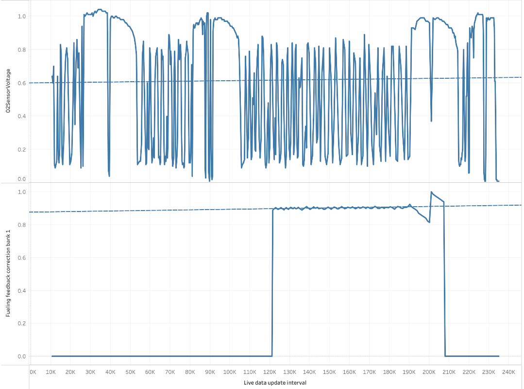

Using the P-Scan log I've verified the o2 sensor appears to be working correctly. Interestingly the trend line value is 0.629 volts which is very close to the reference voltage from the ECU so I'm assuming the fuelling is responding correctly to hold it around that voltage.
The high voltage points are where I've increased the engine rpm to 3000 to see how it responds. But at this point the Fuel Correction Bank 1 is reducing from 90% to ~80% so again I'm assuming it's reducing the fuelling to maintain the correct lambda value.

Fantastic piece of work.Using the P-Scan log I've verified the o2 sensor appears to be working correctly. Interestingly the trend line value is 0.629 volts which is very close to the reference voltage from the ECU so I'm assuming the fuelling is responding correctly to hold it around that voltage.
