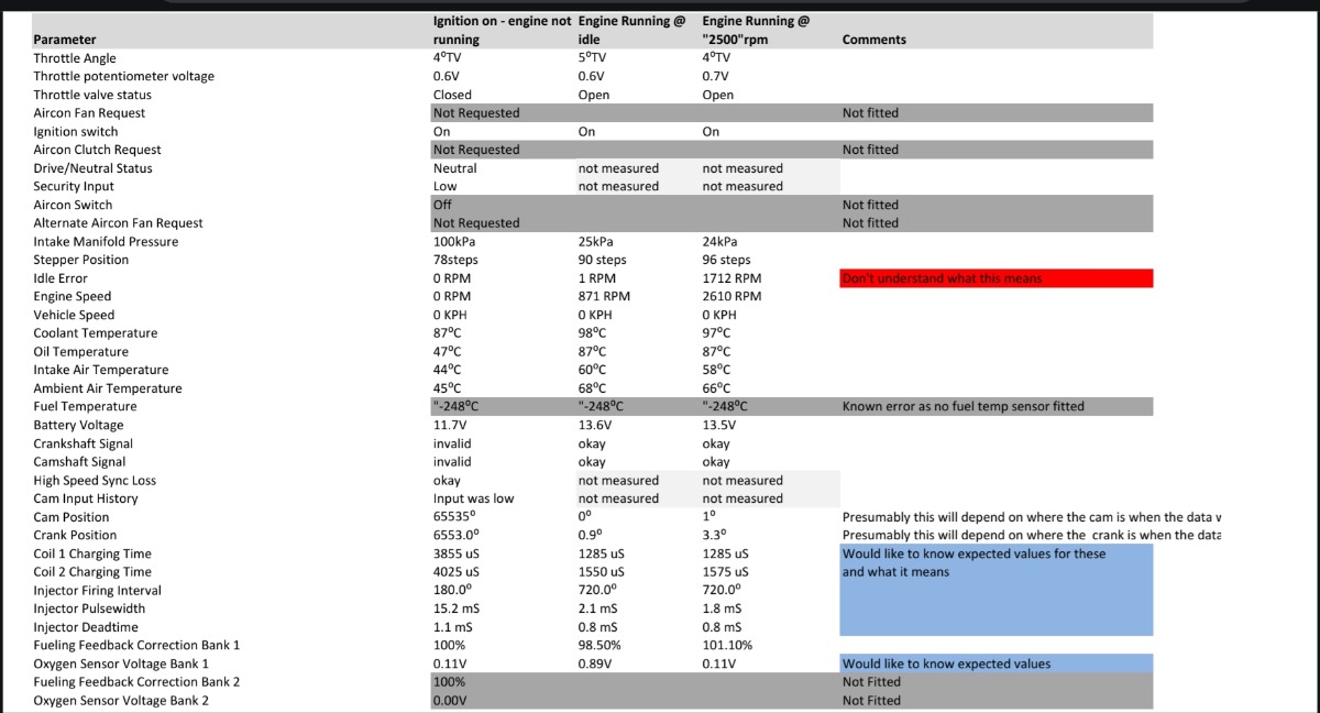

Hi guys how do I find a full list of what each point using my pecan.uk unit should read so I have a starting point
reading it I don’t know if the numbers are ok or a problem
thanks Andrew

Having recently acquired a Pscan myself, I think a chart with target values would be useful. These aren’t cheap OBD2 bargain basement eBay units, one of which has served me well with other cars I’ve used it on, the Pscan is a jewellers screwdriver as opposed to a clunky old thing used to prise the lid of a paint pot & to have a reference point to which you are anchored would help.
I appreciate our cars & this device are only a part of the Pscan remit but one of our numbers who is well versed in its parameters might put shoulder to wheel to help the less talented.

This is what I found for MEMS 3 some time ago when I was looking for reference figures, can’t remember where now.

Of course such reference figures may well be different depending upon the level of specification and the year of manufacture of the car in question.
One size may not, in all probability, fit all.

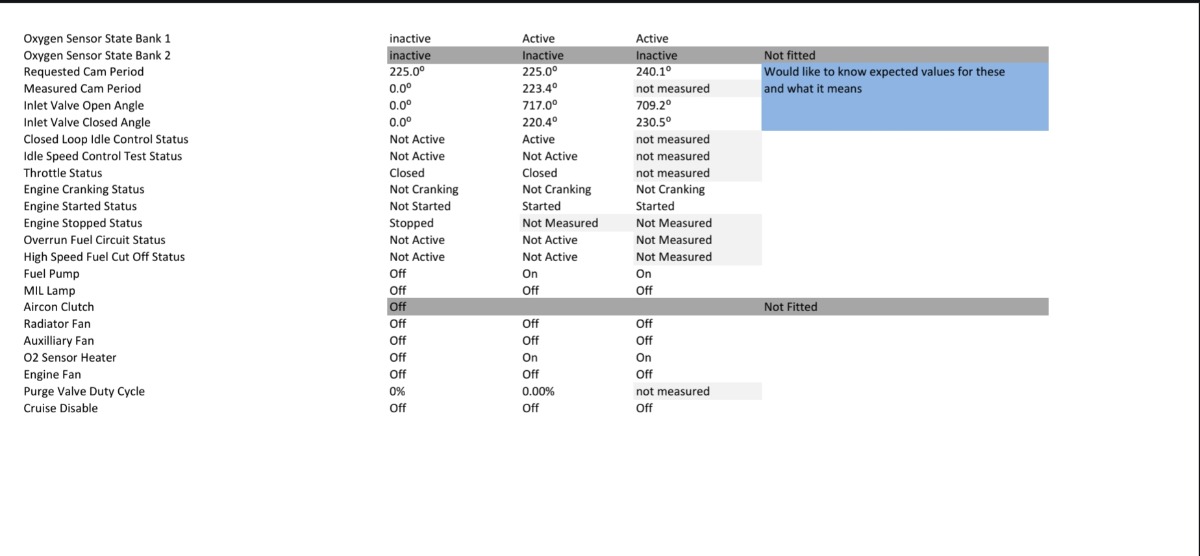

Here are the pdf pages.
thanks Andrew
You would have to find another identical vehicle, which you consider to be running well, plug pscan into it, select data logging, go to live data and select all parameters.
After a few seconds stop the live data, and you will have a file with all the numbers that it collected that you can open in a spreadsheet program such as Excel or LibreOffice.
