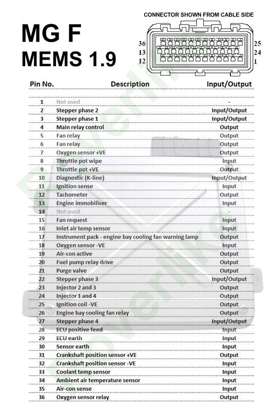

MG F/TF - MEMS 1.9, MEMS 2J, MEMS 3 pinout
MG F/TF - MEMS 1.9, MEMS 2J, MEMS 3 pinout was created by Roverlike
Posted 1 year 3 months ago #213032
by Roverlike

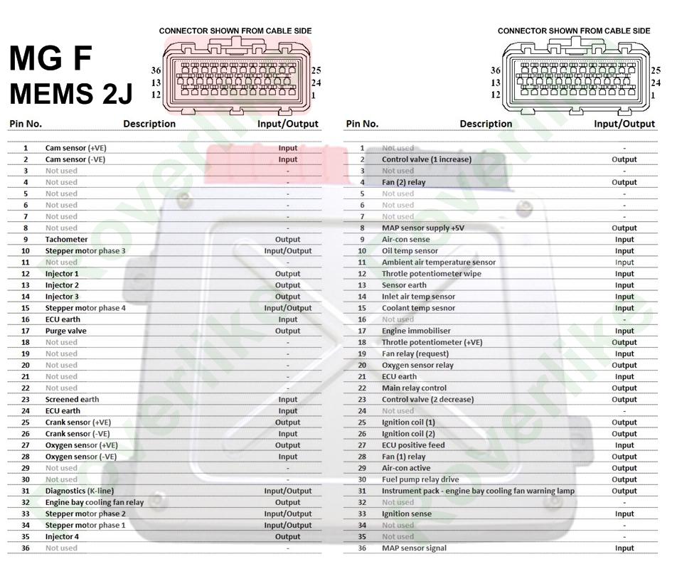

Replied by Roverlike on topic MG F/TF - MEMS 1.9, MEMS 2J, MEMS 3 pinout
Posted 1 year 3 months ago #213033
by Roverlike

By jingo. That is the last word on K-series engine management. Amazing.

My word that’s a chunk to chew on! My workshop computer died yesterday & I won’t get it back until tomorrow & as these charts demand looking at on a decent screen, these will be the first to be viewed. Don’t expect many posts whilst these are studied.
