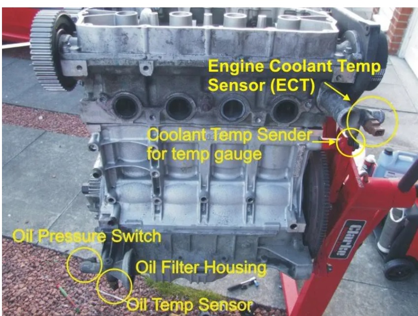

You also mention a "Hot running issue" > Be aware that the temperature gauges are notoriously inaccurate, and get worse with age. If the gauge has always moved to the same place, and stays stable at what looks "too high", it MAY just be a poorly calibrated gauge and/or sender. There are TWO senders, one for the ECU, the other for the gauge.
