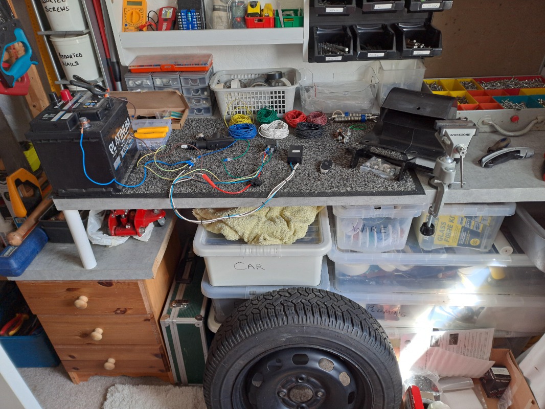

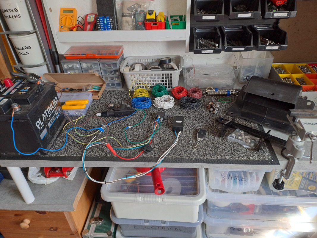

i`ve been test wiring a remote boot popper this weekend .... seems to work well  and have new wire, warerproof conectors read to do the real fit .
I also got a never used spare wheel for £25 too.... and a snorkle and servo brace.... I hate buying new( used) cars as I always end up spending on things that are not really needed lol

Do consider the security aspect with this type of popper. There is scant security with them & it isn’t unusual to have two or more transmitter/ receiver combination which interact with each other.
You can buy different looking items from several sources & find you can open A with D,B or C. This only detracts from their facility if there is a significant security implication; I have a few to operate devices, including my boot lock, however if there is to be anything of value stowed & the vehicle is to be left I can lock it out. In fact I could lock it out by using a second receiver wired into a second channel; a small disable switch to cut the power supply is a much safer bet.

I never leave anything in the boot and only do about 500-800 miles a year , so the chances of anyone opening it will be slim to nil , if they do there will be nothing in it  i`m going to wire it to only be live when the car is unlocked  and will have a hidden isolator switch too. also the interior is even easier to get in , you just need a knife or a pair of scissors lol

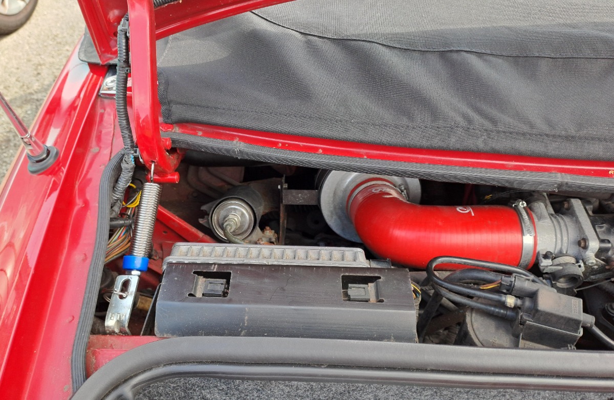

Yes that is what anoyes me, Ive just put one of those springs on to lift it too , only set it to open half way  as I didnt want full tension on it and was a bit awkward finding a decent place for it to work as usualy they go under the parcel shelf . I`m going to put a rubber sleave overs it  and shield the wires to the left which i have alread tucked up closed to the body  , incase it snaps , it is made in China after all
Last Edit:11 months 1 week ago by Mark63
Last edit: 11 months 1 week ago by Mark63. Reason: my poor spelling , well the ones I spotted..
Replied by Airportable on topic remote boot popper
Posted 11 months 1 week ago #217864
I like your spring arrangement, it’s quite inspired. I fitted gas struts; I wanted to pop the boot & for the struts to slowly & regally open.
Having sorted the geometry out I found that the strut was lying over centre, forcing the boot closed when the boot was popped.
The inclusion of a spring such as this, might help reach my initial thoughts.
