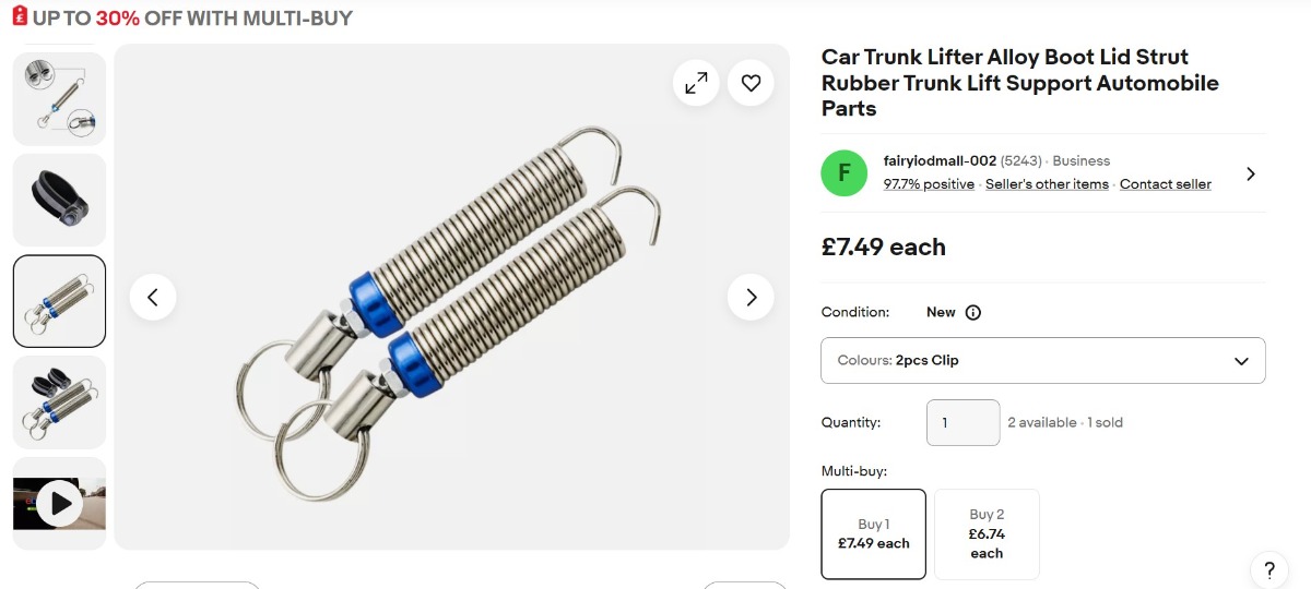

I’ve just found them on eBay, there about £8-00 a pair. I typed “car boot lift springs” & I was straight in. I’ve to take my granddaughter home now, so I’ll do a bit more research later. I doubt anything better will pop into the frame.
That`s where I got them from and at that price, I only used one . and I had the strong L bracket in my assorment .

I like that spring. Do you have a link to it please ?

I eventually bought a couple for £5-50, these were without the clamps. They wouldn’t be used in any case & as out friend comments the likelihood of two being required is small.
Thank you for that tip, even if isn’t a success I’ll end up with a couple is springs, which might form the basis of a high power catapult to knock those bastard magpies out of the sycamores.
