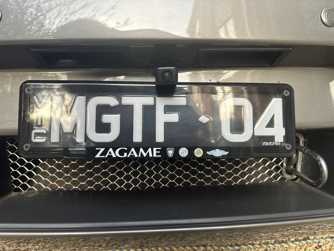

The Pioneer reversing camera works fine ( see my post about Best Radio for MGTF). Yes you have to drill a 5mm hole for the cable plus a couple of 3mm holes for mounting screws but they are in a hidden area above the number plate.

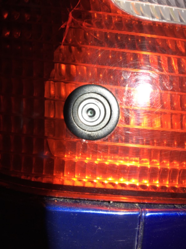

I fitted two cameras & can switch between either, they are fitted in the rear lamp units & are very effective, one you become used to them. They are, after all, viewing from an unusual angle, one which is counter intuitive.

Airportable, (#223184) that is a very interesting solution. Based on replies you have given to other topics I get the impression that you are somewhat of an expert in electronics or competent to say the least.
So can you please indicate what sort of arrangement you included to facilitate the switching from one lens to the other, and it might also be interesting to know what size screen you are using to view the video on (is it for example your phone, the car’s radio with a large pull out screen, or part of the rear view mirror system?).

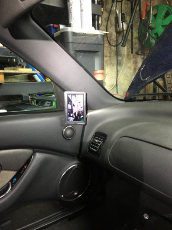

From tiny acorns!
I had been asked to build a “cat flap monitor” to ensure my friend was feeding his own cat & not being burgled, nightly, by the neighbourhood moggy & I had some oddments left over in the workshop.
A person or persons, unknown kindly smashed my wing mirror off the car, sending it a good way towards Yorkshire. I thus jury rigged a 5” mini monitor to the inside of the car & a miniature camera on a bent up bracket outside, until I could order a replacement.
I had tested the basic system in the workshop & noted it on here, to which our dear friend Cobber made some pithy remarks.
I have complicated my system unnecessarily, but that need not be done for successful results.
As can be seen from the pictures there are a o/s system & a n/s as “door mirrors” which can be switch front to rear or a left / right transposition.
Because the video cameras are all composite out & have a healthy signal, at a low impedance (75r), switching can be done using reasonable quality miniature relays.
I have a single momentary switch which, once pushed, cycles through the steps to view on the o/s monitor the camera most suited to my requirements.
Switching is performed adjacent to the camera to minimise the cable runs, plus it was an easier option to hide those twiddly bits behind the rear lamp covers, for the rears & in the door void for the front.
A few pictures might help.
