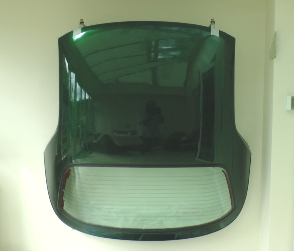

My wife must love the strange green thing.  Whist musing where to put the hardtop she suggested "hanging on the wall in the conservatory.  It will be safe and out of the way there."
I didn't think to suggest that as I would give money against getting away with it!  Amazing -  just shows.

My wife must love the strange green thing.  Whist musing where to put the hardtop she suggested "hanging of the wall in the conservatory.  It will be safe and out of the way there."
I did grab that offer with both bloody hands........don't let her have time to change her mind!
The following user(s) said Thank You: VinceR
Replied by VinceR on topic Hardtop - suspending from garage roof???
Posted 3 weeks 4 days ago #223973
Done!
She will probably put flowers around it and change it into a display of some sort.
