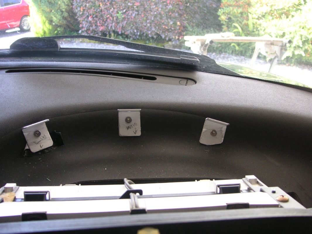

Well, ever so near but...!

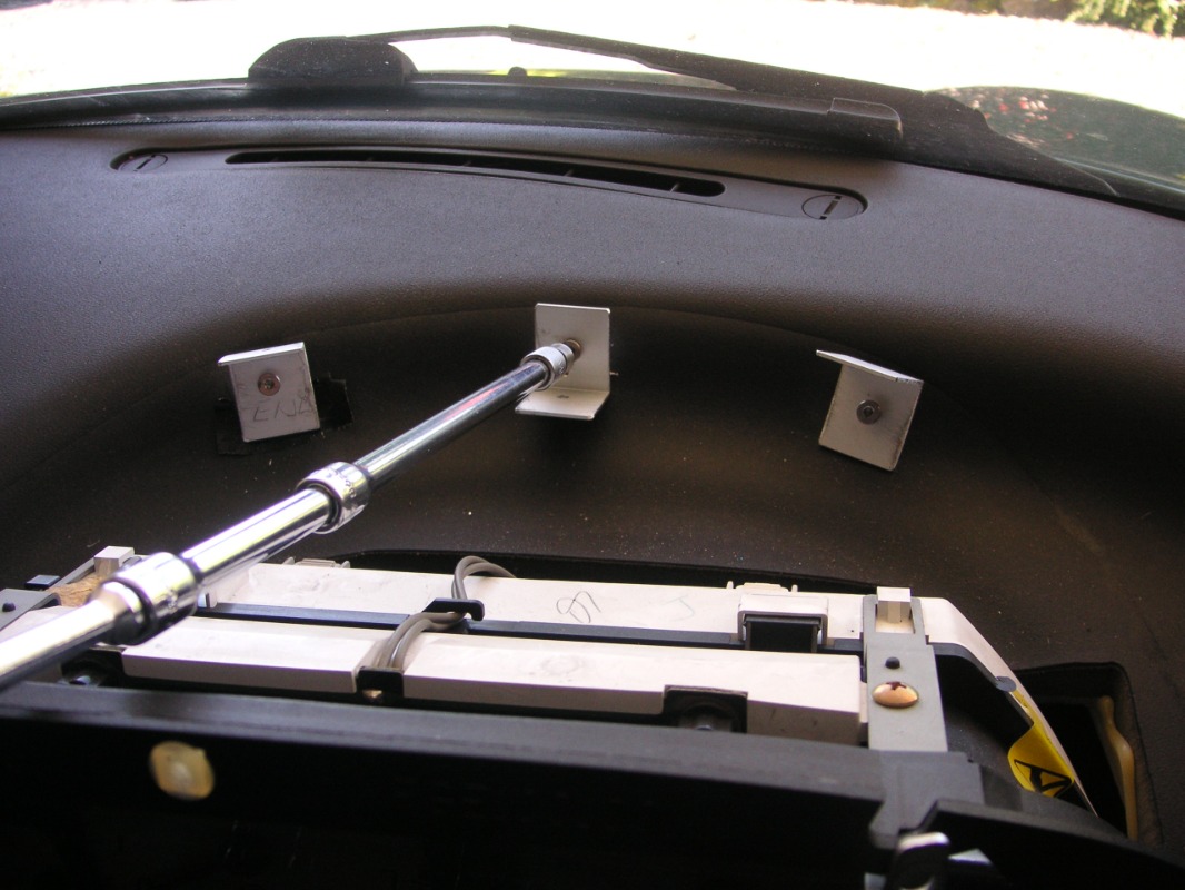

I managed to remove two out of the three failed clips that were still in the dashboard. The third was a child of dubious parentage. I had to grind the tip of the screw off and weaken the clip. Recovering them through the vent was doddle. Re fitting the vent was easy too after renewing some foam around the ductwork.
With the three clips out I bonded in three rivnuts using 2 pack JB weld repair plastic glue. So far so good.
I then cut and shaped three aluminium brackets from 30mm equal angle material and reduced the 90 degrees to something close to requirement.
With those brackets in place and nearly tight I bonded the binnacle to the angle brackets. If the perishing binnacle had not slipped a bit over lunch whilst the glue set everything would have been perfect.
So, after lunch I removed the binnacle (unscrewing) the brackets that were now bonded to the binnacle, and risked everything by trying to cut through the glue to re bond the binnacle in place where it should be.
Unfortunately the perishing thing cracked (told you so I hear you say) but not too seriously so I had to overcome that by just renewing the glue and then re attaching the binnacle using some "P" section elastomer that I had in my spares bucket.
All in all it doesn't look too bad, it has cured the rattle and I would adopt this approach again if I had another spare binnacle.

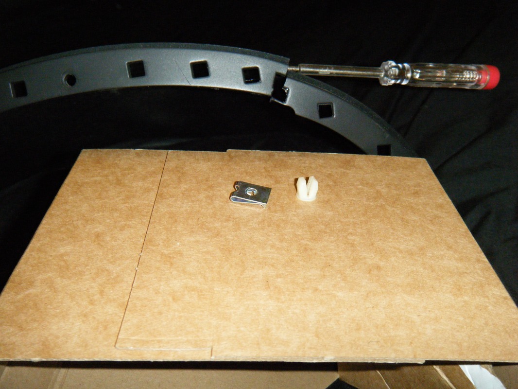

All being well attached are two images. One shows the screwdriver assemble all stuck together with gaffer tape. Yes it is resting above the arch but that was only for demonstration purposes. It was just possible with the screwdriver between the arch and the top of the instruments.
And here is the other

I replaced them with speed clips glued inside the rim with contact glue, the originals can cause the binnacle to split in that area.

Use of those white plastic retainers were a poor design as they inevitably crack the square holes they fit into which can spread to visible cracks along the top of the binacle

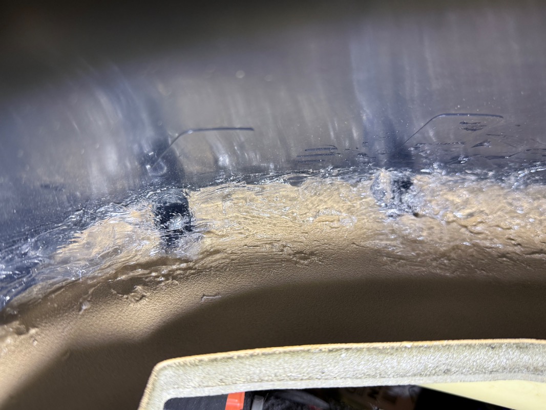

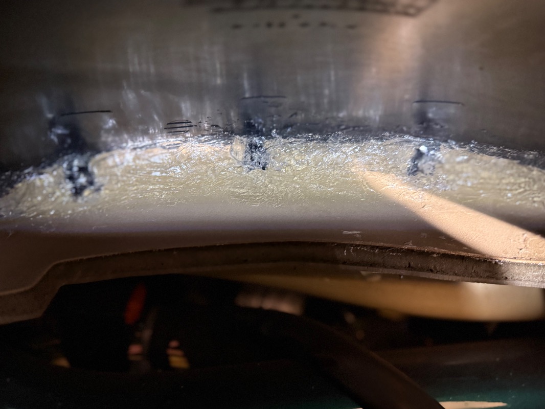

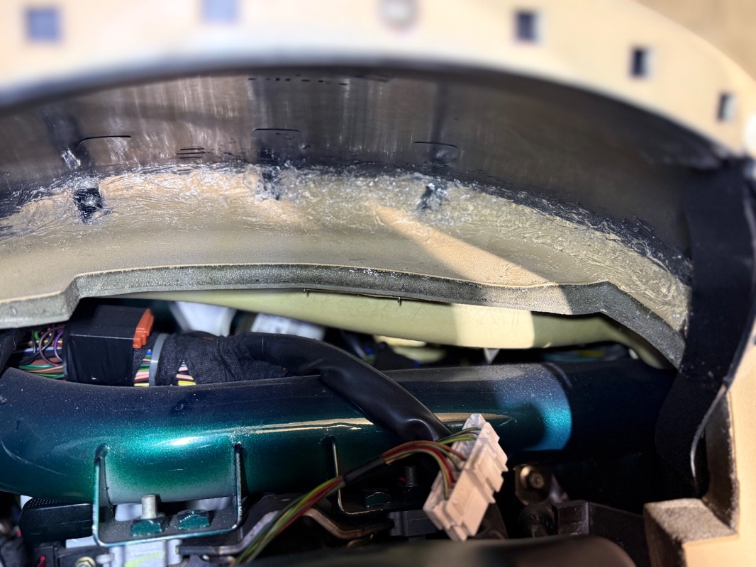

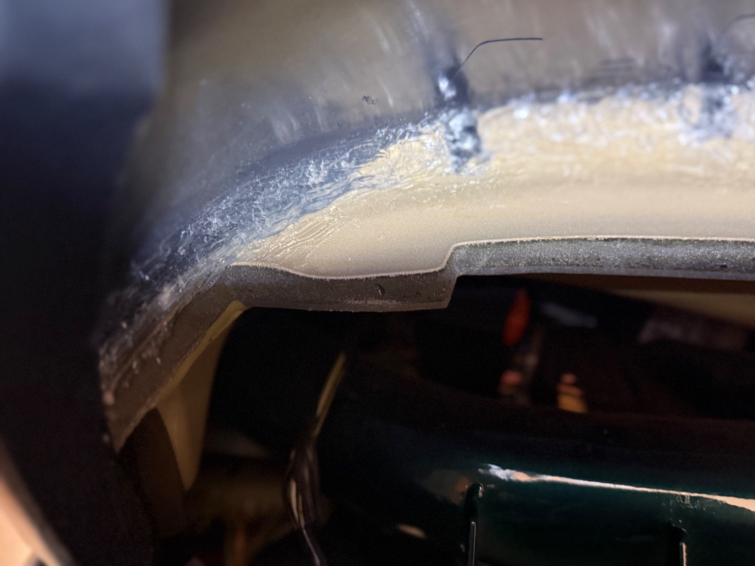

I know this is an old post but I wanted to share my recent experiences with my instrument cowl repair.
My tabs finally gave up the ghost and the cowl was showing early signs of rattling.
My solution was to use a flexible ‚poly‘ glue  (UHU Poly Max). I have used this type of glue before for other interior trim and it holds well. I tried several other types in the past and have found that glue that dries hard tends to eventually snap off. A more flexible glue when dry seems to work well.
I did several layers. I obviously glued it from the inside. I placed some heavy books on top of the cowl to keep it pressed down when it was drying.
The results turned out very well and the cowl is now very secure.
I took some photos of the repair but do not seem to be able to upload them. I get an 'upload failed' message.
In regards to the cracking of the rear part of the cowl and the white tabs (i.e. the end closer to the driver), my impression is that this is the result of not repairing the cowl when it first comes loose. The 'bouncing' from the front of the cowl eventually causes cracks where it is still secured in the rear.
