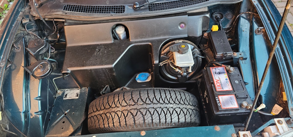

Replied by Alec on topic Mike Satur Brake servo bracket
Posted 1 year 1 month ago #215057
Mike this is the setup i have i believe i'll need the snorkel if i can find one i looked on Bitz and they only have new at £50 and ebay 2nd hand people still want upwards of £25 maybe someone on here has a snorkel setup they'd be willing to sell, i'll put a wanted post up, the brace is cheaper on Bitz and looks so much easier to fit with no drilling etc so will be looking at getting that one. many thanks for pointing me in the right direction

Replied by Devinci on topic Mike Satur Brake servo bracket
Posted 1 year 1 month ago #215087
i have a picture but is from my LHD .
by Devinci
