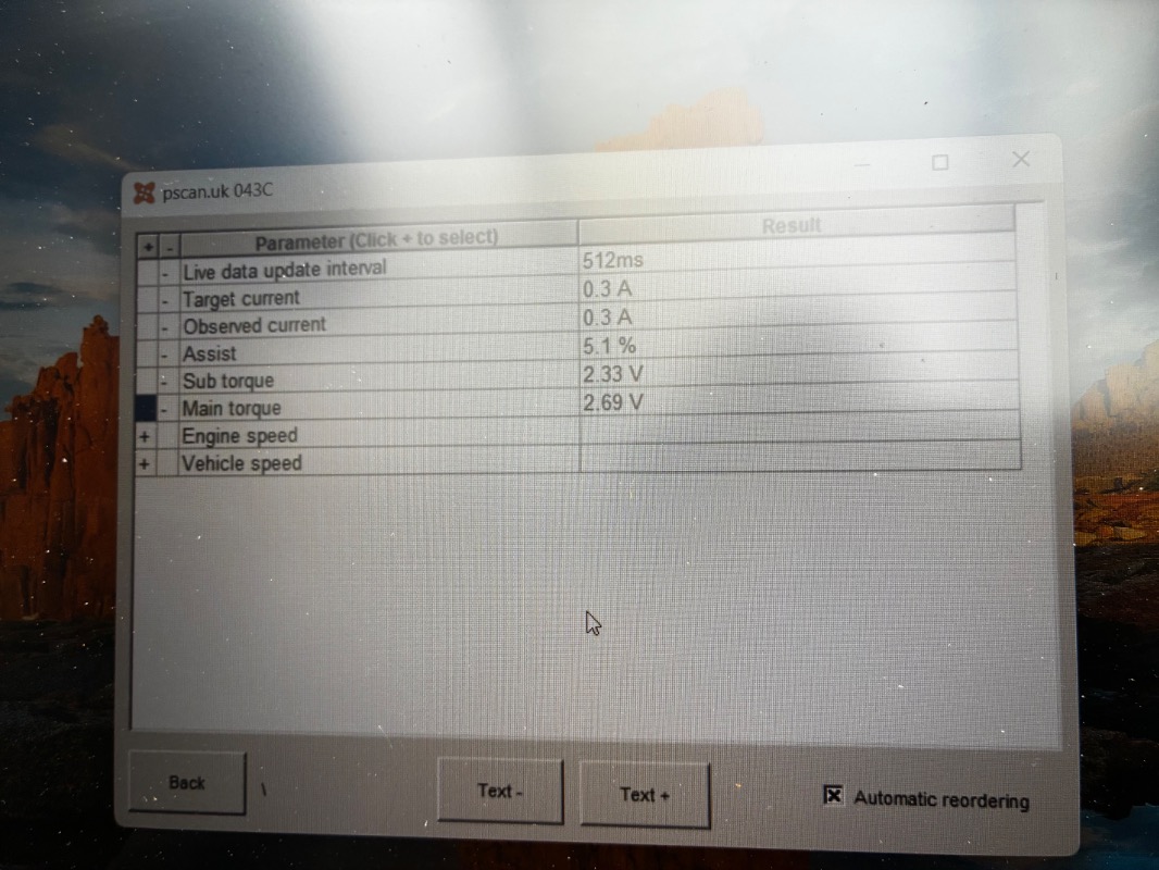

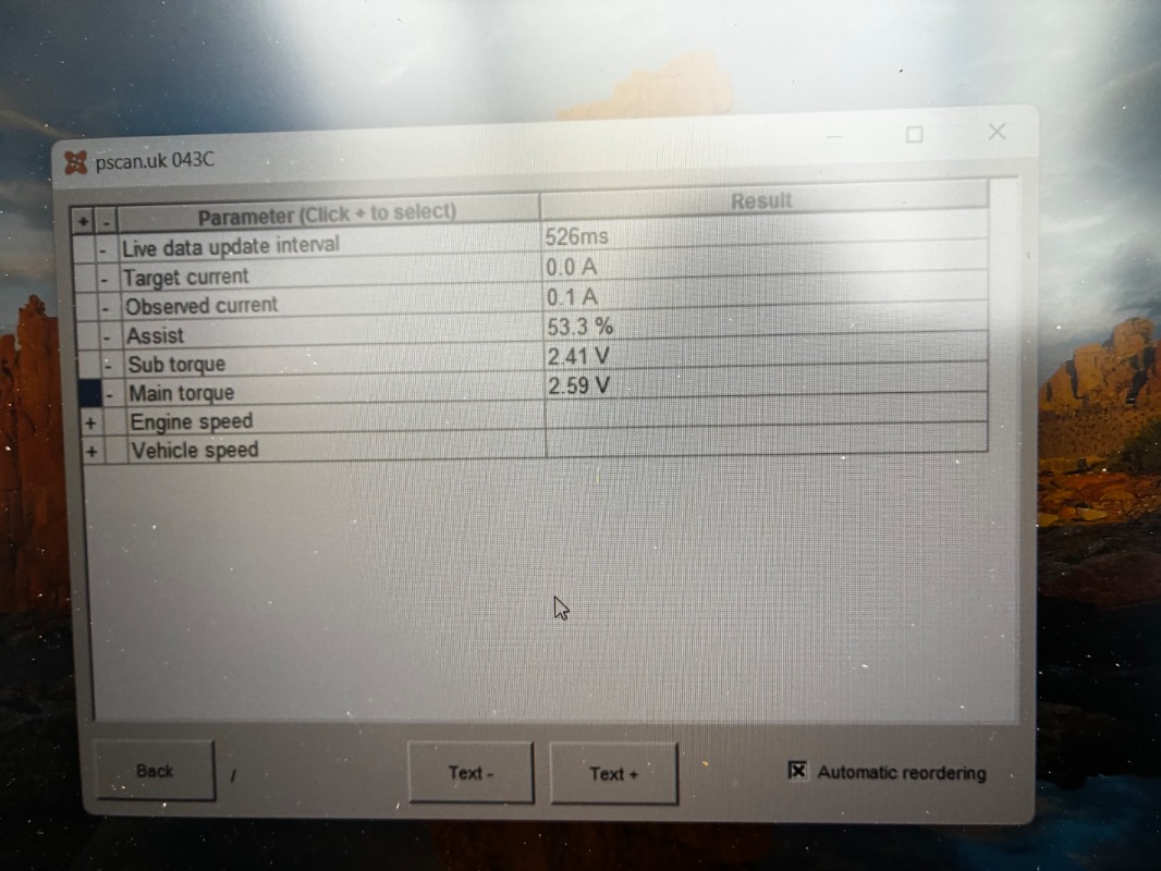

As I understand it the Pscan assist value should be low with the steering wheel stationary in the straight ahead position. Also the target and observed current values also 0.
The best I can get is the current target and observed low 0.3a and the assist % low or I can get 0.0 target and 0.1a observed but the assist percentage is over 50%. Photos show both sets.
Please can anybody advise which is the preferable option? I’m going crazy fiddling the sensor  back and forth and don’t want to reassemble until sorted.

my understanding is that the sensor reacts to force rather than position.
Basically (by my understanding) you are looking for the smallest "Target current" when nothing is touching the steering wheel
