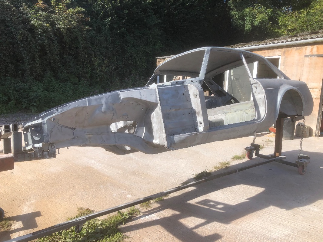

 Crushed glass is a first class media for “sand” blasting. I bought a tonne of superfine glass media and apart from the whole of the GT rod friends used it to clean up a 30 foot fibreglass hull prior to some repairs and repainting and about half of the topside of a classic Mini. If I was doing it again I would use either fine or medium grade. I am sure that the sand is like the glass in that it does break down to finer and finer particles. I probably recycle about four times, using the last usage for less demanding areas. The upside of crushed glass is that there is zero risk of silicosis. The photo shows the GT on the rotisserie after being blasted.
