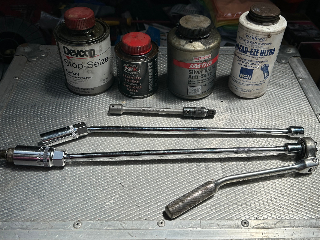

1st things1st always use a good anti seize compound on your spark plug treads, brush some on the plugs before you install them.
Use a proper spark plug socket some have a rubber boot to retain the plug in the socket, but I prefer ones that use a magnet to stop the plug from dropping out, it doesn't  sometimes pull out of the socket staying stuck on the plug insulator buried deep in a recess like rubber ones can.
The brand I use is Ampro.
The ones I use the most have a swivel at the top of the socket that is permanently attached to a long extension bar. this bar being permanently attached wont leave the socket on the plug when you are installing it, leaving you trying to figure out how to recover the plug socket hidden deep in a recess!
These integrated extensions aren't always convenient in confined spaces so then I use a separate socket and a shorter extension that has a locking collar that keeps the socket locked attached to the socket until you pull back the release collar. this means you can always recover your socket.
For a ratchet handle I use one made especially for spark plugs, made by Champion (the spark plug company) the part number is CT500 these are designed to get in where others cant. I don't know if you can still get them, as I've had the 2 of mine for over 30yrs!
Pictured are various anti seize compounds I use depending on application and the plug socket and locking extension described above.
Don't waste you time on bloody great 1/2" drive sockets for spark plugs, you shouldn't need the strength and certainly don't need the bulk of those monsters, 3/8" drive sockets is all you should need.
When installing I start the treads by hand where possible and screw them all the way in by hand, only using the tools to nip them up.

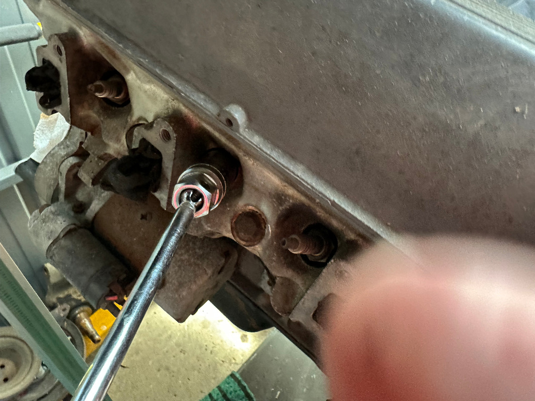

But if the plug holes are heavily recessed I might use the socket and extension to carefully screw in the plug by hand and only put the handle on to nip it tight.
By screwing in the plug by hand you can easily feel if it's not treading right, so you stop, back it out and try again. but if you do it with a handle you risk damaging the thread before you realise you have a problem!

Pictured is the installation of a plug in the head of a Leyland 4.4litre V8 using the socket with integrated swivel and extension by hand, not that this engine need it as the plughole aren't in deeply recessed pockets, I chose this engine for the pic as it is easier the show what I'm doing as the plugs aren't deeply recessed!
Another method of installing deeply recessed spark plugs is to use a bit of rubber hose slipped over the insulator of the plug and use this as a handle to hand screw in the plug, then as above use the tools to nip up the plug.

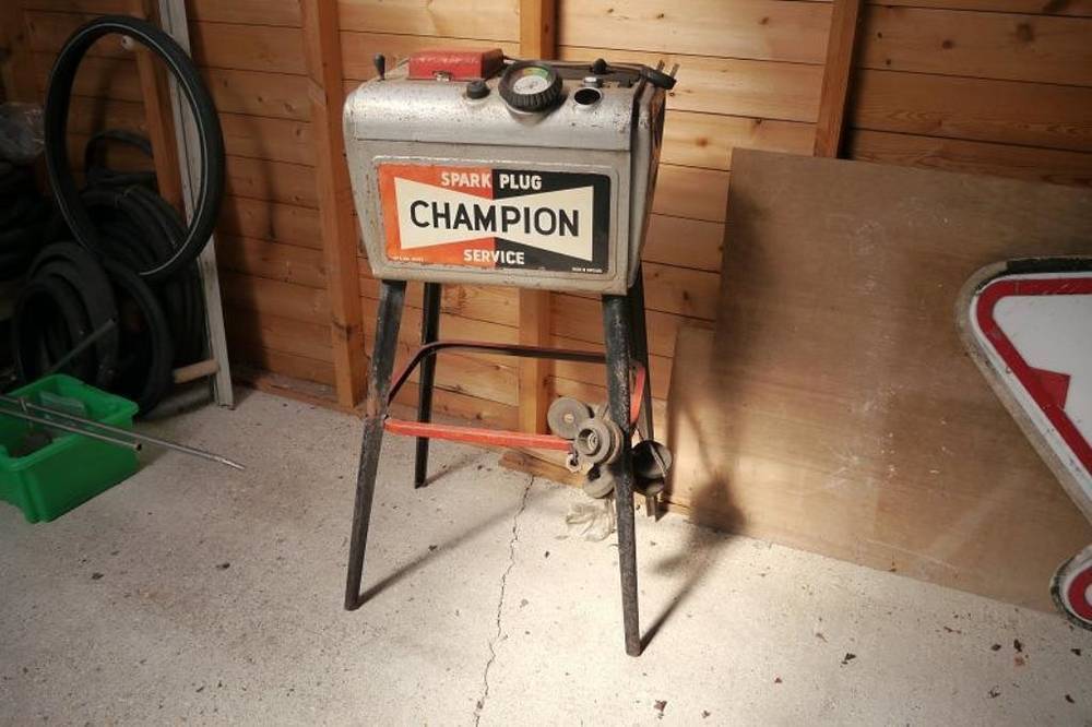

Remember the old Champion Spark plug machines, every mechanic's shop had one, they would grit blast the plug to clean it and they could be used to test the plug too.
Back in those days the centre electrode was solid and could withstand such rough treatment, but plug technology moved on to copper cored centre electrodes etc. and even more exotic materials such as gold/palladium and platinum. Plugs of these types wouldn't tolerate such treatment, the removal of lead from the fuel and the fact that it became more cost effective to not bother spending time buggerising about with plugs and to just replace them instead. All these factors conspired to render the poor old Champion spark plug machine obsolete, and the survivors lay about as display pieces of garagenalia for collectors. There are even collectors of vintage spark plugs, these guys avidly seek out NOS plugs from ancient workshop clearing sales, and swap meets!
In fact it probably sat next to another blast from the past, the Churchill Hydralastic suspension machine in the 1960's workshop!
Replied by David Aiketgate on topic How not to bugger up your spark plug threads
Posted 1 year 6 months ago #210628
 Ah yes, a prototype Dalek.
Replied by Cobber on topic How not to bugger up your spark plug threads
Posted 1 year 6 months ago #210629
Yeah they do resemble something the BBC props department cooked up for DR Who.
Even though such a device would still be relevant to us MGF owners, they are by and large obsolete. The problem with these things is that you had to take the car to them, as they are a bit too awkward to move about, which would mean a game of automotive musical chairs would ensue every time you needed it.
Resulting in the disruption of having to move cars about the crowded busy workshop, it's far more convenient to use one of the more modern portable suspension pumps and carry it to the car.
