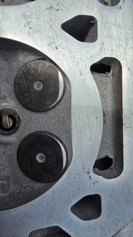

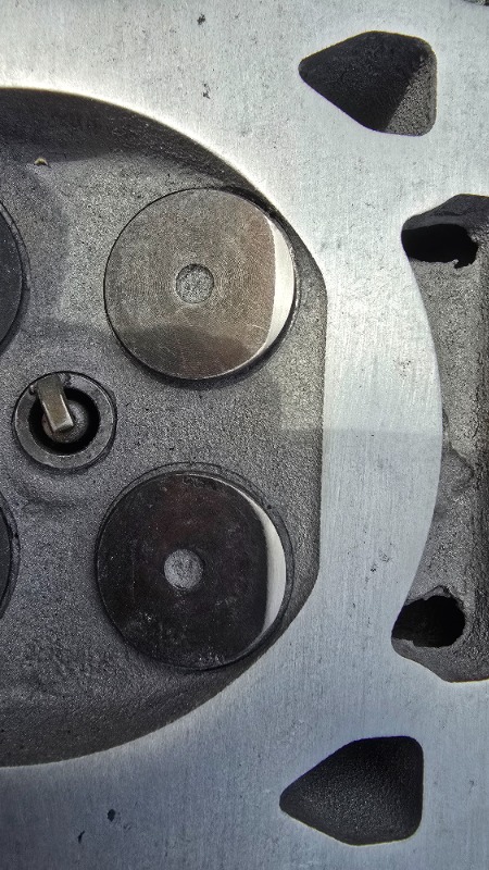

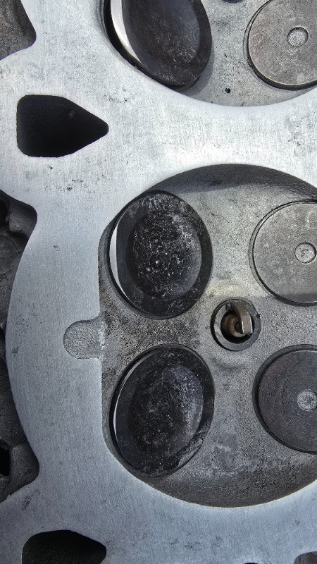

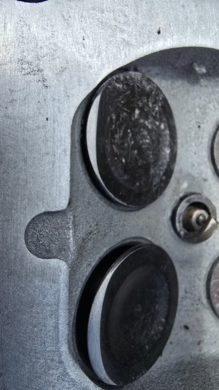

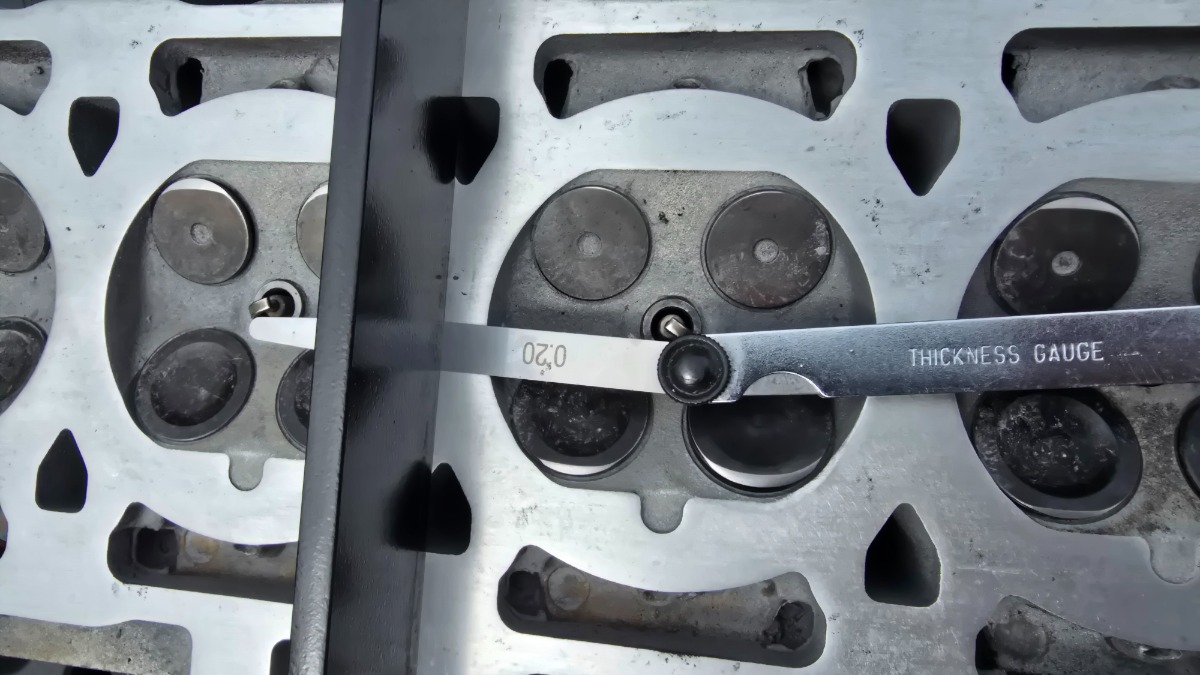

Another small update, and another case of "1 step forward, 2 backwards": The reconditioned head from mgfntfbitz arrived today, earlier than expected, but unfortunately whoever did the reconditioning seems to have made a mess of it:
They appear to  have they skimmed it with valves in place so as a result any valves in open position ended up getting ground on edges

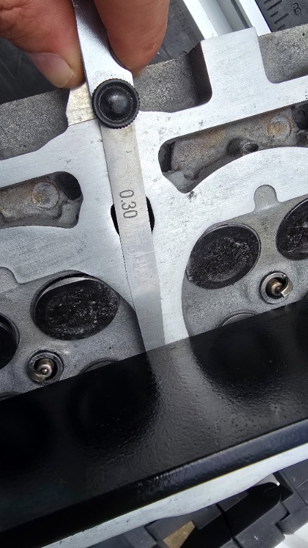

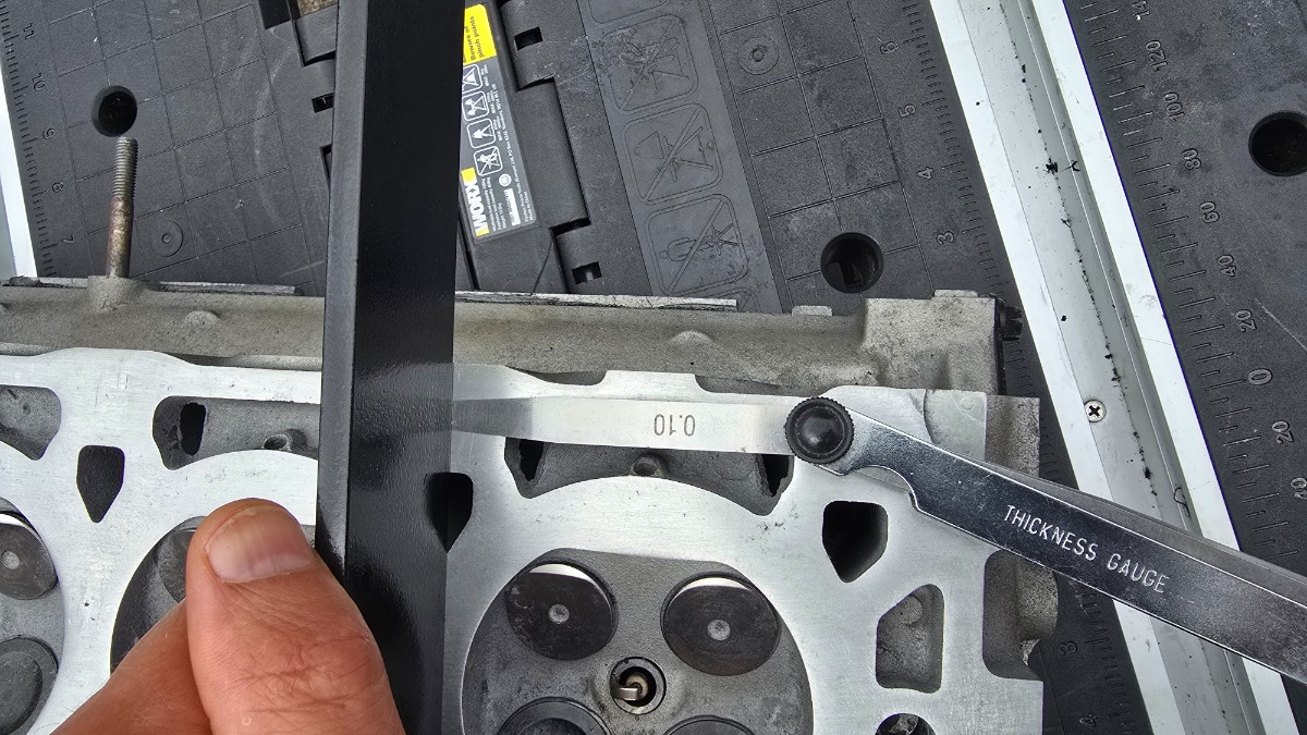

To add to the misery, not sure what they used to skim the head, but it's certainly not even, with the biggest issue being between cylinders 2-3 where they seem to have created a bowed profile and I was able to squeeze anywhere from 0.15 to 0.35mm feeler gauge under a straight edge in places.
I got in touch with them and supposed to hear back tomorrow morning from their technical guy to talk through it, but definitely not impressed with the shoddy work. Not happy to use the head in it's current shape, and this being the only reconditioned 120 head they head in stock, the best I can hope for is money back and the need to source another head which means another delay..

Replied by Cobber on topic Hello from Dorking!
Posted 11 months 4 weeks ago #217217
Well whoever ground the head was an idiot of the first order!
By the look of it the valves might have been open when they ground it, so the cams must have still been in, still it would've been prudent to remove the valves before grinding, then washing the  bare head clean afterwards to get rid if all the grit and swarf before reassembling the head and lapping he valves in before sale and fitment.
As it is, even if they didn't damage the valves the head would have grinding git and swarf all though it!
Replied by TA22GT on topic Hello from Dorking!
Posted 11 months 4 weeks ago #217218
Not good.
That gap under the straight edge is way too much..gaskets can easily seal pitting but a warp that big is a no no.
I would get my money back.
Up here engineering firms won't skim a head tp 10 thou..only 20 thou minimun.
Aluminium tears when you skim it compared to steel.
I can't remember but how straight was your otiginal head?

A very poor do all round. Work like that should be undertaken by folk who are sympathetic to the job. Would I send a head to be refinished with parts still fitted? Even as a kid when I took A series heads in to Wear St Engineering for work they would be stripped & clean. Unheard of, especially from Bitz, this is the first negative comment I have seen.
