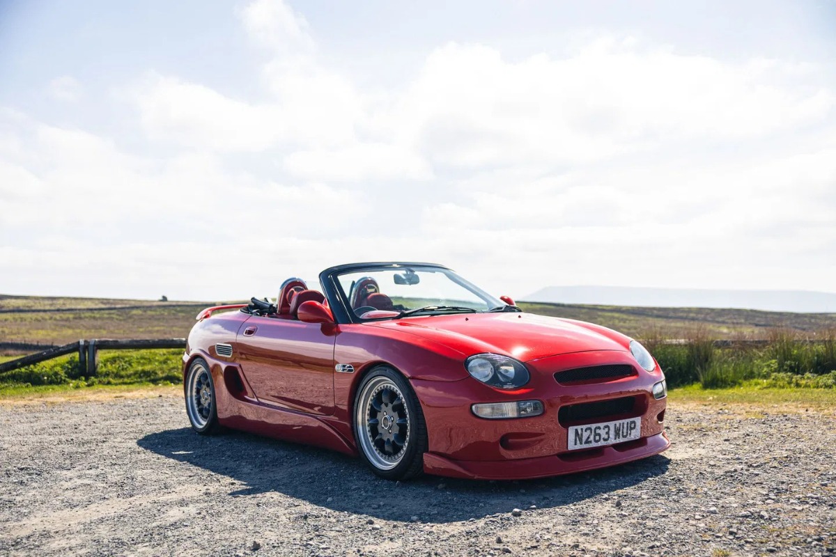

Hi everyone,Just joined the forum and wanted to say a quick hello! I'm Martin Szczypka, based in Dorking, Surrey. I’ve recently become the proud owner of a very unique MGF some of you might have seen on the  PistonHeads auction block .. Even though I had never considered the MGF/TF as an option for my "midlife-crisis-toy", the moment I saw this heavily modified "Cheetah" I was hooked! I'm looking forward to learning more about the car, sharing experiences, and hopefully contributing to the community.
While I am very happy with my purchase and it had genuinely been well looked after, those hardened MGF owners will accurately predict the litany of gremlings the Cheetah came with... Just under 3 weeks since I picked up the car I am already having to embark on an engine drop to deal with (you guessed it!) persistent overheating issues now all pointing to a headgasket failure, do cambelt replacement and a whole host of smaller jobs. I'm a competent DIYer when it comes to servicing and basic repairs, but have never embarked on such extensive engine work so forum member's support will be highly welcome!!!!Looking forward to chatting with you all and getting stuck in!Cheers,

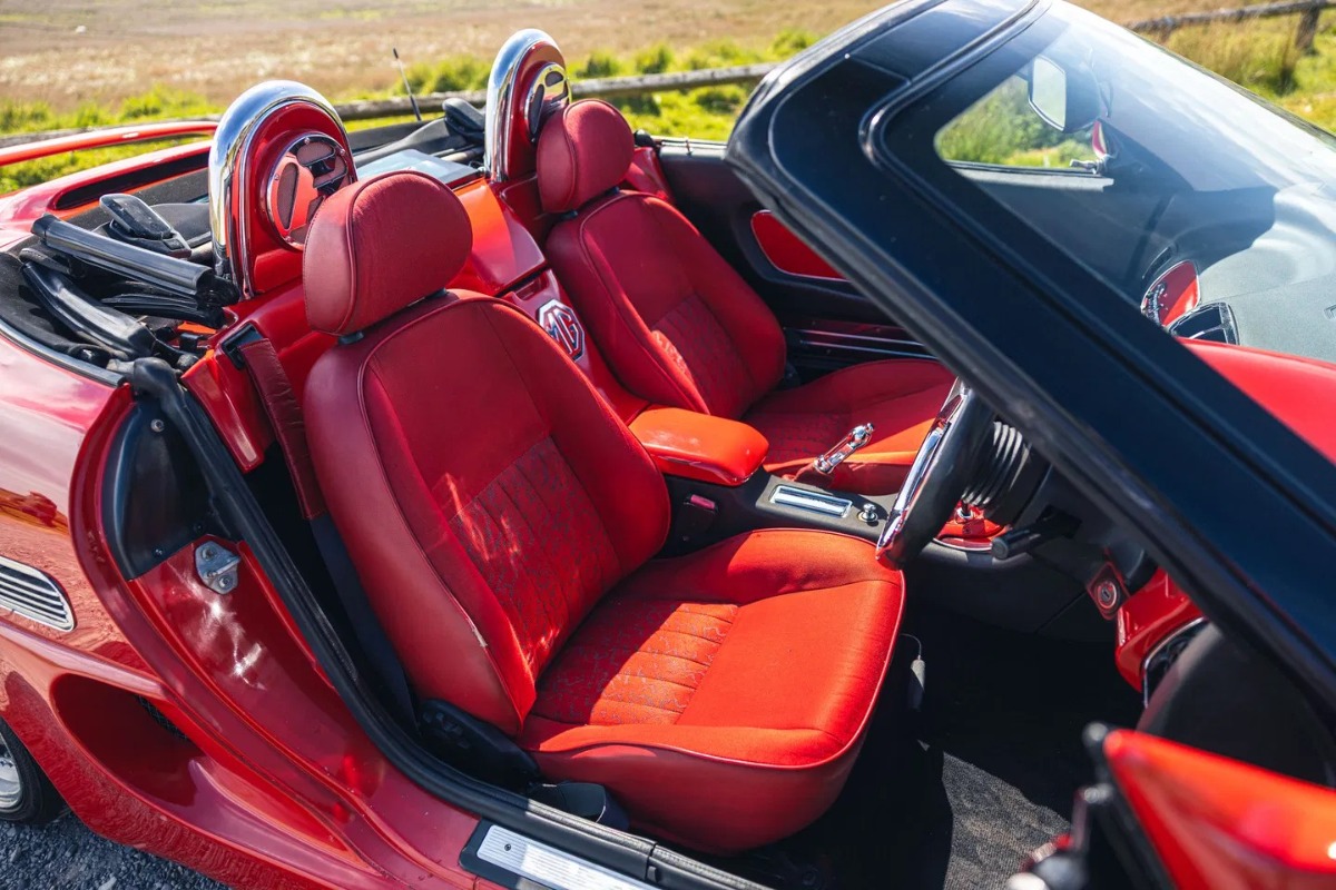

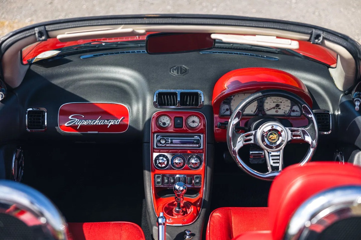

It certainly is veeeeerrrry red - the internal kit the original owner installed is certainly an acquired taste..... I plan doing a bit of an interrior refresh, tone down the bright red plastic look and try my hand at wrapping elements in PU type "leather". Well, at least once I can get it working reliably first!

Welcome. That looks a very interesting and unusual Mk2 MGF. Its quite rare to see one with a bodykit these days let alone the amount of detailed extras someone has lavished on this.
Out of interest what's the history of the Cheetah. Was it one of a special run produced by a specialist MG Rover dealer at the time or a previous owner's one off vision ?
It would be great to know how the supercharger is fitted and and if the engine is a 118mpi or a143/ 160 VVC ?

There can’t be more than a handful of Cheetah s on the roads these days. Glen Turner has one & that’s it to my knowledge, not that I make a habit of tracking them. This might be different.
What year does it purport to be, there are contradictions; Mk1 Speedo & windscreen surround, yet Mk2 gear stick surround & console switches.
The air intake on the boot lid is interesting as are the side vents on the rear quarter.
More pictures please, especially of those areas which step outside the norm, such as the engine & the Gofasterspinnything & pipe work.

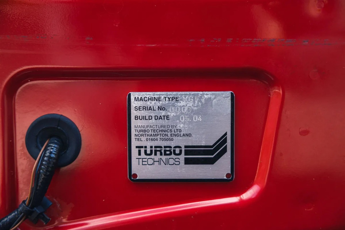

Is it really a "Cheetah"? That is a good question, but based on the fact that it has the genuine Turbo Technics build plate (Serial no: 0008, built April 2004) I believe it qualifies as one. My understanding of the Cheetah story was that it was always meant to be a "pick n' choose" package; this one certainly has most of the options list ticked off, key one being the full supercharger kit with the extra injectors, custom intake manifold, etc. (the base engine is the 1.8 Mpi rather than the VVC). It also has the sports hydragas adjustable dampers, 17" wheels, sports exhaust and I believe uprated brakes (yet to confirm). I expect a lot of the styling mods probably come from the Cheetah list, but the kit is definitely more extensive (and better looking in my opinion) than what the Cheetah looked like when test driven by the georgeous Vicki Butler-Henderson on the old Top Gear.

Thanks! As per my response just above, there are a lot of discrepancies here look-wise with what the Cheetah package appeared based on the scarce internet materials I could dig - I think this is where the original owner went full out purchasing whatever shiny piece of body kit he could get hold off, ehich must have been tricky in Guernsey.. On the other hand, the "Gofasterspinnything" (love that!) install looks to be very professionally done, with Turbo Technics logos embosed on multiple elements, most prominently on the inlet box, the fancy ECU and the injectors are also present.
The base car was one of the very first MK1s, built in 1995 with a serial number ending in 300, so probably 50th or so car of the production line! The TT built plate indicates the Cheetah conversion was done in April 2004, so car would have been 9 years by the time it was done. Despite being 30 years old, the car is unbelievably well preserved - even surface rust is limited, especially comparing to some of the how-to pics taken from much newer cars.
