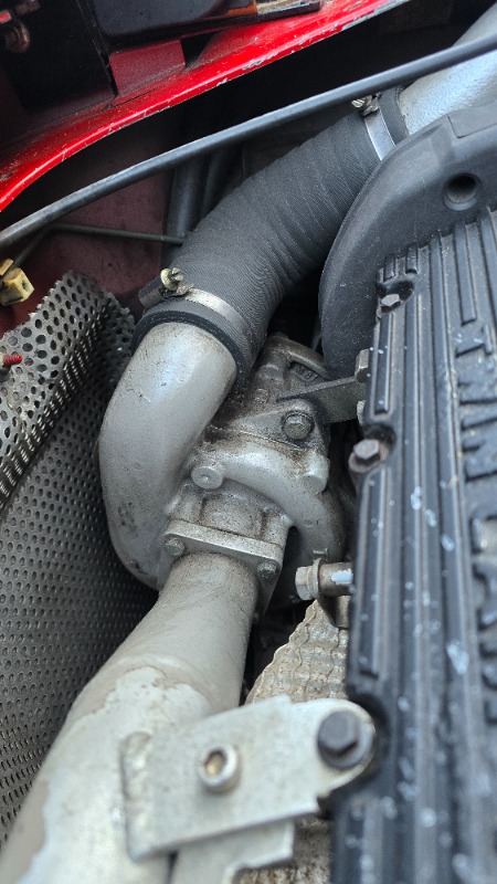

Replied by Notanumber on topic Hello from Dorking!
Posted 1 year 3 weeks ago #216504
When you have the engine cover removed check you don't have the same rare blockage that mine had. Remove both hoses from the coolant outlet metal housing at the front of the engine ( the bit that also has the temperature sensor) With a suitable picking tool check inside the metal spiggot for the half inch hose to look for a build up of crud. Although this outlet is for a bypass hose it messes up the whole coolant circulation and becomes a real problem only once the engine gets up to normal temperature. In short it goes to an overheat condition shortly after the point the thermostat should open. A careful look will show it actually creates a vacuum in the front radiator hoses at this point.
Another odd symptoms is that it won't show exhaust gasses present in the coolant resevoir (making you think the head gasket must be fine). The reason for this is that this fault isolates the coolant resevoir until the system is overheating hence there's nothing to test.

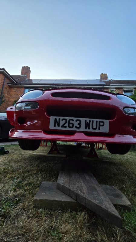

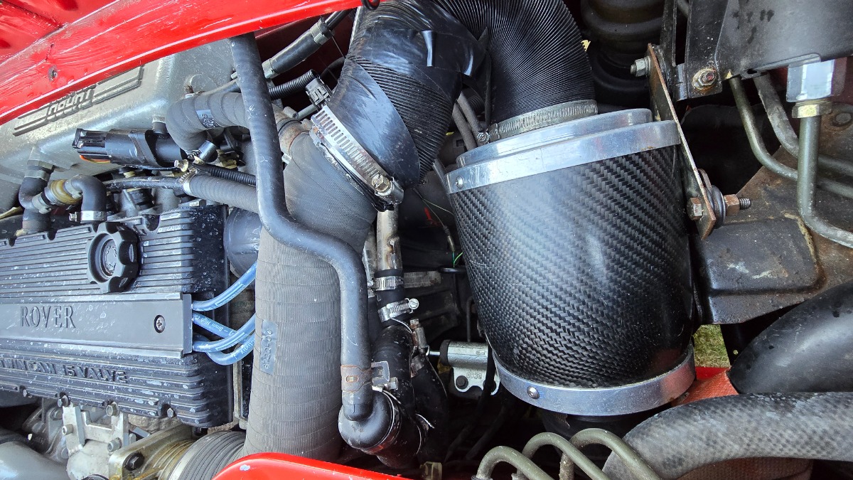

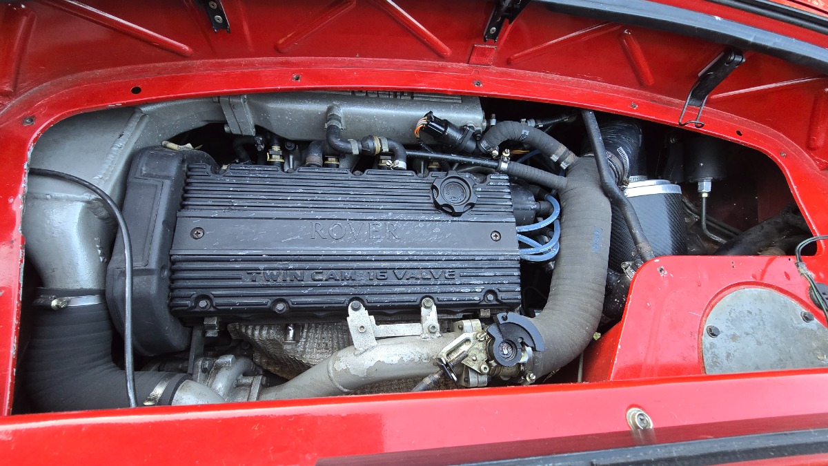

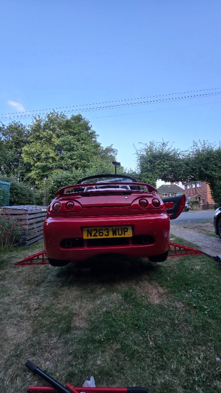

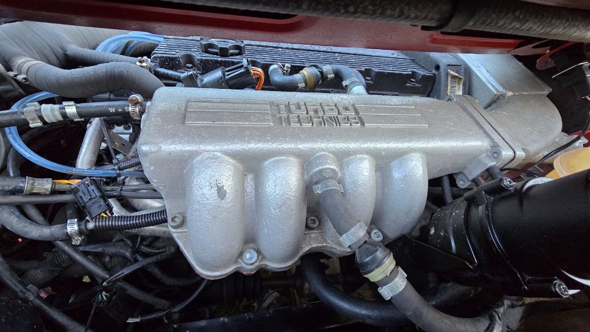

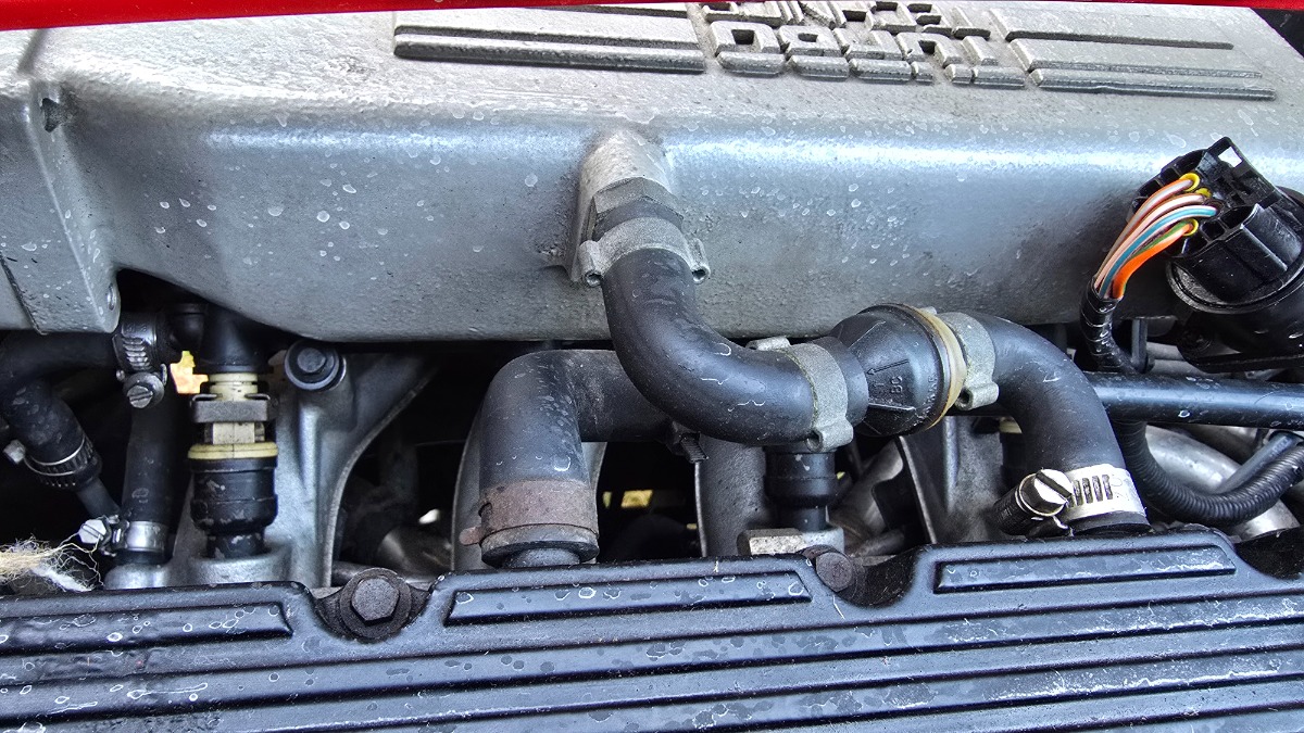

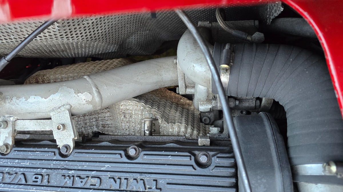

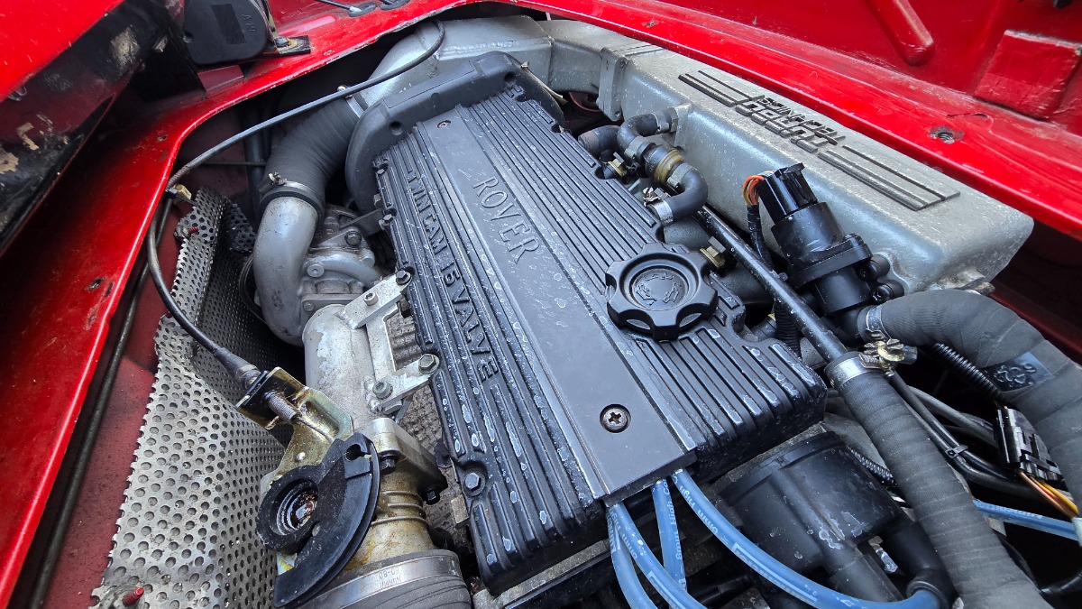

Replied by MartianSkippy on topic Hello from Dorking!
Posted 1 year 2 weeks ago #216508
More pictures please, especially of those areas which step outside the norm, such as the engine & the Gofasterspinnything & pipe work.
Here's a couple of  pictures of the TT kit through the engine opening before I start disassembly. And the car is now o  stilts, prepped for coolant system check and engine drop later..
Last Edit:1 year 2 weeks ago by MartianSkippy

Replied by Airportable on topic Hello from Dorking!
Posted 1 year 2 weeks ago #216509
That’s quite the master class in the repackaging of something that’s already tucked snuggly into a “just enough space to begin with” space.
