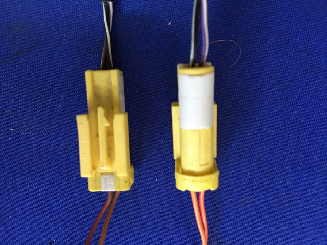

Replied by Airportable on topic SRS Light!
Posted 1 month 2 weeks ago #223619
A couple of things on this. If you have the red SRS connector, change it for the later Rover yellow connector. These are a great improvement & have the advantage of a shorting link, this operates when there is a disconnect. A visit to a scrappy with a stock of 25s 45s or 75s, will turn up the goods.
I would add a picture, however I can’t get this to work.
The second comment is on the SRS controller. I have some of these, both singles & dual. If you are having a problem & wish to substitute another, rather than buy one of eBay, give me a shout & we might be able to arrange something.
I am also looks for a SRS loom (yellow) to allow the testing of these items. Again if you can help give me a shout.
PS I’m trying an alternative way of posting a picture, let see if this works.
Last Edit:1 month 2 weeks ago by Airportable
Last edit: 1 month 2 weeks ago by Roverlike. Reason: Picture added
