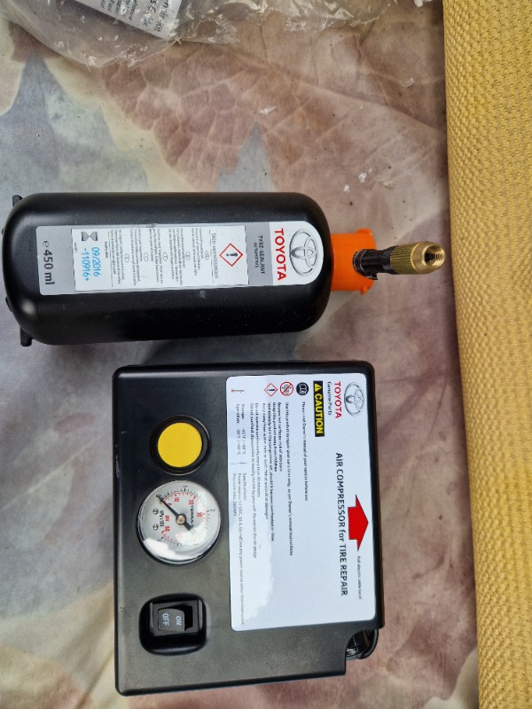

When my wife bought her Yaris it came with no spare but a can of inflatable soup and a mini compressor. Jeez Toyota!!
I was livid. How could she use that at the side of the road on her own?!
I bought a full size spare steel wheel and tyre from a company that realises their is a market for supplying such items.
Although she knows how to do it if she got stuck she could likely get assistance if needed. It's peace of mind.

My temporary solution at 6 am this morning is to remove the useless spare and use the Toyota gloup kit. I have a new Falken tyre that now sits where the spare wheel once did.
My reasoning is that the gloup may get me to a country garage and I can get them to fit my tyre! The chances of anyone having a 15 inch tyre anywhere near the right profile are slim.
It's the best I can do right now.

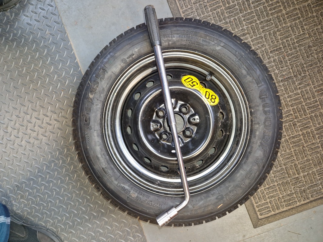

PS I had one of those handle extending devices shown in your images. The socket went on the nuts of 3 wheels but not the 4th. The factory job was the same. I tried a different socket from a similar tool and that went on to all the wheel nuts. So that one is in the car’s pack.
Whilst the extra length is all but essential the design does make supporting the business end whilst applying torque essential. The old fashioned multi arm spider is the best in my opinion and the closest to that I can think off is a standard “Tommy-Bar” socket set item, a 5” extension and two short pipe sections to add extra length to the Tommy-Bar. But I’ll live with the device shown in the image.
